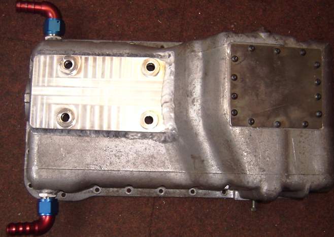

    Thanks for the quick reply Graham, my returns look like this with a proper boss tigged onto each side of the sump and push on type fittings.
    Where do I buy/pinch those drain fittings for the turbos?
      • 25261
      flash git
      as for where to get them ............ebay?
      i've bought several via ebay for pennys,
      another time i paid £10 for brand new BDT one which came from GGR

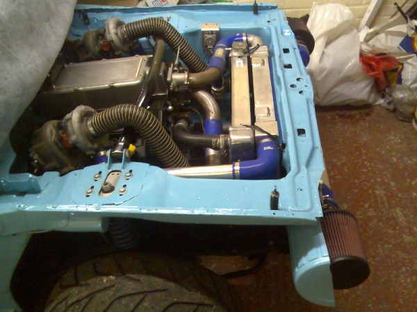

                  Thats the plan atm, just getting as much of the engine done as poss and once Andy's back we can get all the wiring loom for the engine in there.
                    Look no tie wraps

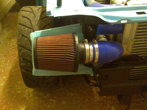

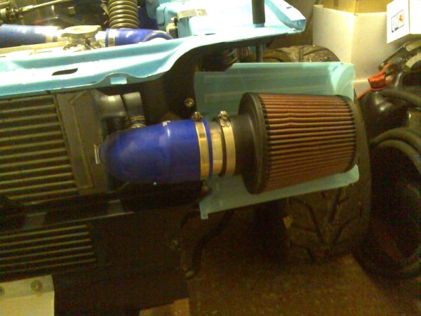

                    The airfilters are all mounted now and I've fitted some nice colour coded shields to stop some of the crap getting in them off of the tyres
                    Could have fitted my new actuators too but I have the wrong brackets for them, I think mine must be cossie and I need rs turbo ones, or vice versa I need the very offset ones and not the central mounting ones like I have

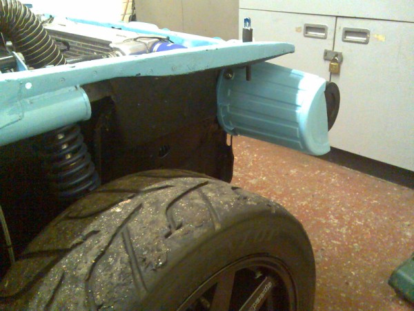

                      Thats one of those plastic mini dustbins cut in half isnt it
                      Good idea
                        Good idea
                        Why fabricate something that tesco sell for a couple of quid
                        If its not strong enough I'll just get one for a fiver
