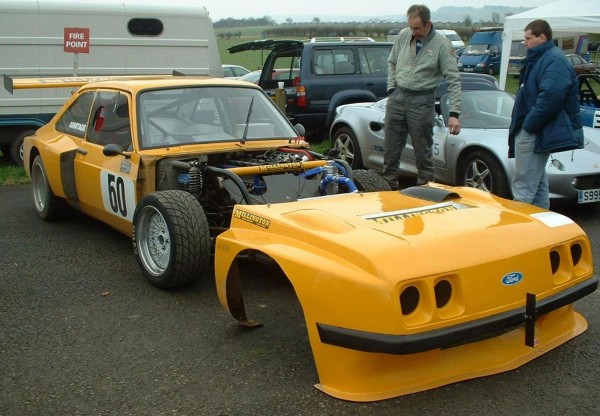

    Dave, Have you thought anymore about spaceframing the front end?
    Like this you mean;
    It would be nice, and not that difficult either (for Gary ) but I've gotta be careful of the regs in the championship. If they ban spaceframes then I'm screwed so by keeping the inner wings it is still essentially a monocoque escort shell.

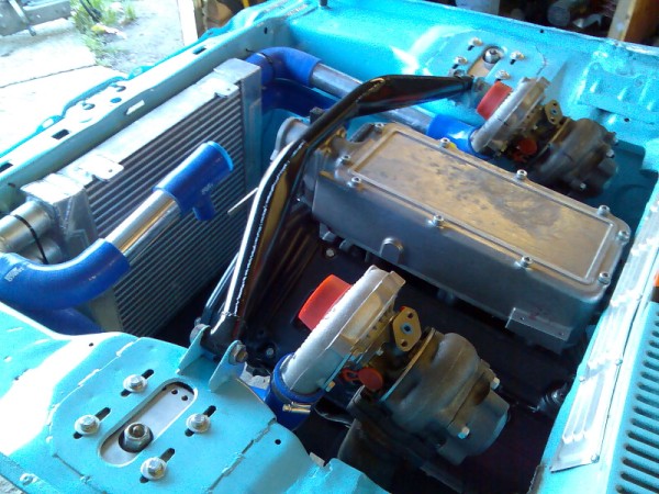

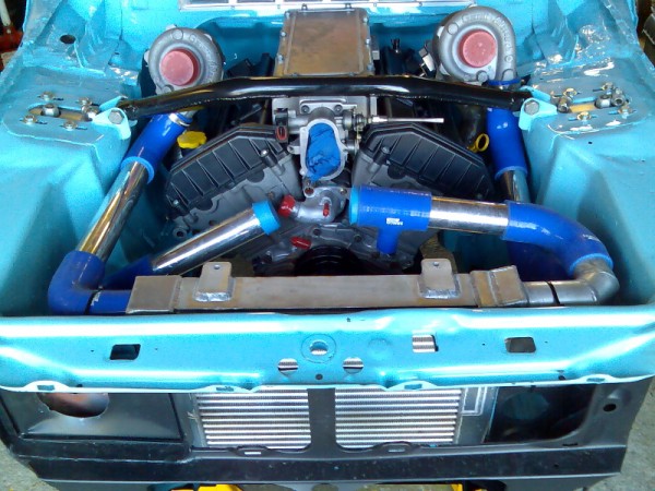

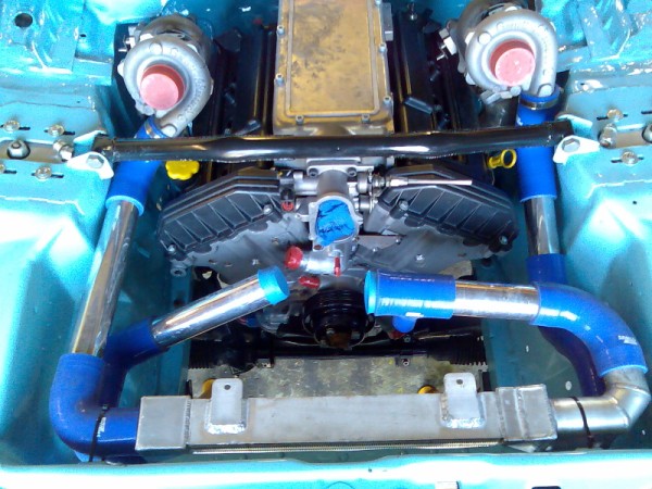

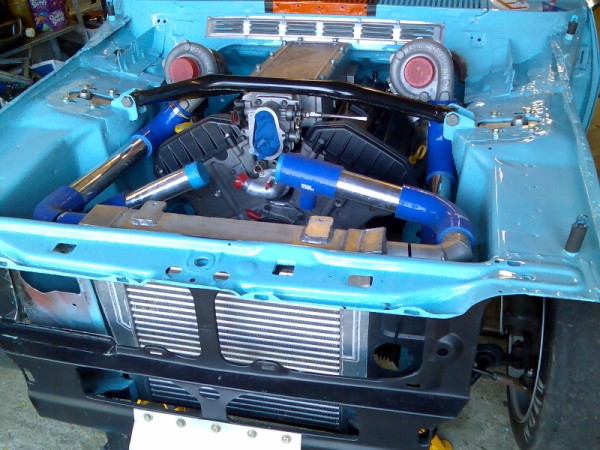

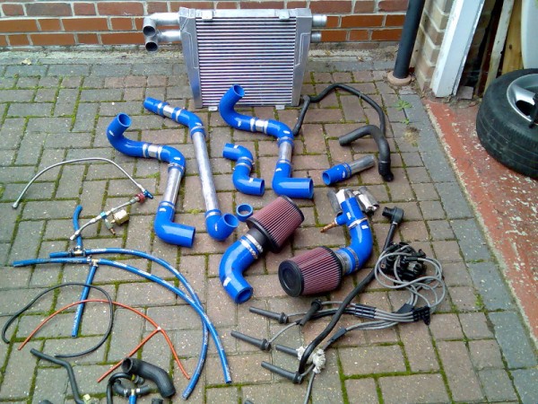

                          Got a nice bag of goodies for the car the other day including this beautiful intercooler and loads of samcos off of a mate whos breaking a twin turbo sierra xr4x4;
                          We cut out the origional radiator surround to get the intercooler sat in and after a bit of a play with the pipes its all plumbed in bar the second dump valve t-piece and an adapter to do on the throttle body
                            #88

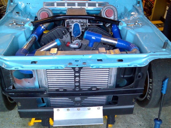

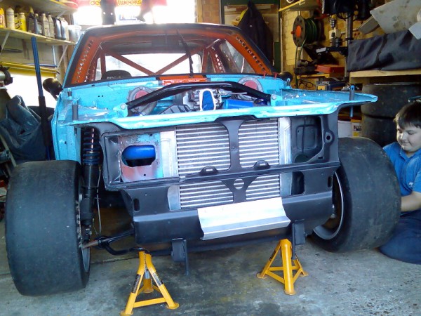

                            We cut out the air intake that was used on the zetec install and I tidied up the front panel. Just need to make some ally blanking plates to go either side of the cooler
                            Oh and finally couldn't resist making a few extra holes just to give as much airflow to the cooler as possible
                            All in all not a bad days work methinks Cheers to the Andy and Alex for their assistance
                                Can i just make it perfectly clear, that he was playing with the samco pipes and not me and Alex
