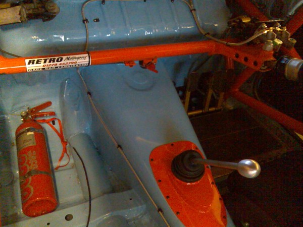

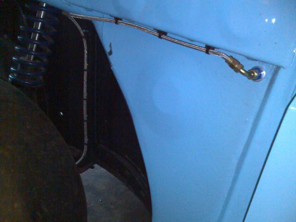

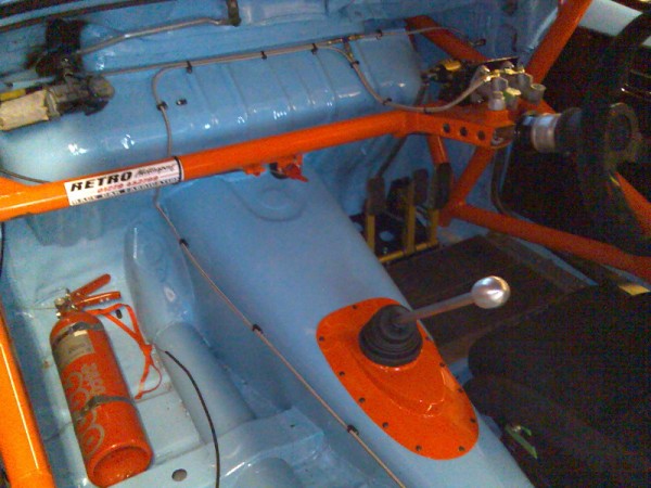

                    Plumbed in the brakes today all bar the reservoirs, well Mr Pipe did anyway
                    All done in nice braided hose with bulkhead fittings from Speedflow and Rally design, and held in place by neat cable tie holders so that any lengths of it can be moved without bleeding the system or drilling rivets out
                    Front brake line to inner wing bulkhead fitting;
                    Inside lines all neatly run;
                    Also fire extinguisher refitted on riv-nuts in footwell;
                    Next; plumb in extinguisher tomorrow
