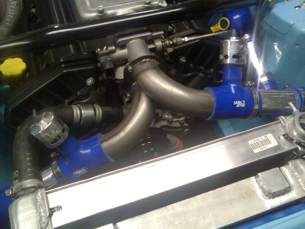

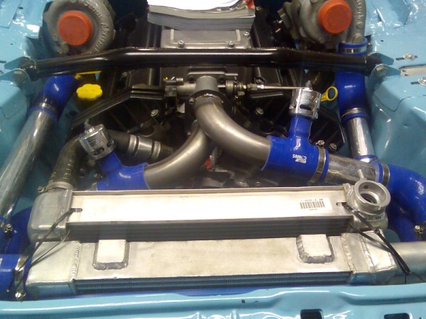

        Made up the inlets for the throttle body today
        Not bad really considering it only cost me £13.50 and a pint of scrumpy (£13.50 for the 2 90 deg bends and the scrumpy for Gary to weld the pipes to the back plate I'd made )
        I also spent a while porting the throttle body into the pipes to give a nice smooth flow.
        Just need to smooth the welds a bit and give it all a coat of silver paint and job jobbed;
        Will point the dump valves down now to give more room, just wanted them on show for a bit first

            Cheers mate, might have to get you to come and have a look at it one day to make sure that we plumb and wire it all in correctly. All this turbo business is new to us
