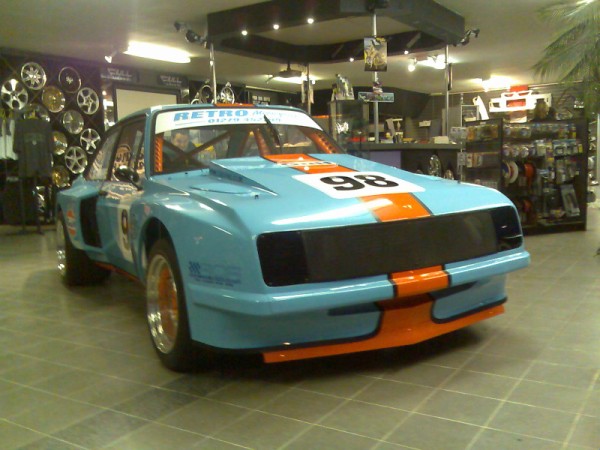

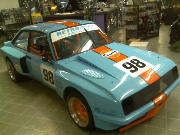

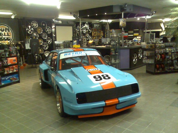

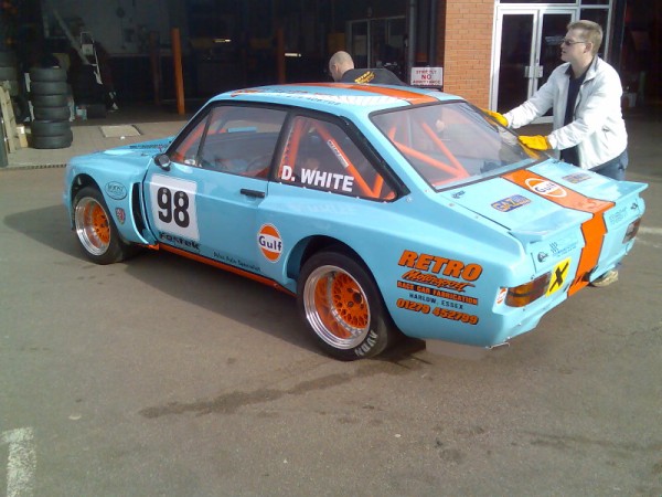

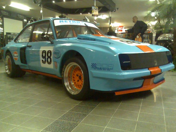

    Got my home internet back online (thank you BT, up yours virgin and tiscalli) so heres a few of the pics I took on my phone while the car was at Fuel's showroom in Harlow

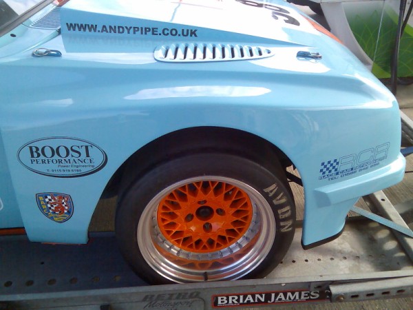

      The Retromotorsport on the rear quarters and screen, and the image worx on the roof came out really nice.

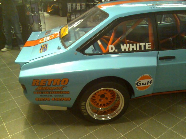

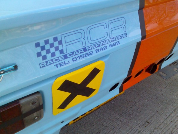

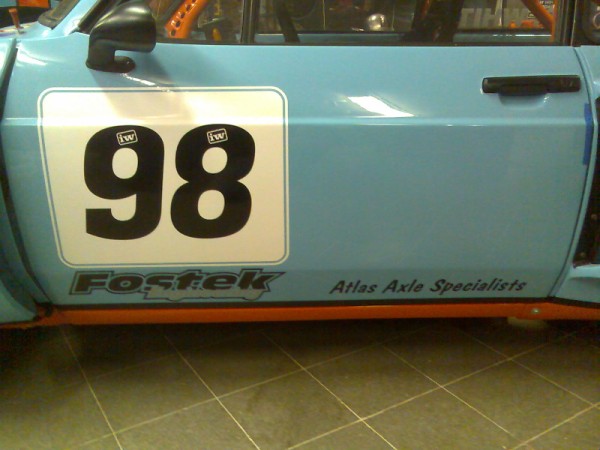

      Heres a couple of my other kind sponsors' logos designed by Sticky Matt;
      Boost performance, my engine builder;
      RCR race car refinishers (aka scuffs-n-stuff)
      Fossie, who will be supplying an atlas setup very soon
      There are also BARC, turbosport and the dreaded novice cross decals, cheers again to Matt, top work

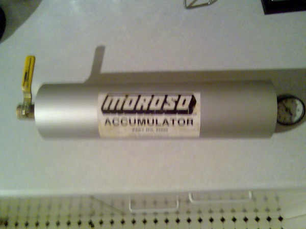

        The accusump, vital as I cant fit a dry sump at the moment

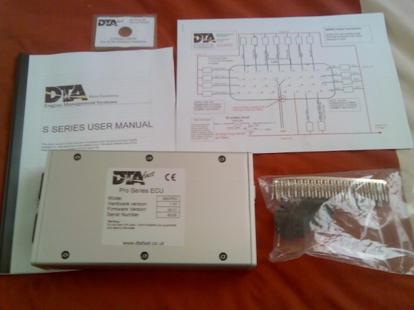

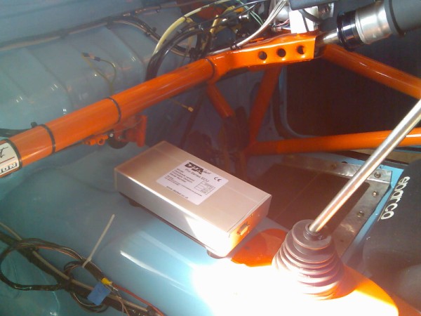

        and my shiny new DTA S80 pro ecu which I'm fitting ready for Andy to wire in once his car is finished and racing

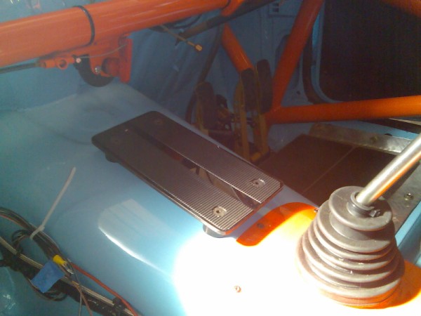

                  Made this mount the other day to fit the ecu onto. It's perspex with countersunk rubber bobbins to stop any heat or vibration from the tunnel. The ecu attaches to it with h/d velcro and trust me it aint gonna fall off in a hurry, that stuff STICKS
                  Ecu ready to be wired in to the loom. The comms lead plugs in on the front of it making it nice and easy to use when mapping

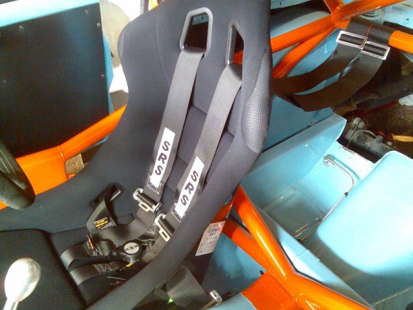

                  Also got my new 6 point harness from Claire at PLR yesterday.

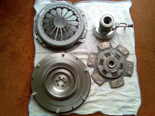

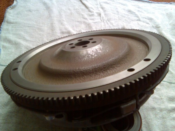

                      Got my flywheel back all reground, lightened and balanced;
                      Also got a 6 paddle AP racing clutch and a new cover, oh and a shiny T5 concentric clutch kit;

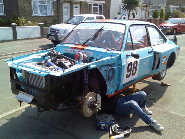

                              Got a bit done today at the Pipes, more pics to follow.
                              Fitted my new flywheel, clutch and modified the T5 to fit the concentric release bearing.
                              Only trouble is I have a unique combination of gearbox, bellhousing, engine and clutch system so all went swimmingly until we found that the bearing didn't have enough throw (or any) to move the clutch
                              A quick trip to Burtons got us no further as spacers are not made for this concentric, so next stop was Gary at Retro.
                              In no time he looked at the problem, went to the lathe and a short time later we had a perfectly machined spacer that slots btweeen the concentric and the alloy adapter on the box. Cheers Gary
                              At least we had nice weather and it was good to see how easy the box comes in and out with 2 people working under there
