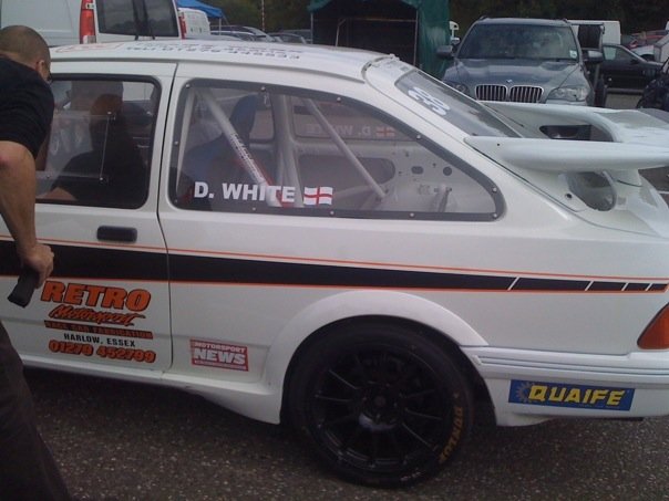

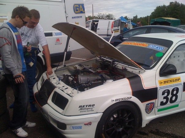

                        #551
                        Just some pics from one of the lad's phones. Should be some good action shots from Snappy racers in a day or two hopefully
