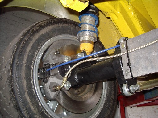

            XEP did have stiffer suspension when it was built. It had coilovers at the back.
            The car was taken to Escort Guru Mark Solloway who softened up the rear suspension & changed it to leaf springs. He prepares cars for the likes of Hannu Mikkola & his Escorts start at about 80 grand!!
            Anyway the stage times were quicker with the new softer set up. But I suppose it's down to driving style.
            This is a photo of XEP when it was on coilovers.......

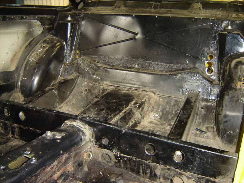

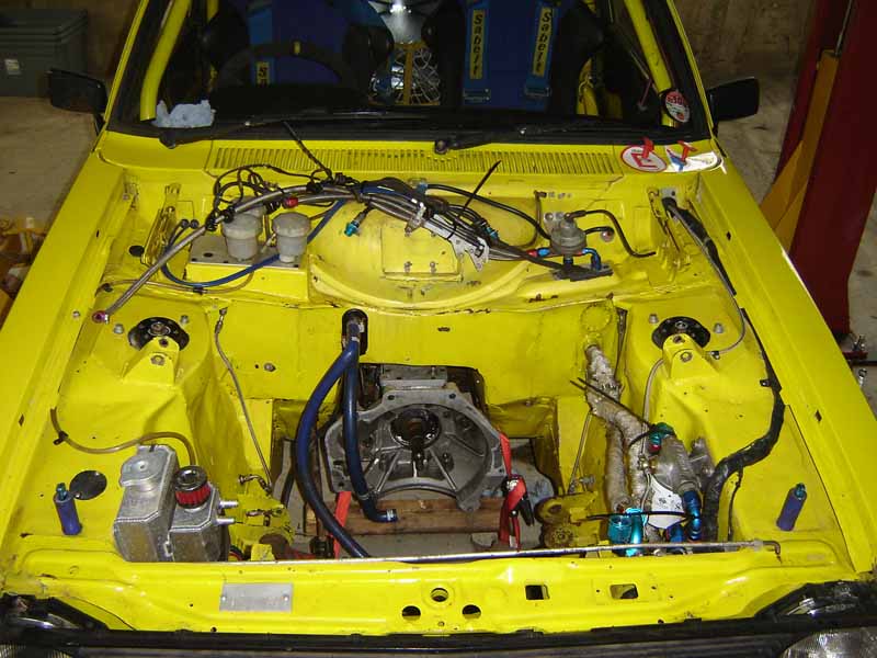

                            While the engine was out i thought i'd give the car a good clean up and where the engine has been weeping oil from the rear main it had covered the whole of the underneath in an oily mucky and crappy film, which was about an inch thick!!

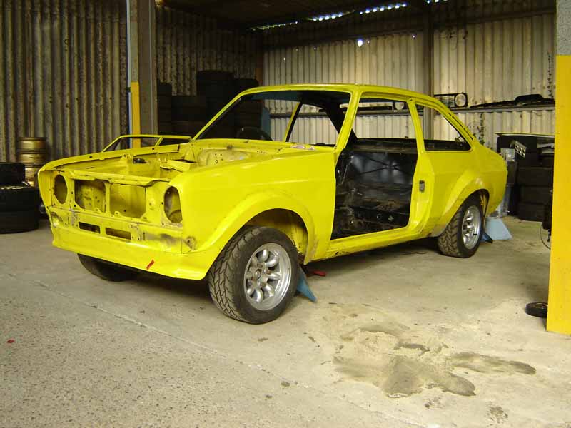

                            That was the start of it! Then for some unknow reason i started taking bits off and eventually ended up with a car like this ................................
                            and this

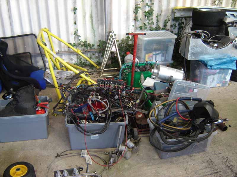

                            and boxes of bits
                            Its amazing that the whole rally car fits into about 6 boxes
