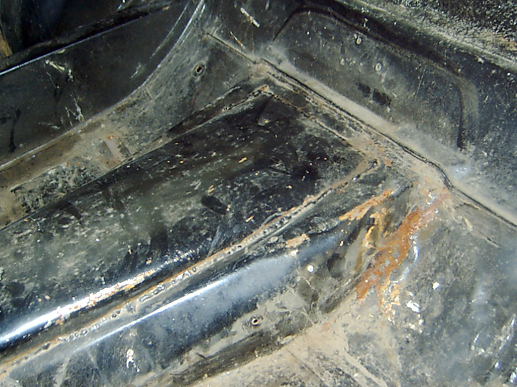

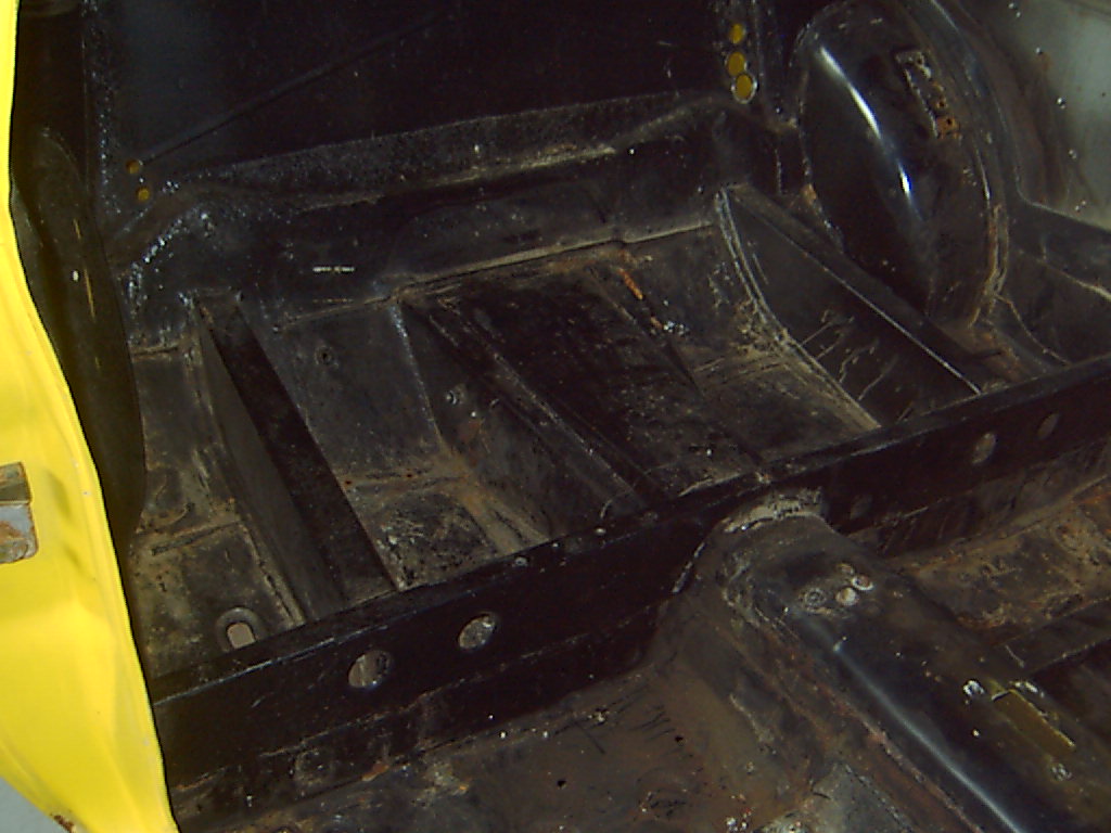

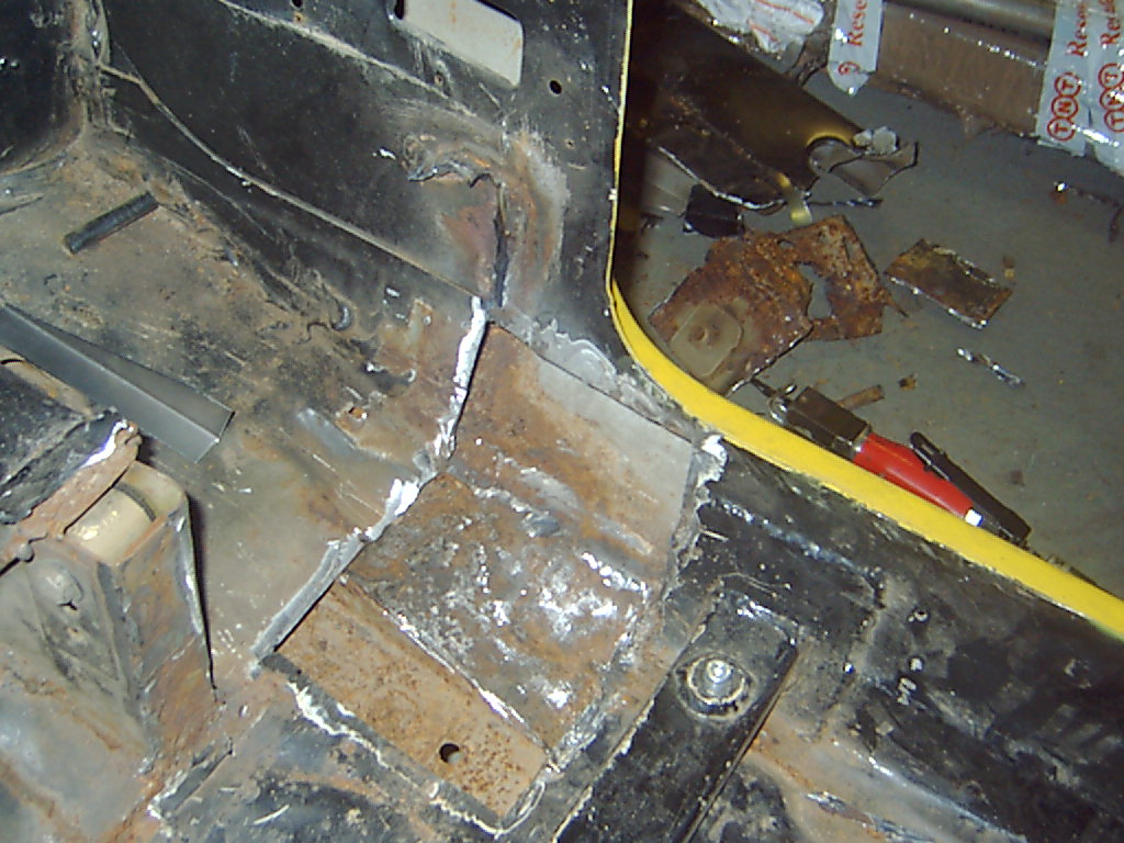

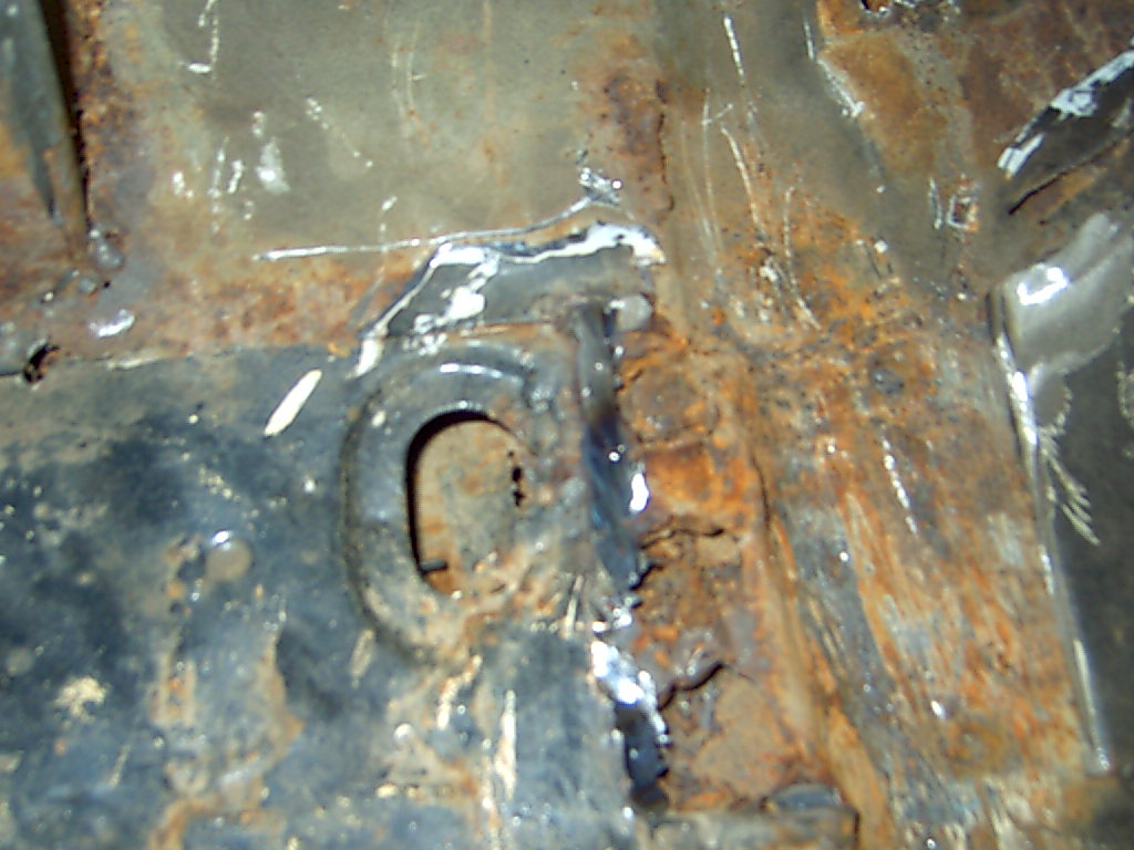

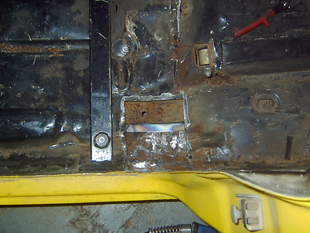

      So before Gary started prepping and cutting and grinding, it looked like this:-

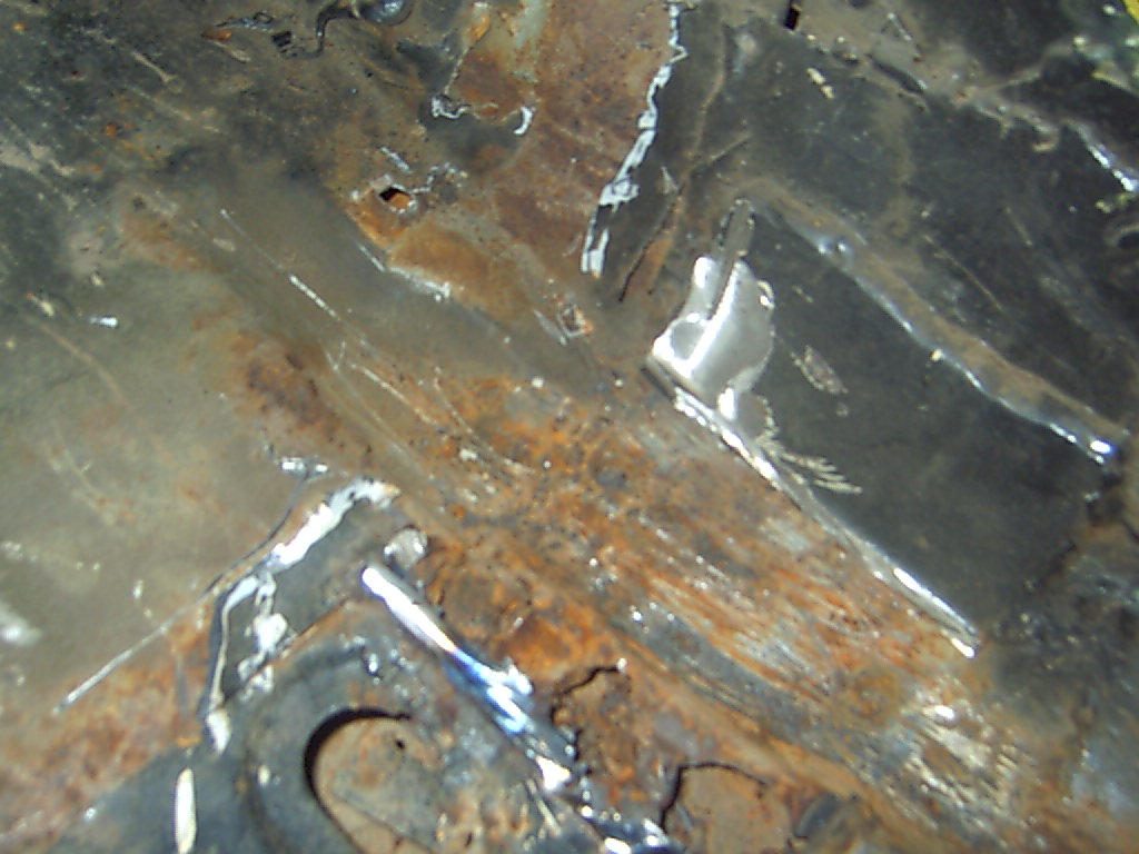

        Re: My MK2 Rally car

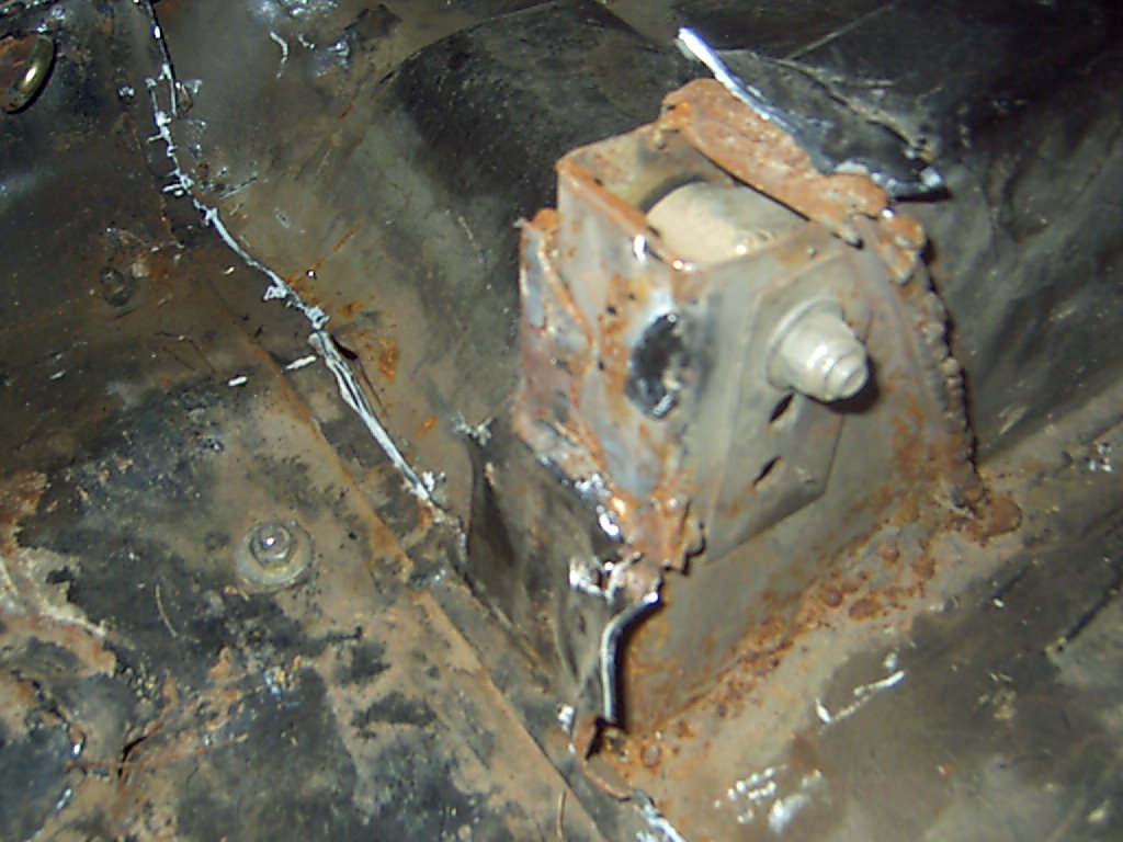

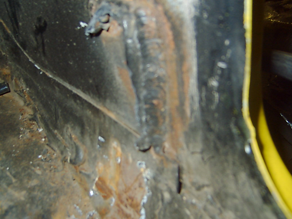

        Theres some thick old welds on there, and under the plate holes for the captive nuts.. and some rot... nothing for it really but to cut out the rot ..repair the missing chassis edge and let a new pice of floor in ..
        I tried resizing the pics but i had no luck, so sorry about that!
        In a nut shell, it had some rust, lots of weld on weld, and manky black paint.

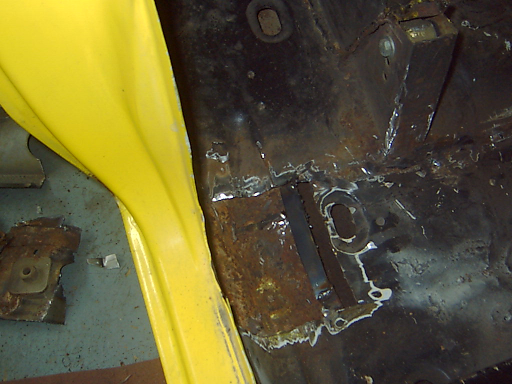

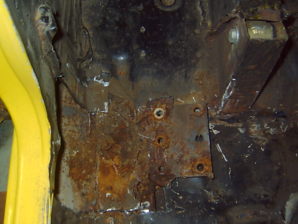

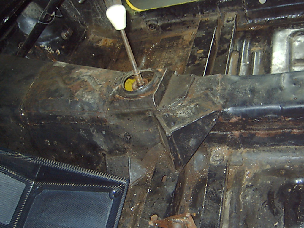

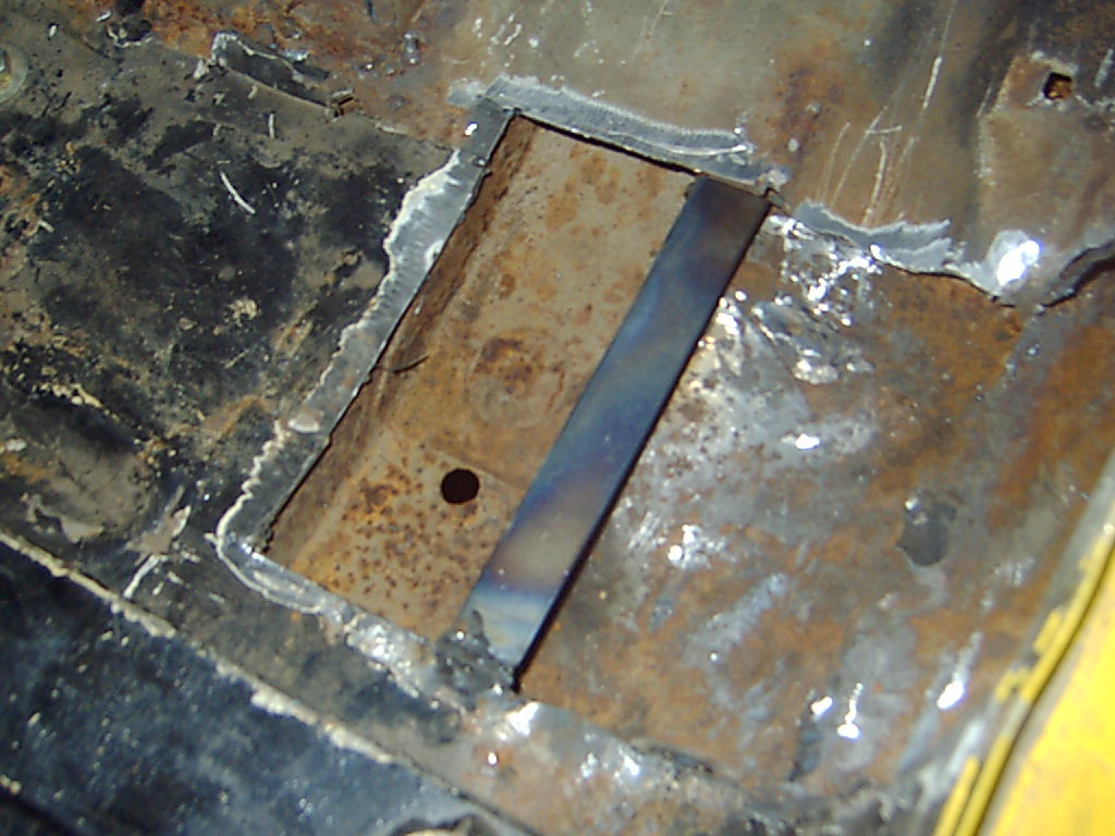

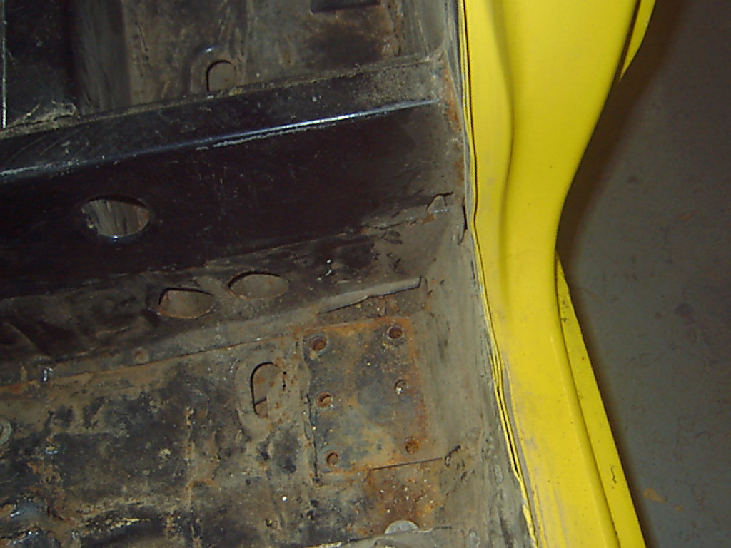

          Where the bolt in cage had been in the car, underneath the captive bolts water had sat and consequently it needed cutting out and some fresh metal welding in.

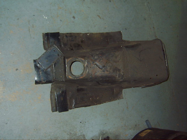

          Part of the disscussions i had with Gary was to replace the tunnels through the car. I always intended to replace the gearbox tunnel, as i think the car has has several types of boxes in its life, so it had been modified several times and had lots of plates on it.

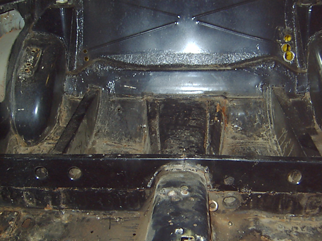

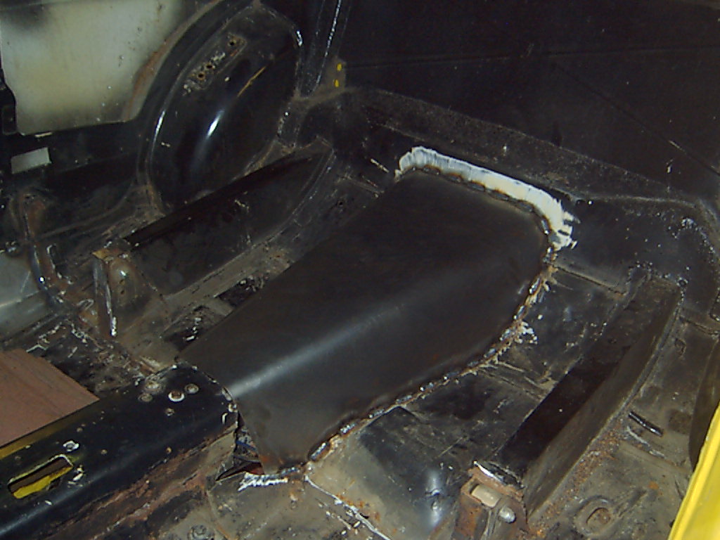

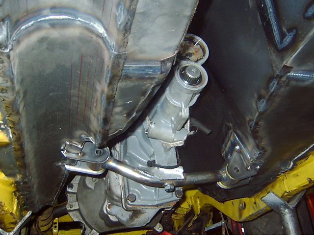

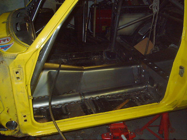

            A new diff tunnel

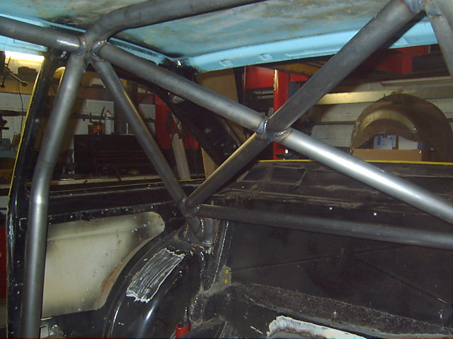

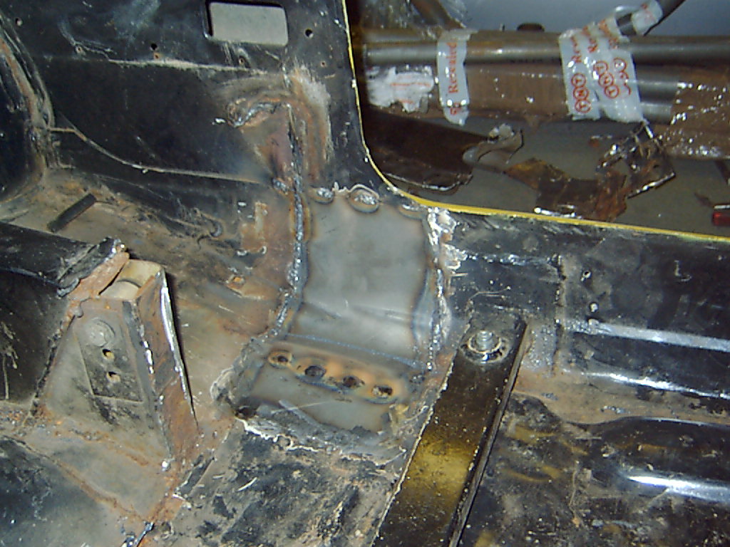

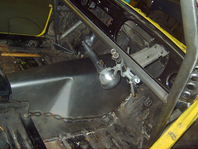

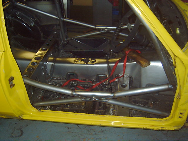

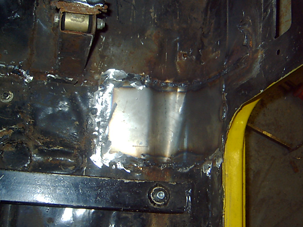

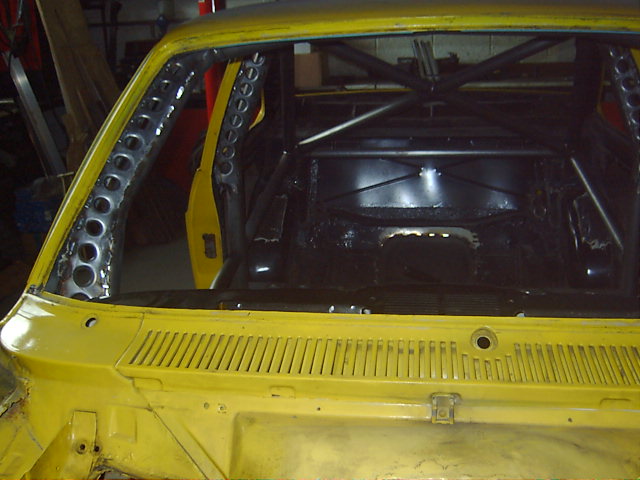

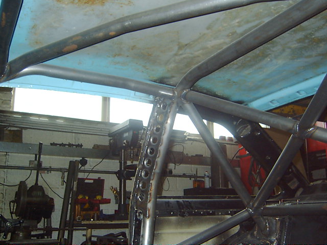

              Next up was some swages

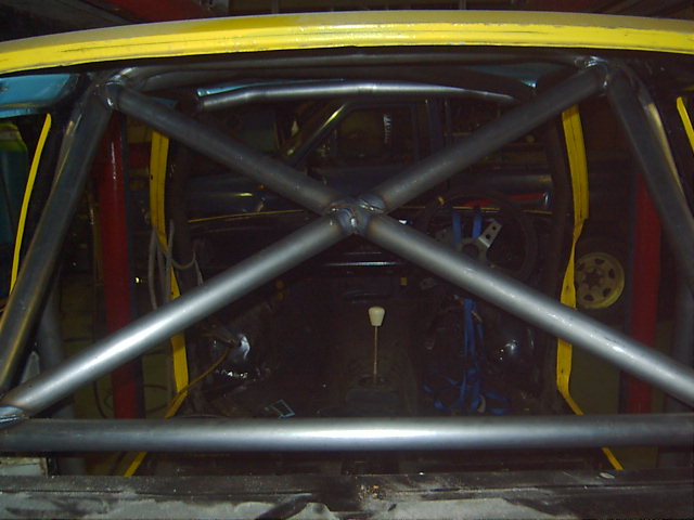

              Then the start of the cage installation

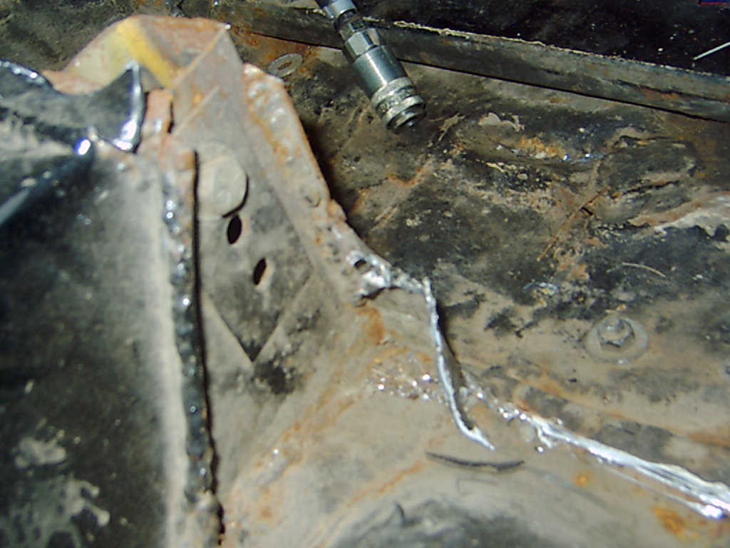

              In this pic above you can see where the old bolt in cage was fitted to the rear tub. Gary has cut out the original cage mount plate, and welded in so new fresh metal.
              Some gussets were installed next

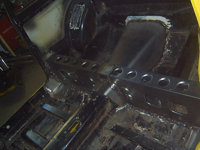

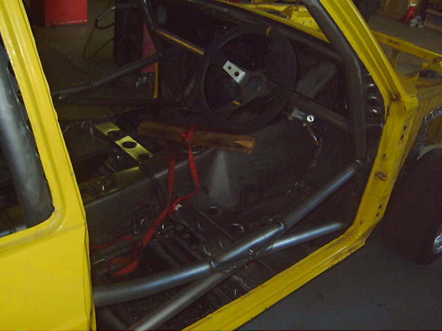

              After the rear "we" moved onto the front end of the car, the dash bar, and the gearbox tunnel.
              Out with the old
              and in with the new
              In the above picture you can make out the front cage mount feet which, for some reason i quite like
              So as "we" had replaced the diff tunnel and the gearbox tunnel, it made sense to replace the prop tunnel. Theres no point doing half a job
              I always wanted to have an exhaust tunnel as my exhaust had hit the floor pan so many times, that it was starting to rip through it.
              I think this is my favourite photo of the fabrication work that Gary has created for me.
              In the bottom left hand corner you can see a 3" ish hole which was needed so that the bars in the footwell can be welded all the way round.
              I think thats enough for tonight. Not very good with words but lets face it pictures are much better

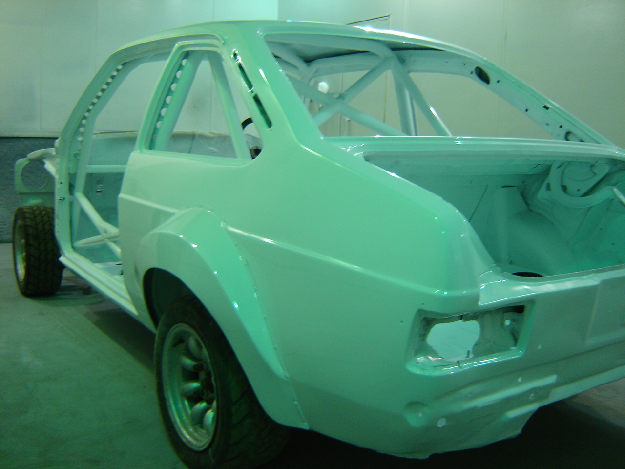

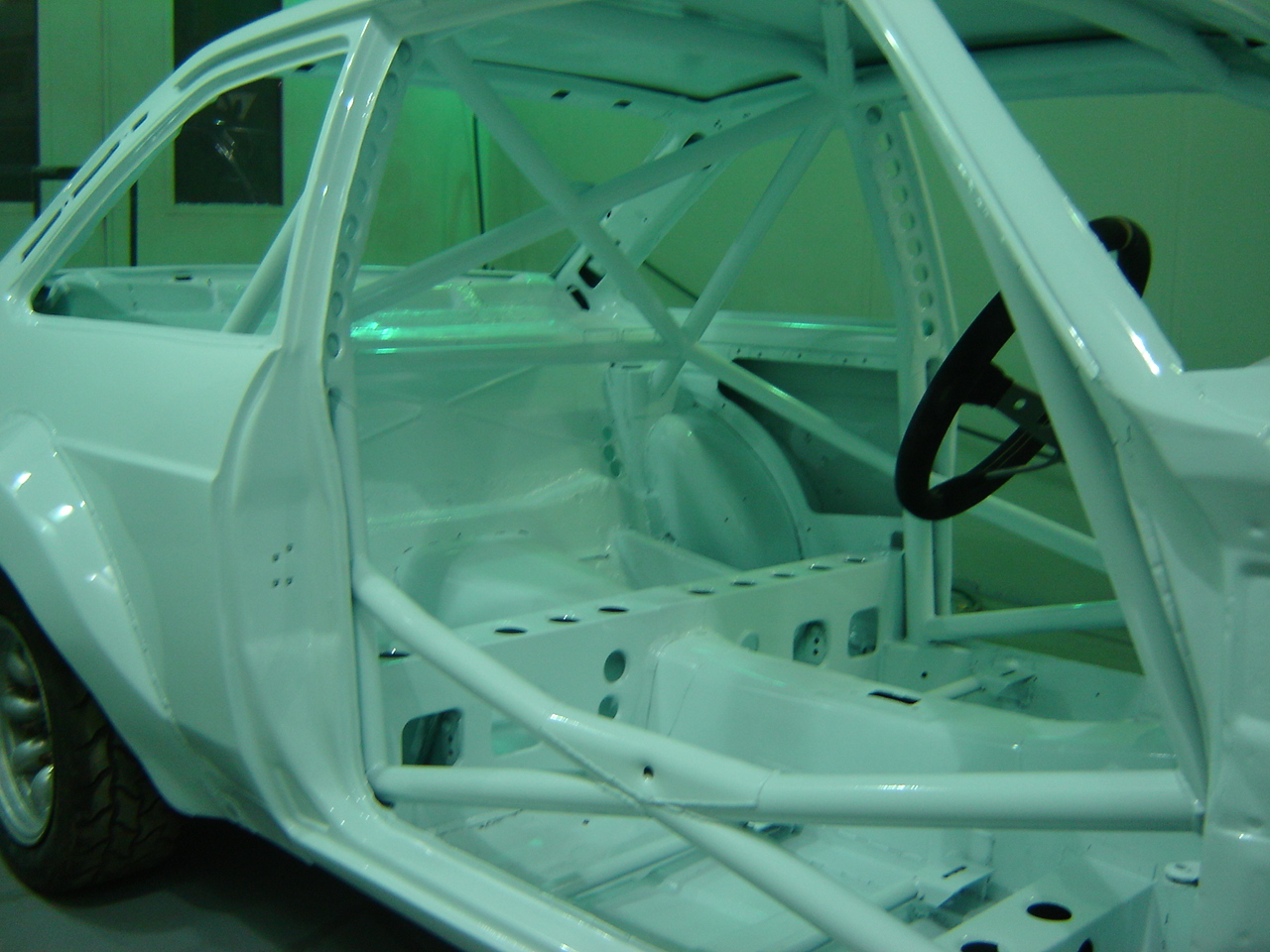

                          A few more pictures tonight of Garys expertise
                          I picked it up from Gary on ssaturday, and i managed to drop it into the paint shop on Sunday.
                          I popped in on the way home to see how it was all going, but i was too late. I've heard that the shell is in primer and tomorrow they are painting the inside
                          Any guess's on what colour though
                          Paul

                              On saturday i dropped into the body shop to see how it was progressing
                              Not the best of the pics but i should be picking it up this saturday.

                                white ? looks pepermint on my screen
                                loverly job by retro as usual
