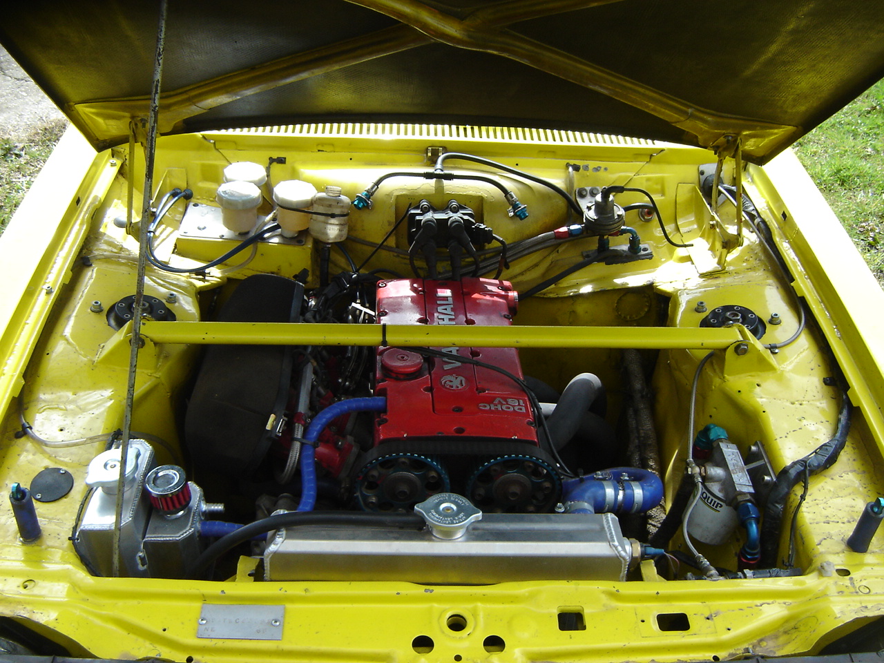

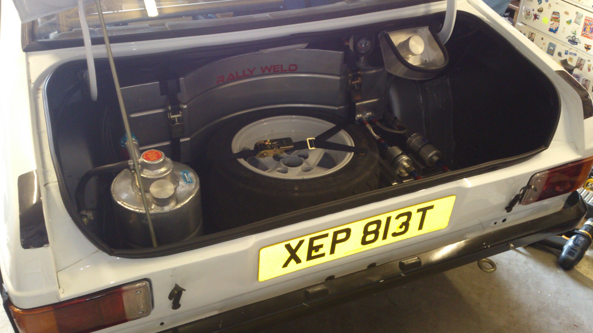

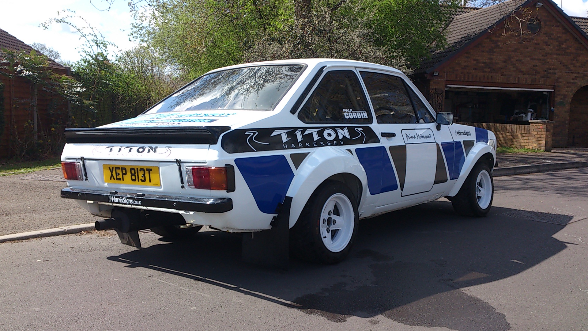

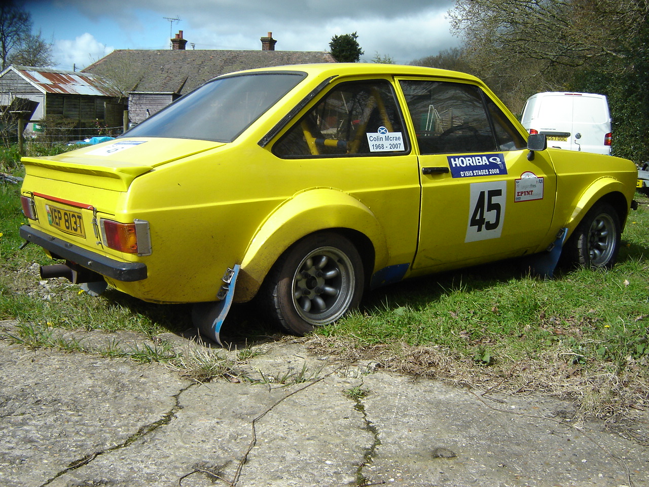

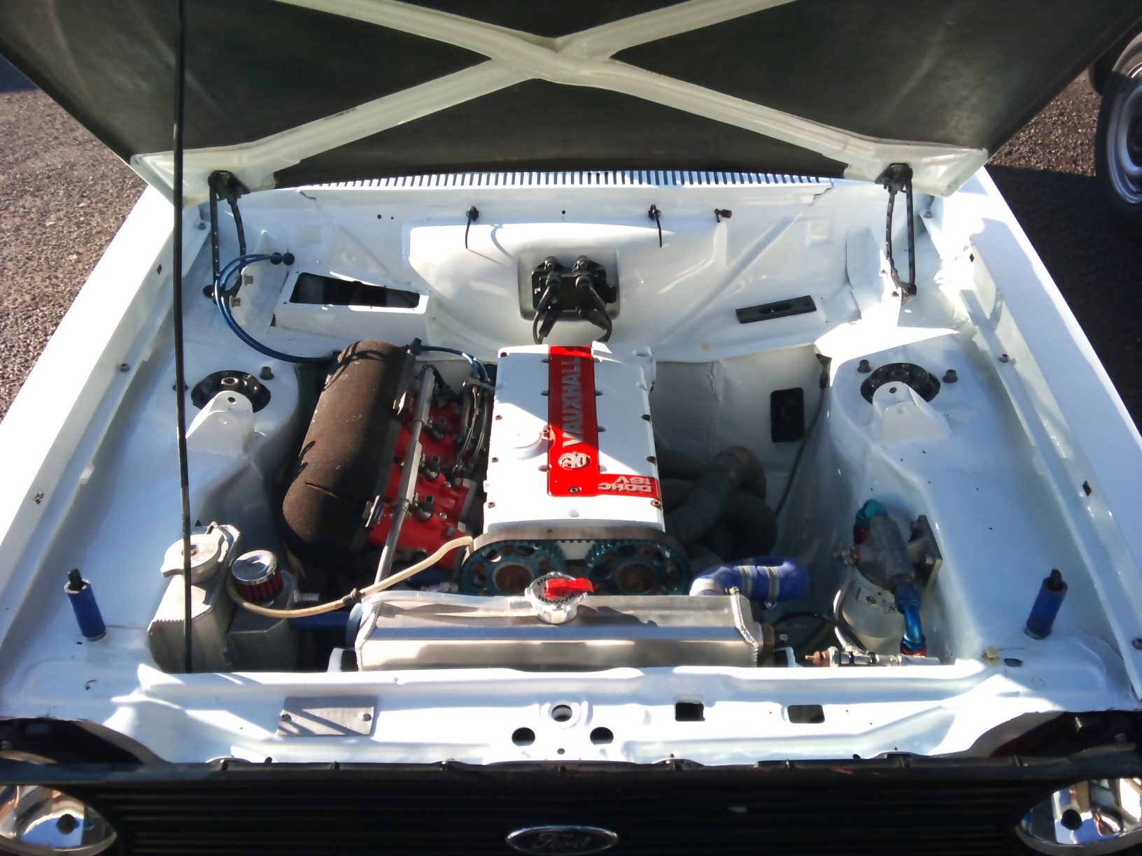

                    Thanks for all your comments guys, keep them coming as its always good to hear peoples thoughts.

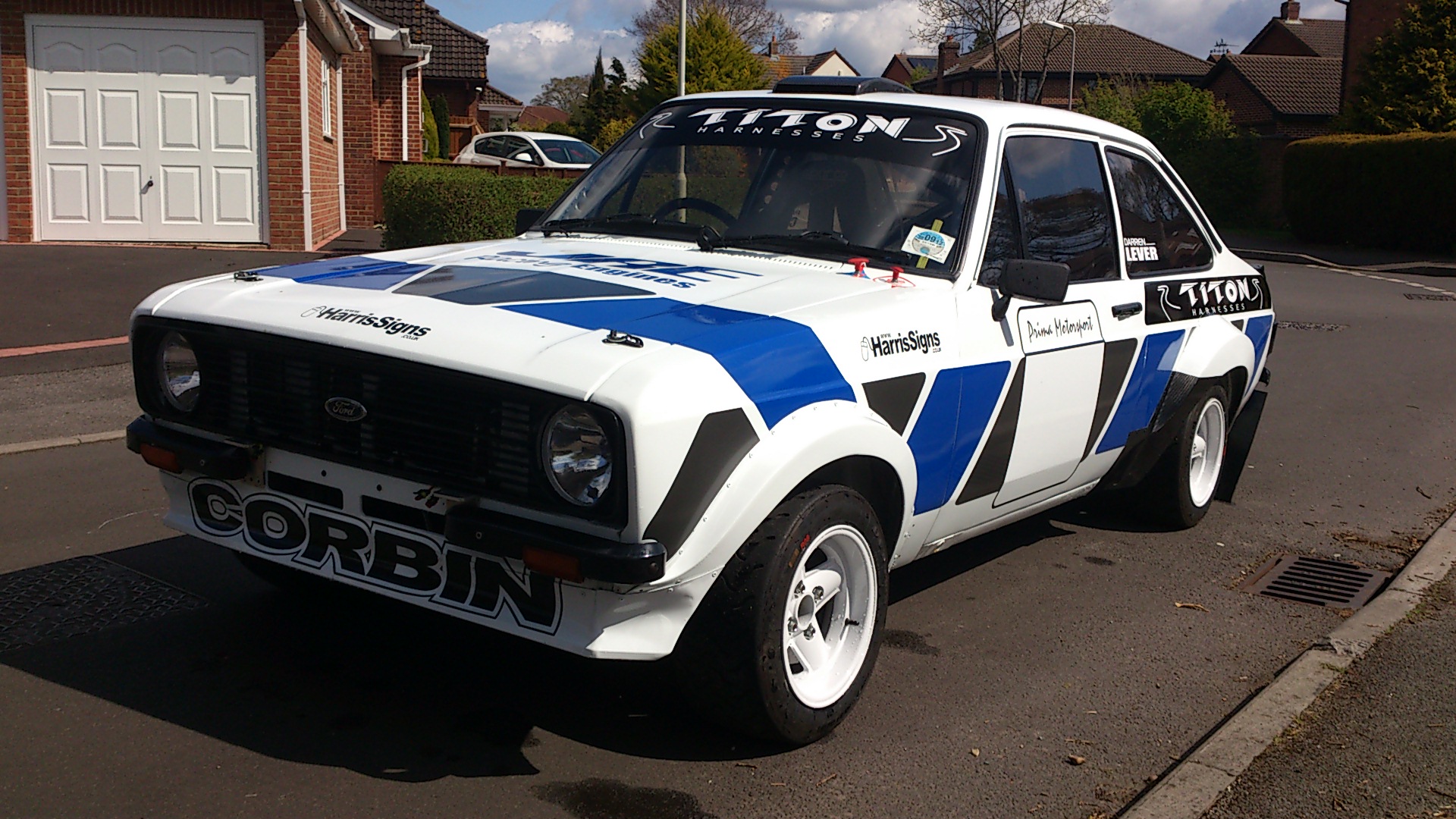

                    I thought i would put up some before and after pics as i think its quite a change as makes me realised how much work has gone into it - even if i say so myself!!
                    I've not got any photos of the new engine fitted in, but you get the idea!
                      Re: My MK2 Rally car
                      Well worth the effort IMO, looks fabulous now
