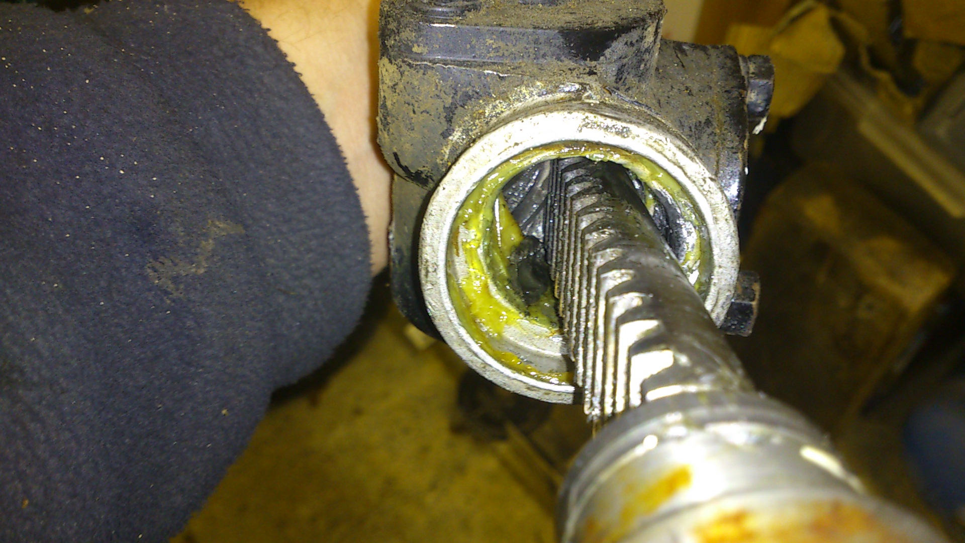

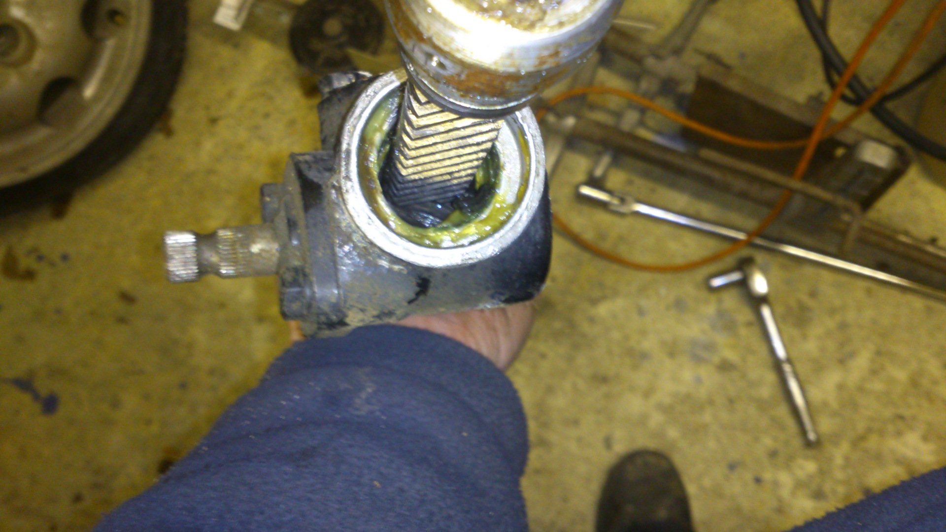

          Got the car back round to my mates again today. Ive raised the rear end now by an inch and it looks a lot more useable - but the flaps still need trimming!
          Took the old steering rack off and noticed that the inside of the drivers front tyre has worn significantly more than the outer, and just put it down to too much camber. Even though i'm not running much at about 1.5 degrees .
          When James checked it over for me, he said i was getting more lock on one way than the other, so i thought i'd whip the boots off to see if anything jumped out at me....
          Now i'm no expert but thats not coming out the middle, nor is it straight! That will explain why it would never turn left with out understeering !
          Tomorrow i will get the rack back on and then start taking the struts off to fit the new 300lB springs.

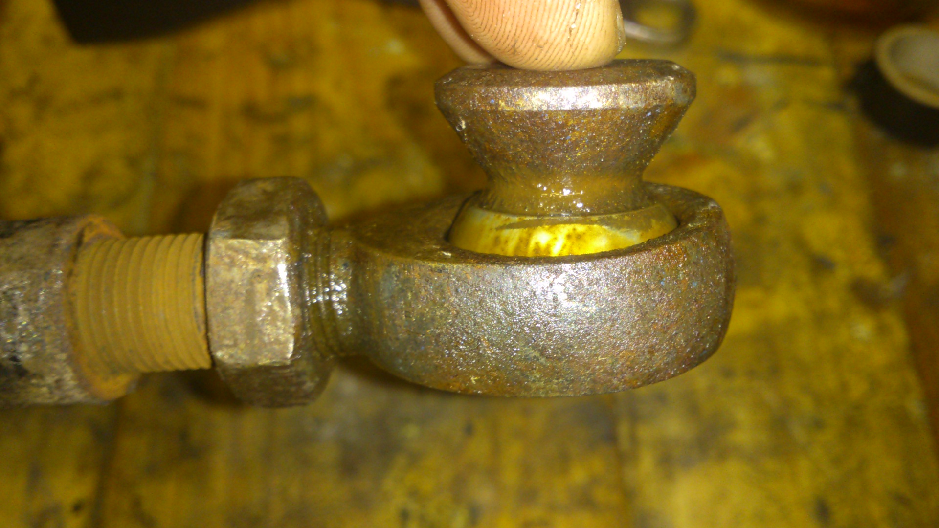

              Ive got one question on rose joints, is the ball in the middle supposed to be able to spin all the way round? Or does that mean they are worn? I have one that is obviously worn, but i have a few that feel ok, but do spin right the way round.

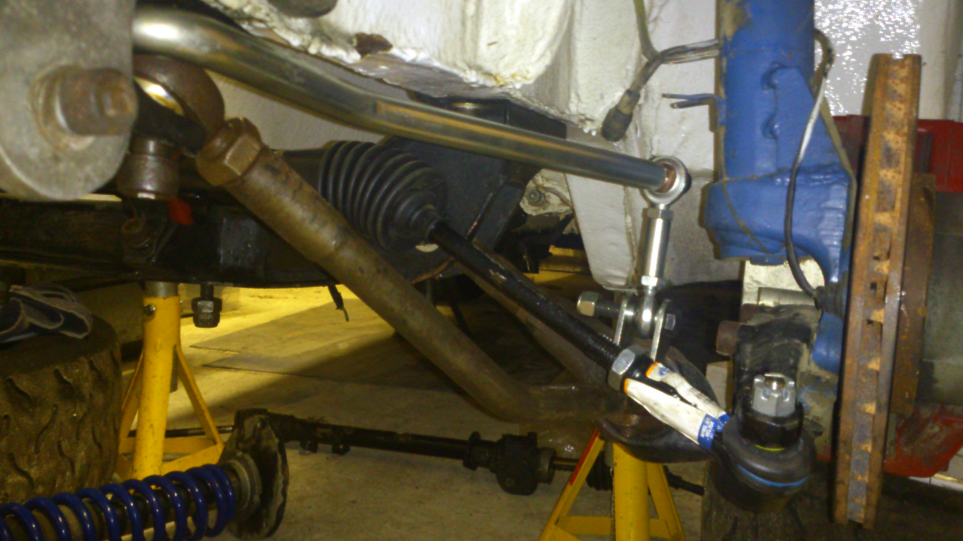

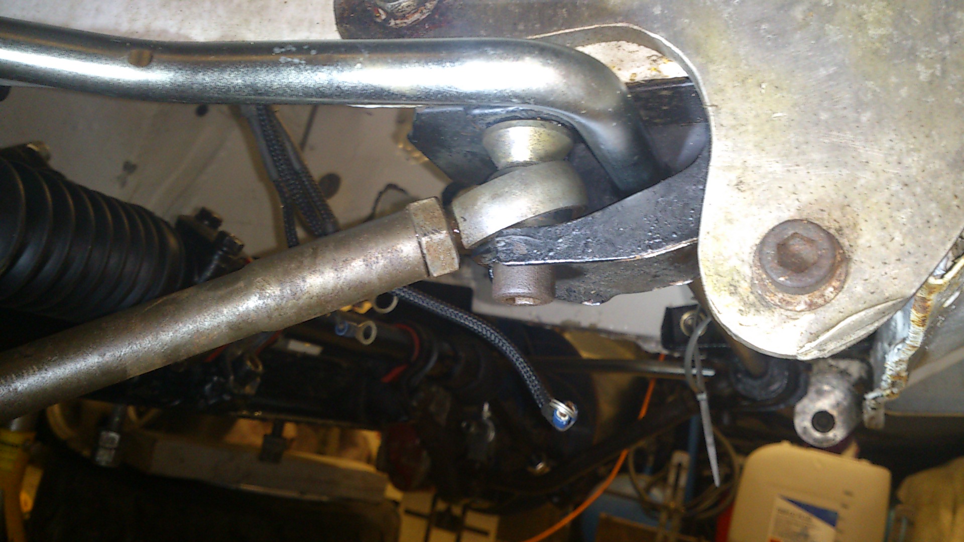

                    I fitted up the new anti roll bar today with new drop kit and put the suspension struts on again.

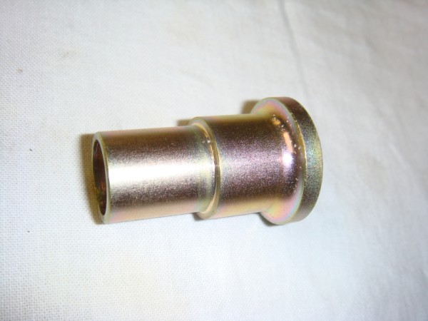

                    Can anyone help me with this rose joint? It is properly fooked! Wobbles like a bitch, but i can decide is its an all in one rose joint, of if the "cone" bit has been pressed in as a separate unit??
                    It goes on the front on the tension strut, and its needed to get the "droop" angle.
                    • alladdin
                      • May 2005
                      • 9248
                      Re: My MK2 Rally car
                      looks like it would be a pressed in part to me.
                      • Paul C
                        • Jan 2007
                        • 1232

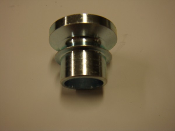

                        Think i've answered my own question ! Care of Grp4 Fabrications.
