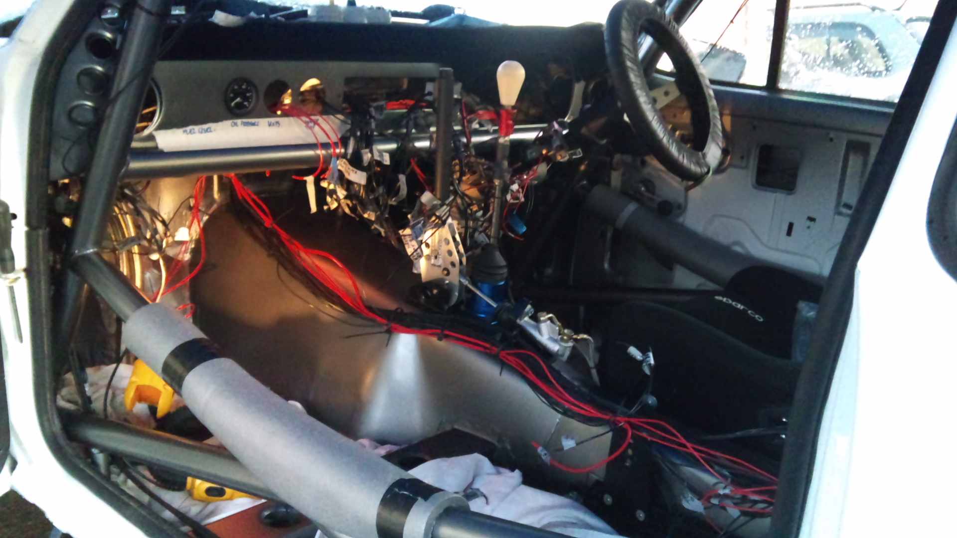

                  Seems a long time i have updated this one.

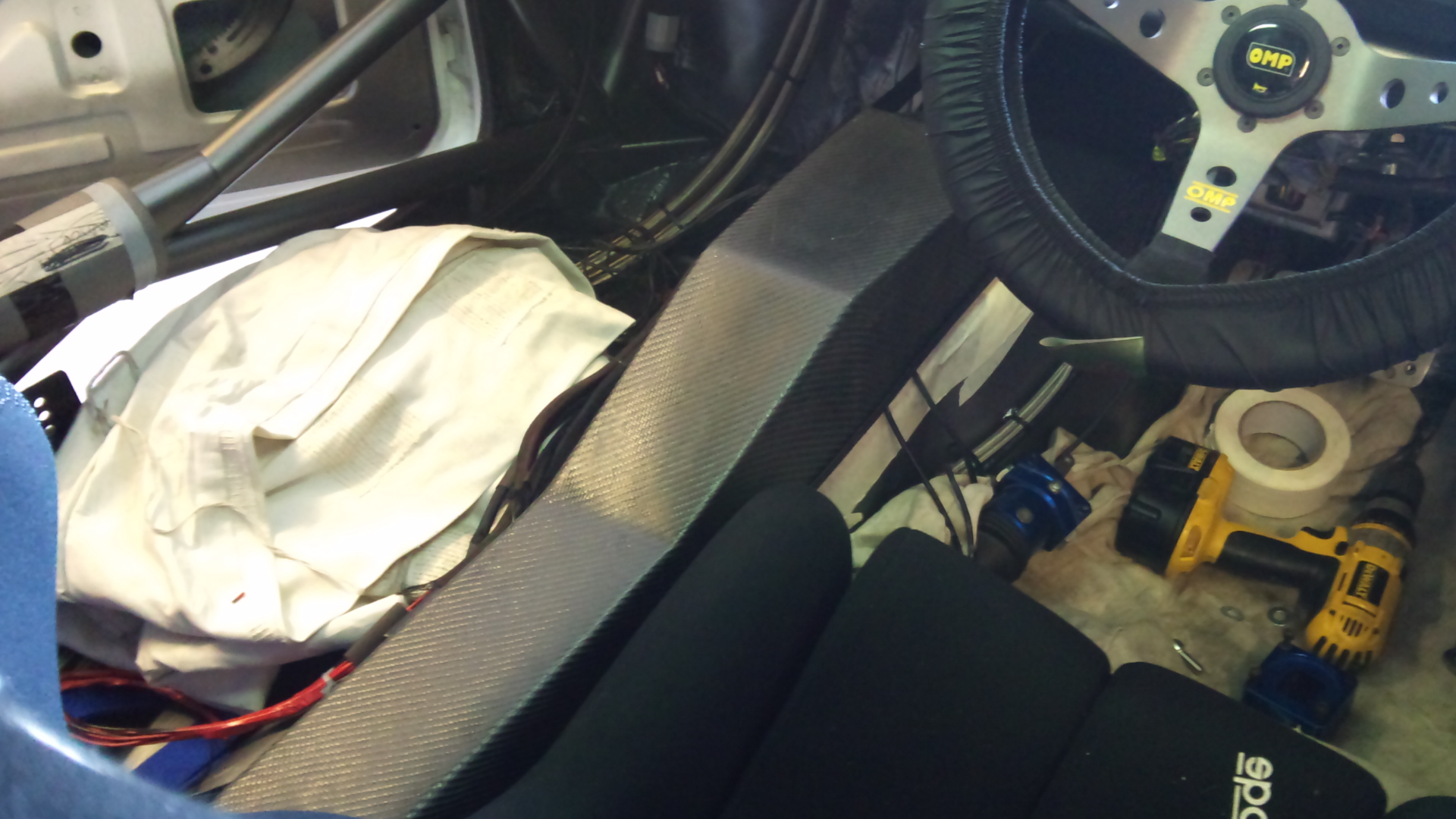

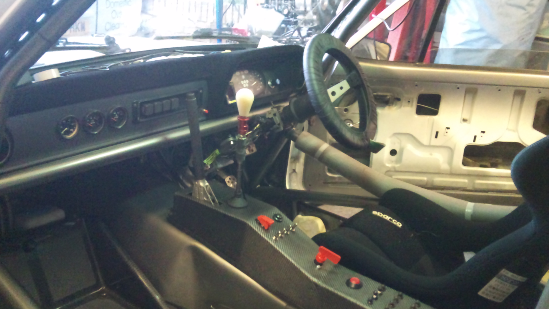

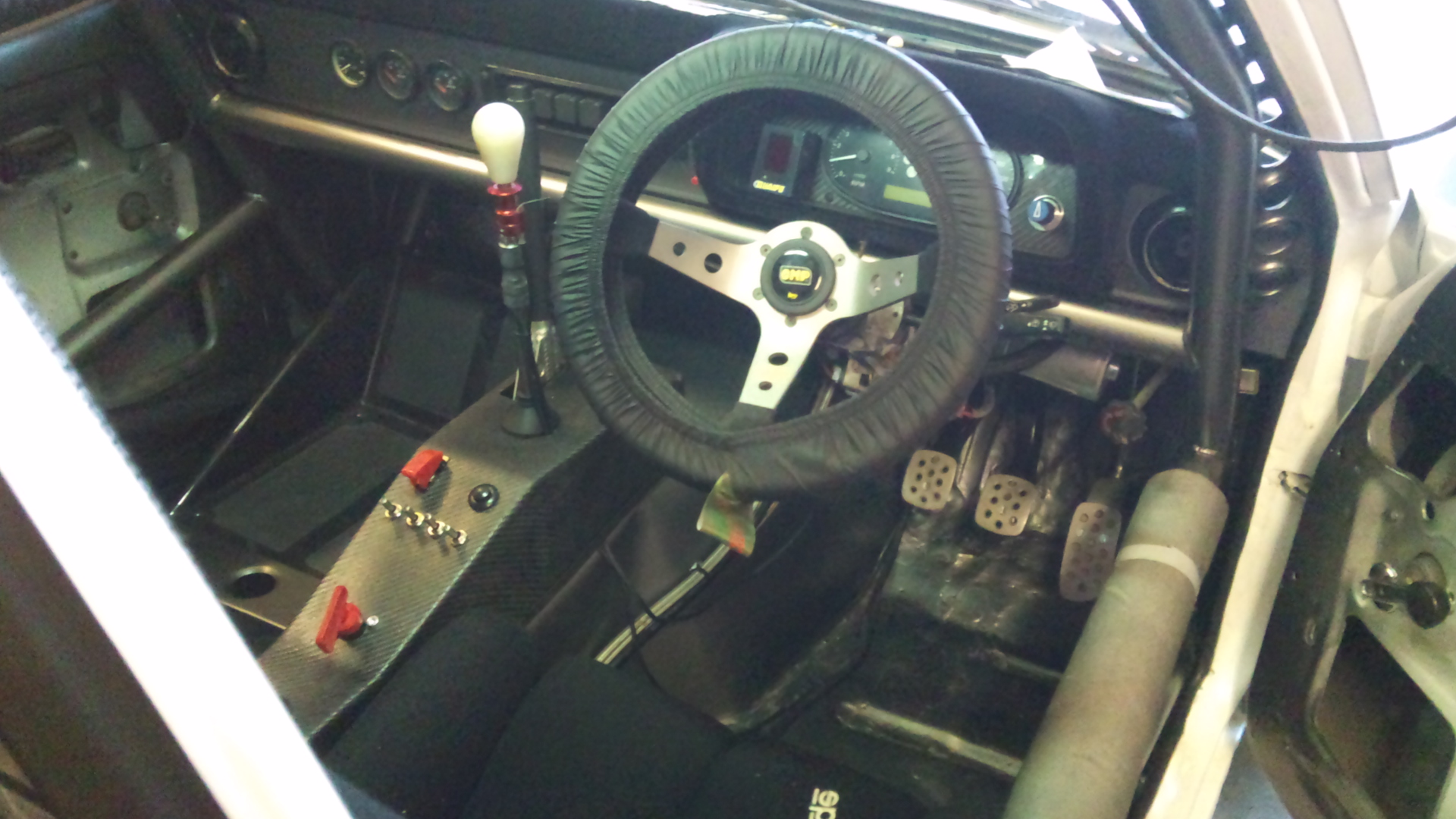

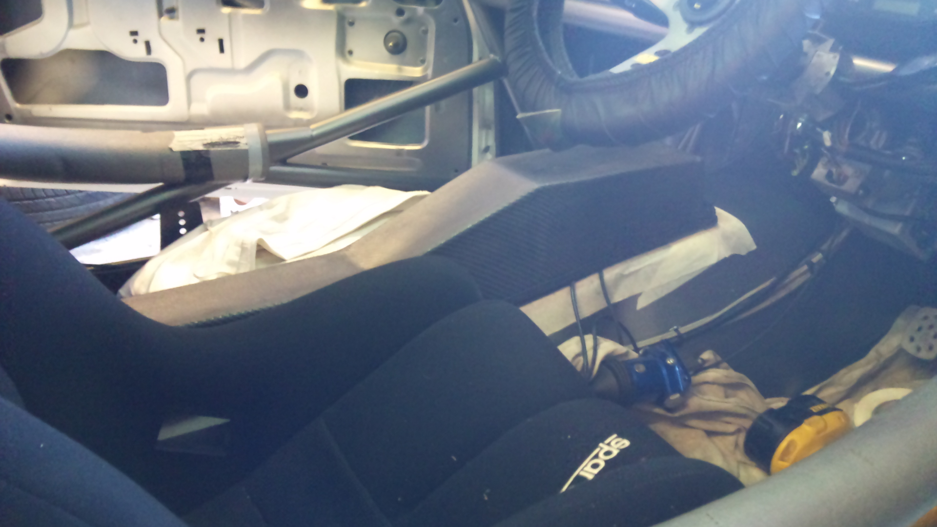

                  I have now finished covering all the loom and heat shrinking it up. Its surprising how long it takes. Its all now fitted in the car and connected up. Next up was the console fitting. Firstly i trimmed it to the correct angle to suit the tunnel.
                  Then i cut the hole for the gearstick which centralised the console. Then the hole for the handbrake was cut, and then sat in the seat to work out where it was best to fit the switches etc. These took some planning so that there was enough clearance on the handbrake cylinder etc.
                  Powered it all up and switch one thing on at time. I instantly cooked the resistor for the kill switch!! That always happens to me! So threw that away It all seems to work, few things to double check on, but very happy with the wiring, it was worth it all in the end.
                  Does anyone know if the quaife sequential display provides a switch live for the reverse lights? I've tried phoning Neil from Geartronics today but no answer. Not that i need reverse lights but would be nice to have them working.
                  Also got the engine fired up today and drove it out the garage Hoping to get it on the rollers tomorrow for a bit of a tune up.
                  Sorry the photos are a bit grainy. I will get some more tomorrow.

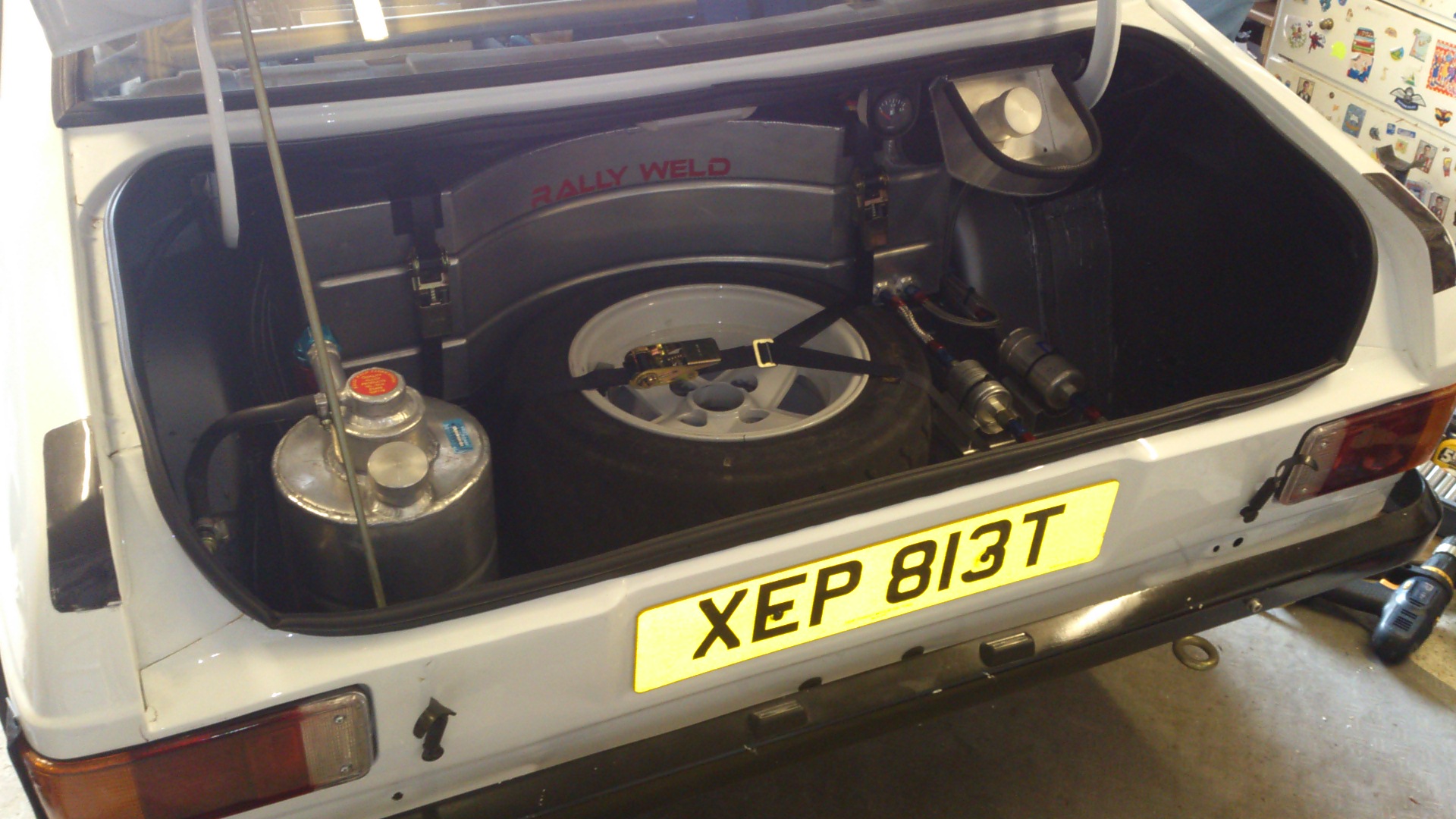

                            Fitted up the boot, just got the jack to fit in the drivers rear boot well. and thats finished. You can just make out the led boot light in the centre on the parcel shelf.

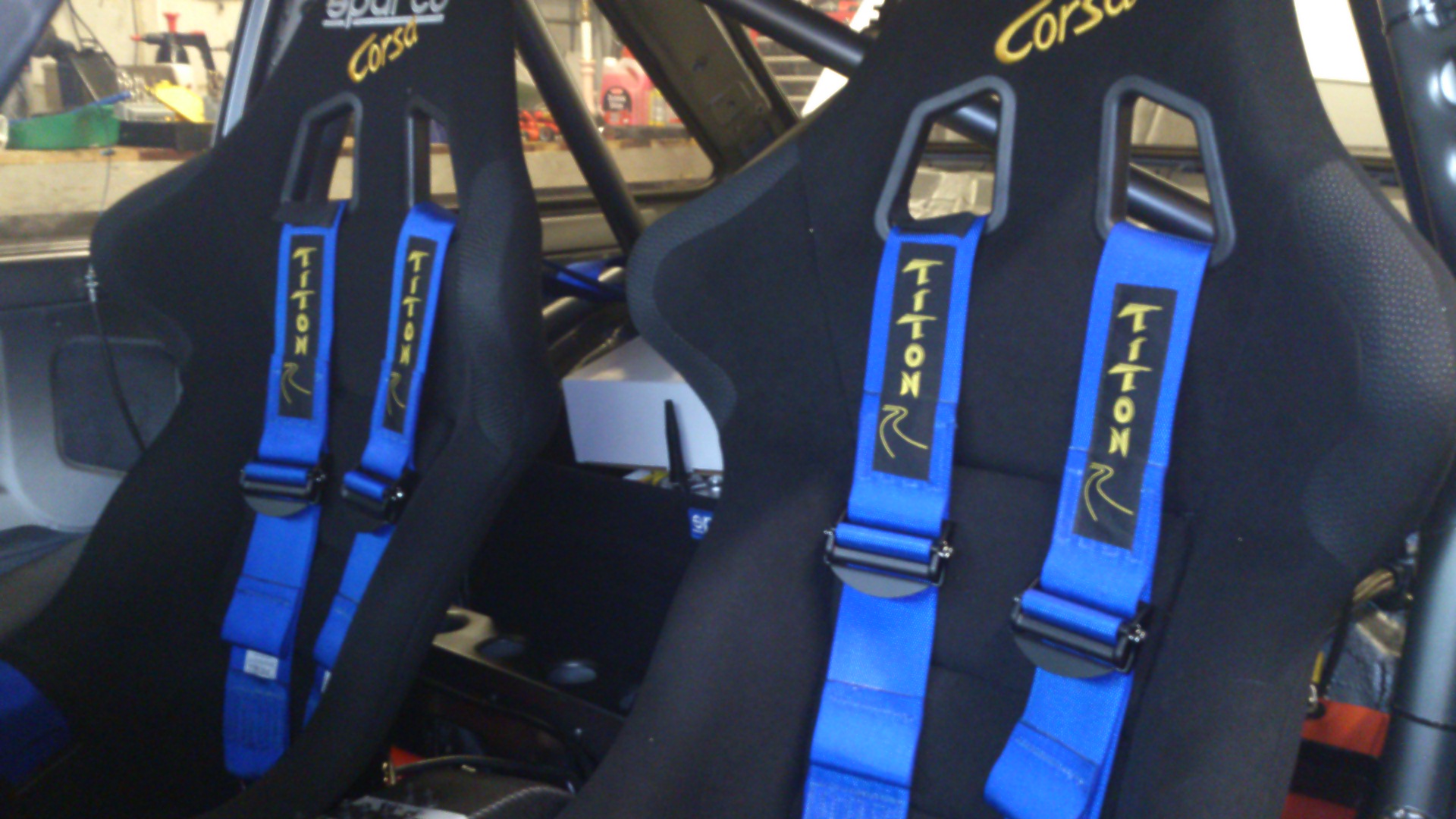

                            Fitted the passenger seat today - hope fully for the last time! Got a the belts in and fitted. (if any one needs some new harnesses then give me a shout for some Titon ones)
                            And one more of the dash all lit up - just because i think it looks cool
