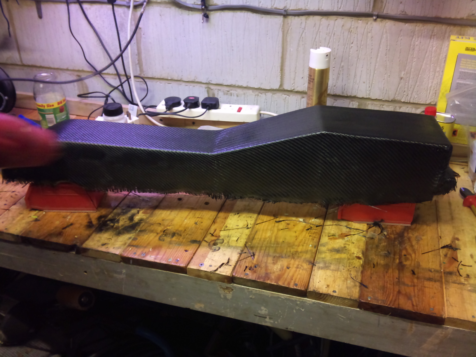

          Sunday i layed the carbon up into the mould for the centre console. I am going to give it a week to let it cure and then next weekend i will attempt to get it out the mould. I have to say that it went well with the carbon. In its natural form it is very delicate, but if the top looks any where near as good as the inside i will be very pleased.

            How easy was the carbon work? I've got a steel false floor under the pedal-box at the moment, but a carbon jobbie that fits the tunnels, bulkhead, cage etc would be the icing on the cake

                Its been very time consuming so far. But a lot of that time was spent making the mdf mould. I would guess that it would be quicker to just take a mould of the floor and then lay the carbon over that. It would need less sanding to get it flat and smooth. Your plan would be great and finish off the interior.

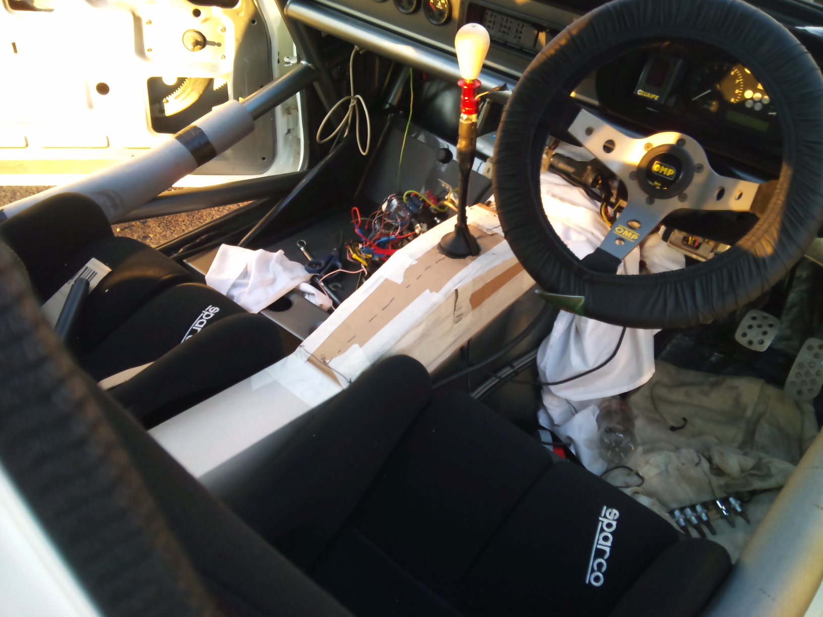

                    I've had another good weekend on the wiring. I've managed to strip out all the loom - again! I've thrown some cables around for the circuits that need a relay. So that is the spots, up and down, rad fan, heated screen left and right. Then i moved on to the gauges that i have fitted on the passenger side of the dash which is a volt meter, water temp and oil pressure.
                    I've got the feeds in for the fuel pumps as well. Doesn't sound much but its moving forward. Its surprising how long the wiring takes. It will be worth it though.
                    Also finished the carbon console - which has paid off in the end. That has taken hours and hours from start to finish but i am very pleased with the finished result.
                    From the cardboard concept...
                    To the finished item....
                    Its still wet in this photo, but i hope it looks as good when its dried.

                      car looks the bullock
                      • PaulAlex
                        • 1551
                        Re: My MK2 Rally car
                        Looks superb Paul - you should have made a few and stuck them on eBay

                          Nice work there Paul, thats a great finish. I don't think I'd like to attempt it as I still have nightmares over my limited fibreglass experience!!! Horrible sticky stuff!!
                          Not too long now by the looks of it
