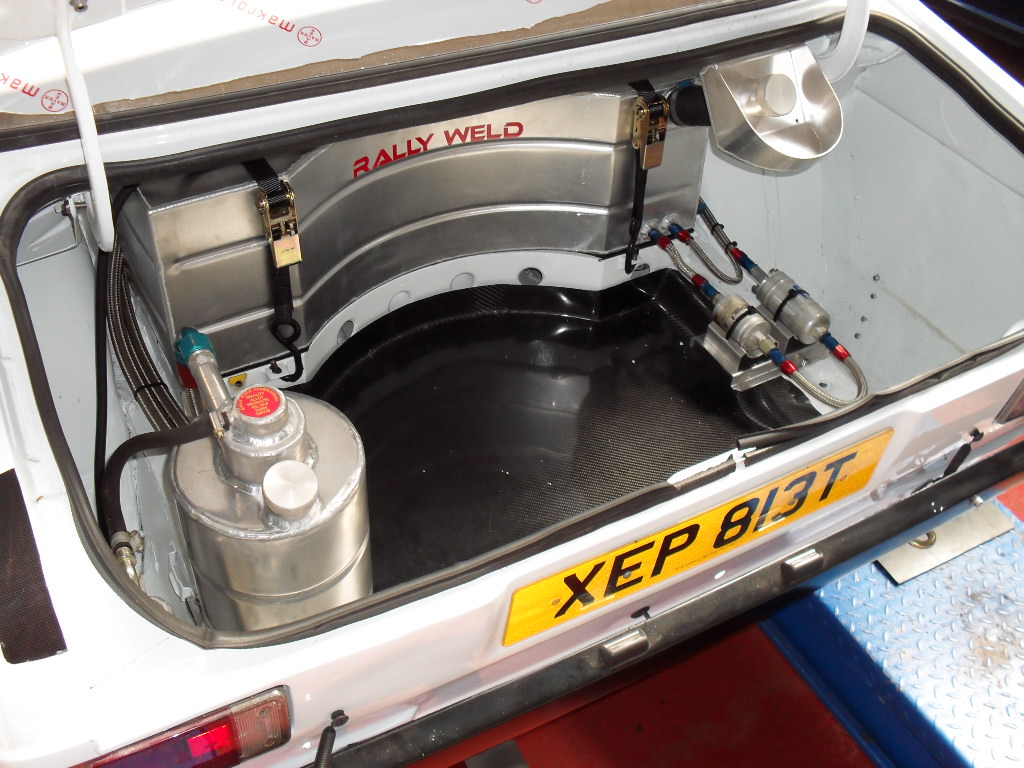

                One problem i've had today is with the fuel lines. I was running them in throught the car and, like everything else, i've decided to change the route of them and add some -6 goodridge bulkhead fittings. How ever the -6 fittings that i have bought at too big for the braided hose. The hose was already in the car before the rebuild, and has "goodridge" style fittings. The new fittings i've got, once tightened up, they just pull off.
                I can't work out why the hose, which had a fitting on the fuel pump end and one on the fule power booster thing. So all i've done is cut it at the engine bulkhead, fitting a goodridge -6 bulkhead fitting, and then attempted to fit a straight -6 fitting inside the car and a 90 degree in the engine bay.
                I took one of the originals apart and it had what looked like an olive inside it. I was hoping to get it running this week, so if any one has some idea on whats occuring - i'd be gratefull.

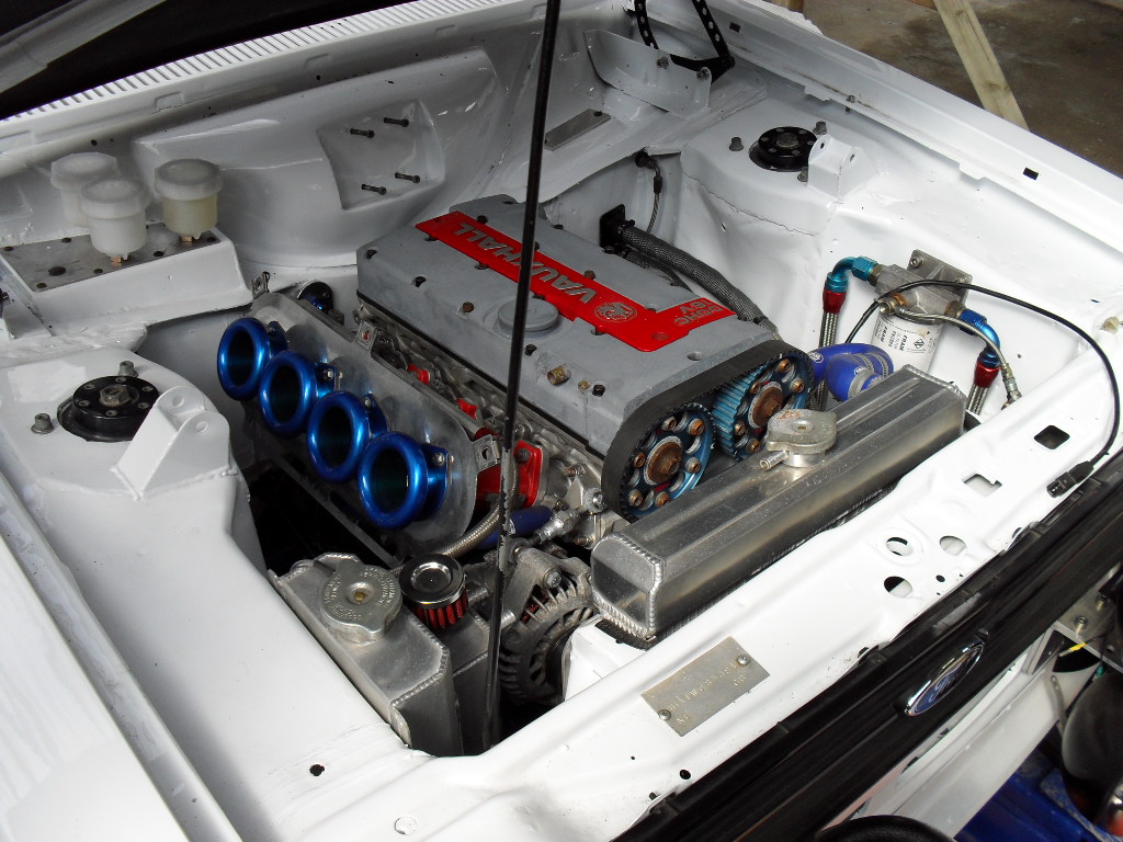

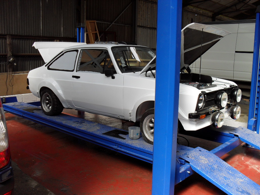

                  Three pics.
                  I've decided to bosh the old wiring loom back in just to get it going and then in the winter try and make a new loom.

                    Hi Paul - the bulkhead fitting issue sounds like you maybe have fittings for teflon-lined hose, and are using ruber-lined hose? Or vica versa?

                      Thanks Paul, i sorted it in the end with the fittings i had and some rubber hose in the engine bay. A job on the "to sort out" list!!
