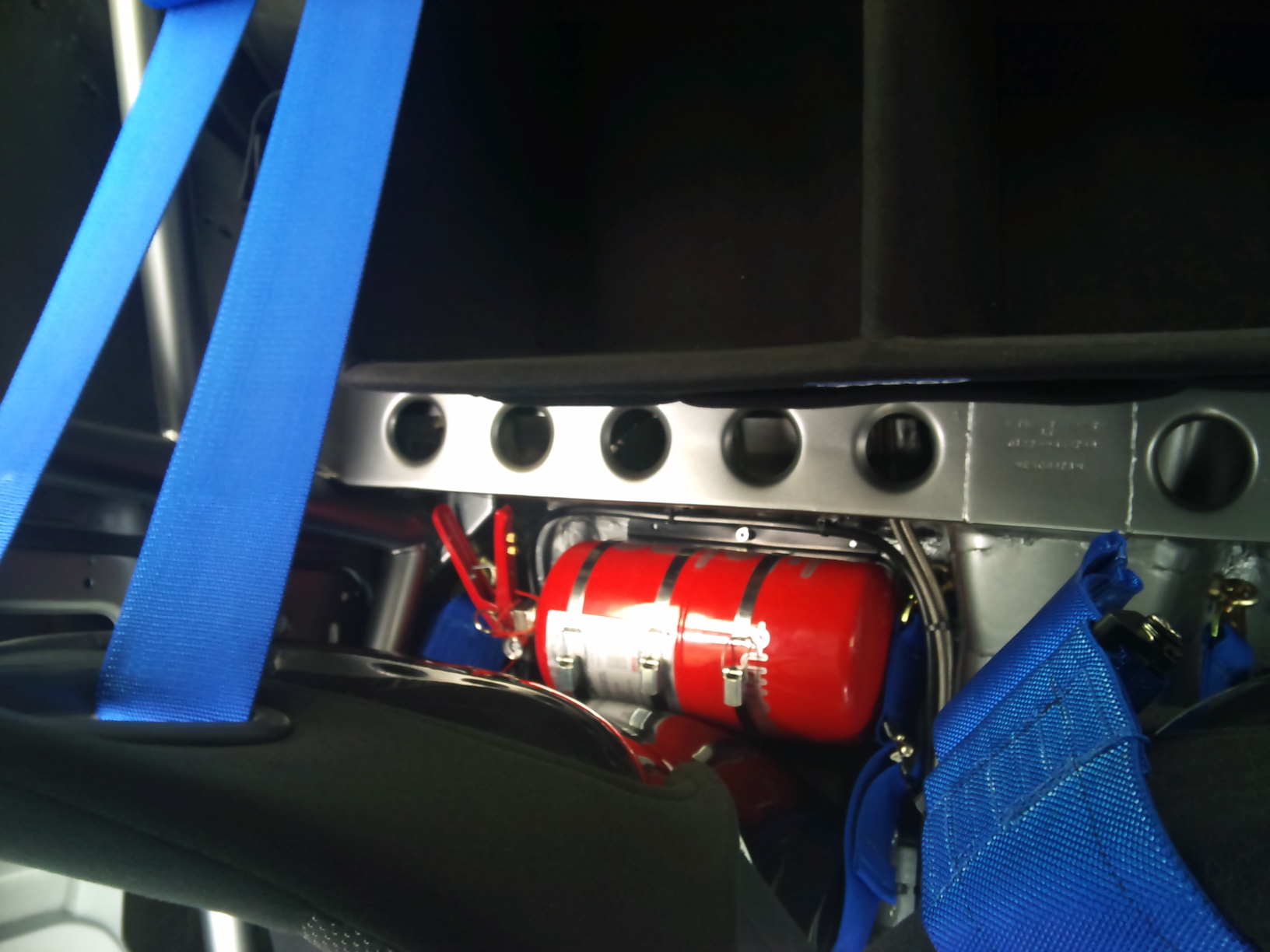

    Thanks for all your extinguisher suggestions. The trouble i have is that i have got a helmet box mounted across the link boxes and diff tunnel. I would ideally like to keep it if i can.
    muckerbarry If you can get a photo that would be helpful, but i think i understand what you mean.
    It looks like i have room available to mount it on the link box cross member, so will have a go at that at a later date.

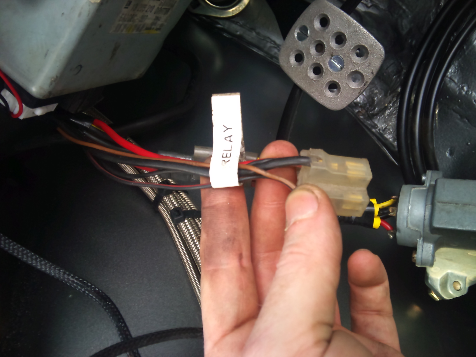

        Oh and i've found this connector all nicely labelled up - but does anyone know what relay goes in it and whats it for?

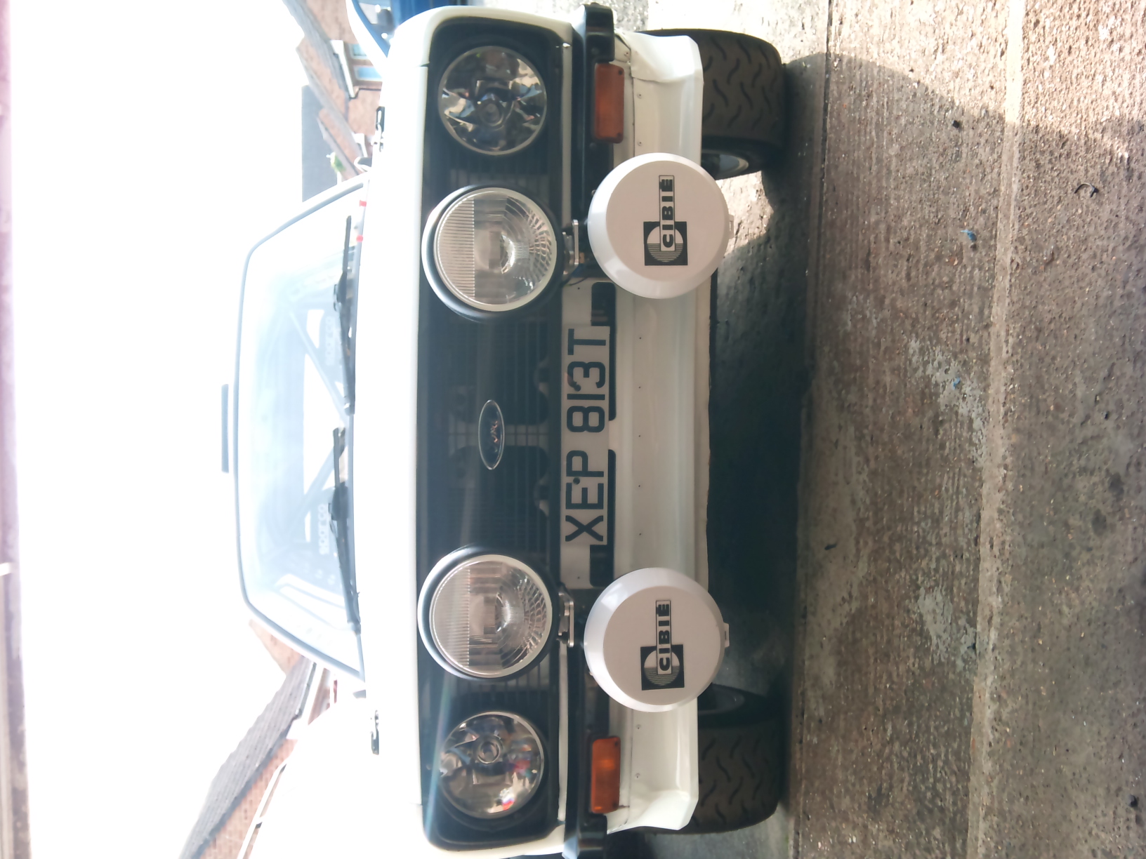

            So i ended up fitting my spot lights to cheer me up!
            Back on it again tomorrow for round two!!
                  Glad to see its soooo close now Paul

                        The relay connector under the dash - the only standard ones under there on a Mk2 are the flasher unit and sometimes an intermittent wiper relay, I don't recognise the wiring colours but the connector looks standard Ford

                          Thanks Gavin - i would guess it is for intermittent wipers then as the flasher unit is up above that connector. I will just stick it up out the way then.
