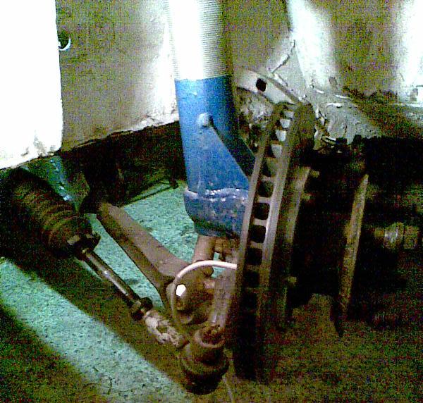

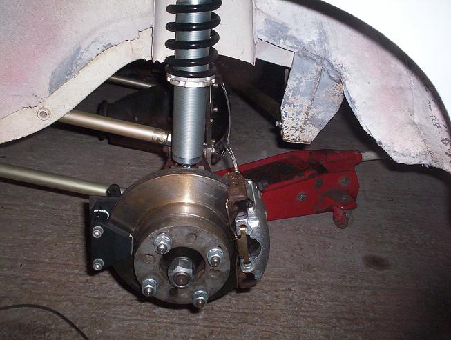

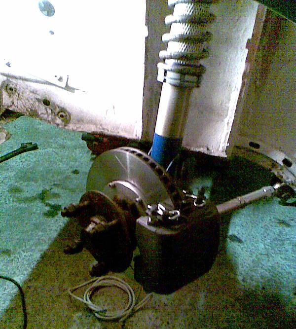

              I've been making slow progress on DVY due to having to work a few weekends, but last weekend I got the front calipers and discs built up
              I'd bought the calipers with blank lugs as they are cheaper like that and spent a few hours maching them with the help of my landlord Mike's metalworking machines

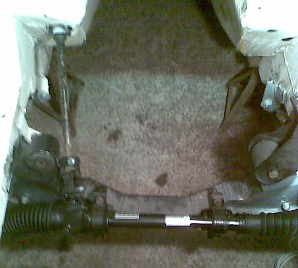

              I also fitted a probe for the tripmeter and a heavy duty quick rack from Barney

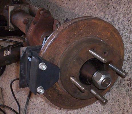

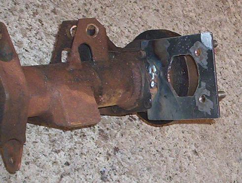

                I'd bought some Wilwood Spot Calipers a few weeks back to try and make a proper mechanical handbrake but they looked a bit difficult to mount so I made a template out of cardboard and gave it to Mike
                A few days later he'd cut 2 of these out of 3mm plate with his plasma cutter
                I welded them onto the axle today and everything fits nicely
                And the diff is now nice and tight after I added a couple of shims

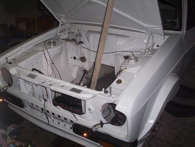

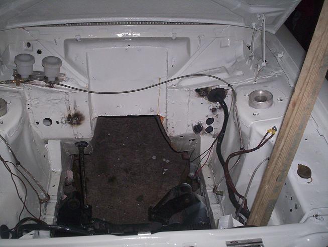

                        I had a few days off last week and have been making slow progress - not as much as I'd hoped as everything seems to be taking twice as long as it should - various holes in the bulkhead I need had been welded up including the large hole all the wiring goes through and my extra clutch cable tube (specifically designed to miss a cossie manifold) had been cut off flush and filled with weld - after about 3 hours of drilling, grinding and welding everything was back to how it used to be

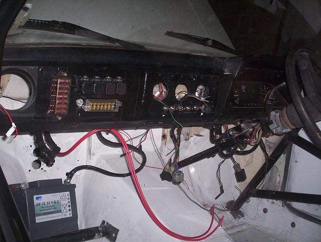

                        I couldn't find a complete escort wiring loom in my shed but I found about 2/3rds of one so I spent a couple of days modifying and extending it to fit and its now installed

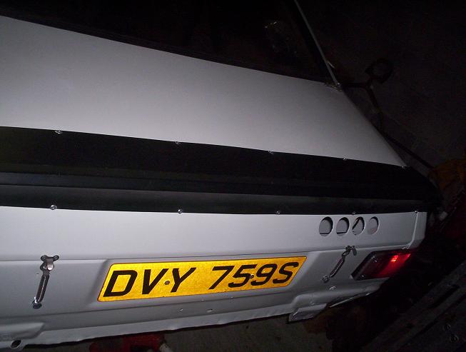

                        All the lights work and the wipers and washers, but not the indicators and I refitted the rear spoiler and number plate to make her look more like a car
                        The axle's all fitted with the calipers and brake pipes and rear suspension
                        And the front brake pipes are done, just got to mount the reservoirs properly and fit the pedal box, hydraulic handbrake, etc
