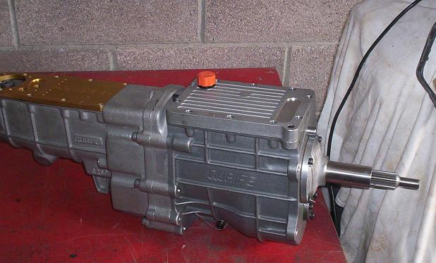

                After finishing the hillclimb season a month ago, I was going to get the engine and gearbox out for a rebuild, but various friends at Tavern MC were planning to do the Carfax Stages at Longcross in November so I decided to enter that instead, with Teresa co-driving as she lives just round the corner
                The engine is fine for the rally but the gearbox needed looking at so it came out and I dropped it off at Competition Transmission Services http://www.gearboxman.co.uk/ (who are now Quaife's main stockist for my type of sequential box) together with my 5.1 axle as the pinion had a lot of play and the LSD had a bit too much S in it

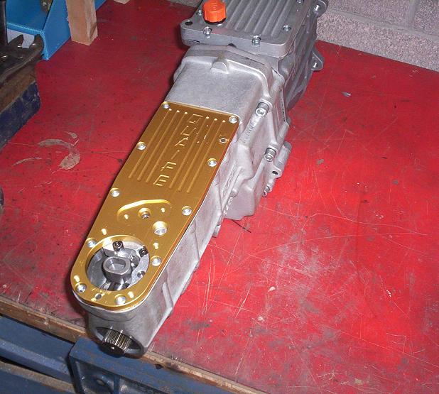

                A week later they phoned with the bad news, as the input shaft had come loose and a lot of oil had dropped out, everything that touches the input shaft needed replacing together with the shaft itself and most of reverse, which came to a complete cost of £1900, but they offered a very good discount on a new 6 speed box so I went for that instead
                I picked everything up last weekend so today's job was to put everything back together
                It looks identical to the 5 speed except for the gold plated top plate (that's why they're expensive ) and I've gone for a 2.2:1 first and a 0.87:1 overdrive 6th - coupled with swapping to the 4.6 axle permanently (the 5.1's going in Fly ) this should give me almost identical top speed in each gear as the 5 speed so the same acceleration up the hills, but a top speed of 128.5mph
                I doubt I'll need this at Longcross - it depends where the chicanes are - but its there if I need it

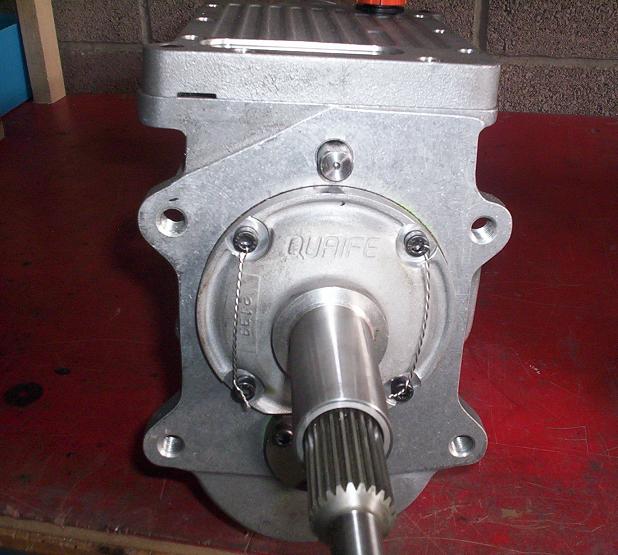

                Spot the lock-wired input shaft housing just to be safe

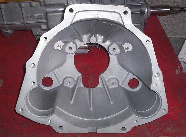

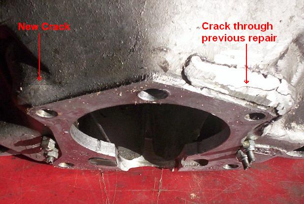

                While the gearbox was out it made sense to check the clutch and bellhousing - the clutch was fine but the bellhousing wasn't
                This still shouldn't have made the input shaft come loose, but it cannot have helped so I bought a new one from Rally Design - it's thicker all round and even comes quick release as standard with strengthened bosses threaded M10 to mount the box to, very nice shame I had to drill a large hole for the layshaft bearing - they should do ones with this feature as they do for Duratec's, etc

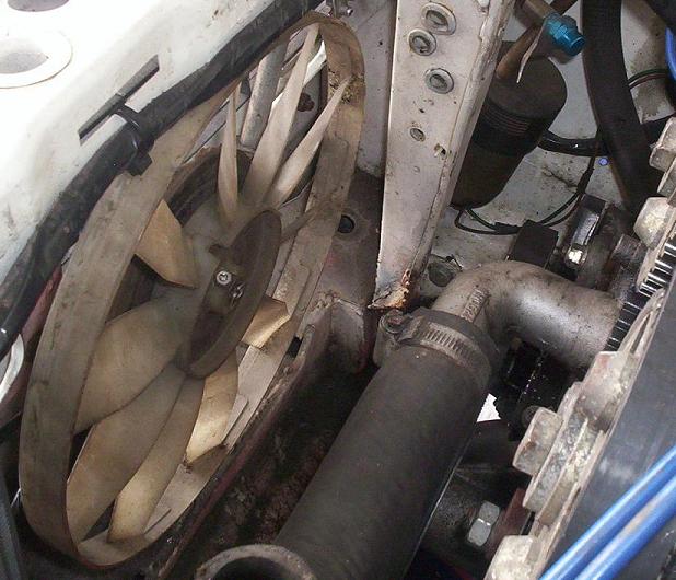

                Also, after the fan coming loose in Wexford, I removed the rad to have a better look, found the rad sides were loose so that's been reconditioned as well, and I modified the fan motor shaft with a split pin as a back up in case the screw comes loose again
