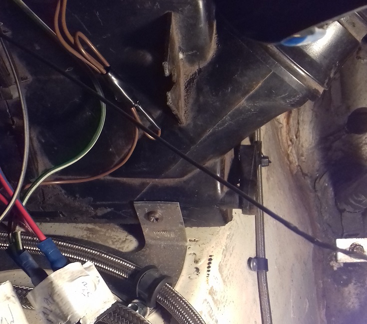

                  Did some investigation over the weekend as I was curious how something had been done...
                  When I first owned DVY and had removed the heater, we never had any problems with the screen misting up, even on very wet events. No heated screen and no blowers either. I always assumed there was enough airflow into the car to keep everything clear.
                  The chap who I sold her to and did some forest events and Barbados, initially ran a Vauxhall engine and recessed the centre of the bulkhead / heater bubble a couple of inches. This was done very neatly so I didn't bother putting it back to original.
                  After the problems in Ireland this year, it got me thinking about where any water going into the grill below the windscreen went. Looking inside the car, there is a flat sheet welded over the blower motor recess, and in the engine bay there is a vertical flat sheet slicing through the heater bubble.
                  So I got a watering can and poured it into the grill, looked underneath and there was no water coming out, or inside the car.
                  So I got another watering can and poured more water into the grill and managed to fill it up
                  The two plates join creating a V shape and without any drain holes, the water cannot drain out!
                  Eventually the water dribbled out of some bolt holes and I poked a drill through at the bottom of where the 2 plates join and let some more out. As much dribbled into the car as outside so I think this is a large part of the problem - whenever it rains there will be water in the heater bubble, which can easily get into the car and turn into steam from the hot floor.
                  Next step is to cut a slot / drill a large drain hole at the back of the engine bay to allow it to drain out.

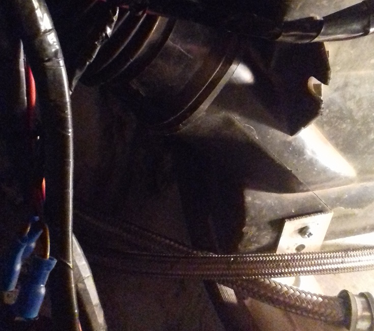

                          As I'm rebuilding Fly this summer, I decided to get out in Dvy again, so I entered the Mewla this weekend.
                          So I've spent the last 2 weeks sorting out the minor issues that happened in Ireland, including fitting some new bushes in the alternator mount. This simple job turned into a few evenings work as the new bushes moved the alternator forwards by 6mm so the pulleys didn't line up I resolved this by making a new mounting plate - the alternator is spaced forwards anyway due to the dry sump system. I also fitted a slightly longer Poly-V belt as the old one was so tight it made it very hard to fit.

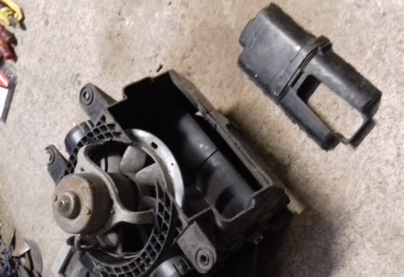

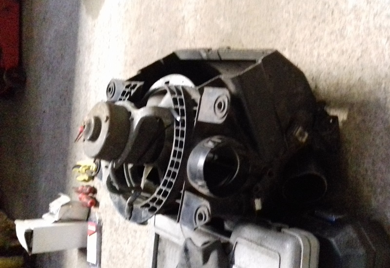

                          Back to the heater / blower - after taking measurements from Fly and looking at an old Mk2 plastic heater box, I decided if I cut 40 mm off the front I could make it fit...
                          I drilled a hole in the engine bay and cut a slot to let any water out - this is now covered with an ally plate to keep the scrutineers happy, but before I covered it I fished out various washers, old rivets and rust!
                          Inside, I drilled into the middle of where I thought the original blower motor circle would be, and snipped round the circle to recreate the hole with a flat on one side.
                          When I'd found the heater box, I also found a Mk1 (or early Mk2) metal heater and fan - the fan being mounted in a sort of alloy casting with 3 legs. This fitted into the hole I had created, but not all the way. After a few hours cutting the heater box, I ended up with this
                          The fan is recessed to allow for the smaller heater bowl, and the top 2 legs fit on the flat side of the circle I had cut out
                          The tie-wraps are temporary so I could offer it up in the car and make sure it fitted. It did fit, so I cut an ally plate and glued it over the hole with some sealant. I also sealed the freah air vents and cut away some of the floor vents so it sat better on the tunnel, locking the lower flap in position so the air always goes to the screen. A bit of foam round the top and I screwed it into place using to of the original mounting points. The other 2 had been removed when the bulkhead was cut, so I added some ally brackets to the tunnel to stop it moving around. A fuse, switch and a bit of wiring later and I have a working demister.
                          I'm hoping after all this that it will be a lovely sunny day on Sunday!
