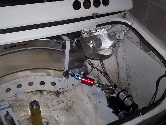

        The engine is nearly ready (delayed by the bad weather) so today I finished off the boot
        A bit messy due to the fuel pumps having push on connections, but should work and the pumps are mounted a fraction lower than the tank outlet so should gravity feed through the first filter

            The tank has a built in pot beneath the feed so there should always be plenty of fuel coming out

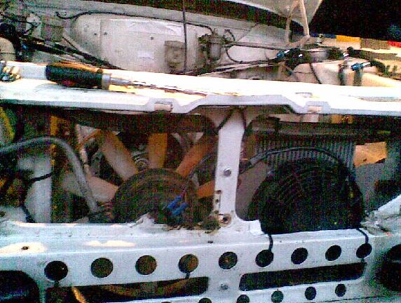

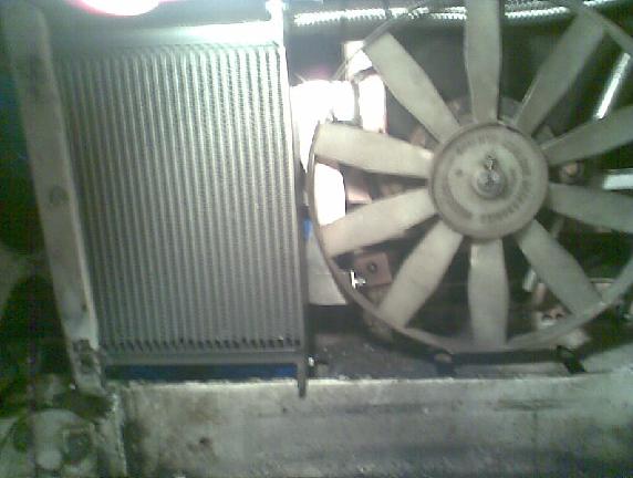

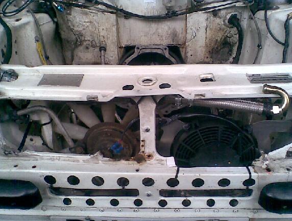

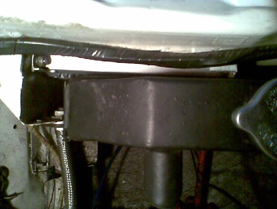

              More tweaking last week - since putting the dry sump tank in the engine bay, everything has been running a lot hotter and if I leave her idling for too long the oil temp rises as the fan is only blowing through the rad
              So I bought a 50% bigger oil cooler and a 9" fan to keep the oil cool. Bit of a tight squeeze, I had to trim the front panel, trim the grill and space the rad back with a few washers
              Then I spent today sorting out the drivers seat (which had come loose again), replacing the link bar that came off on the last event with a new one, fitted the prop, filled the rebuilt gearbox with oil and lastly fitted some "comedy size" mudflaps as per 2011 Rally Regs, 4mm thick and have to stick out 40mm either side of the tread, so now they are the widest point of the car

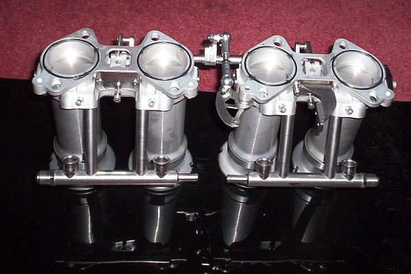

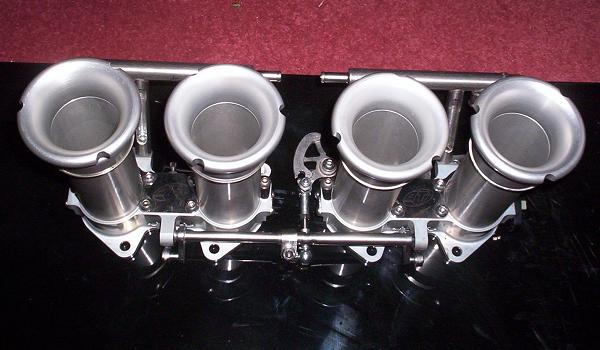

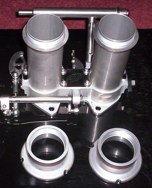

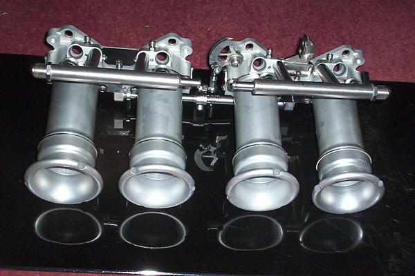

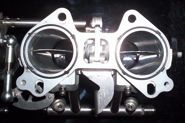

                          Throttle bodies...
                          Made by AT Power with shaftless butterflies for maximum flow to give performance very similar to a slide throttle
                          Just got to figure out how to run twin cables and then they'll be fitted
