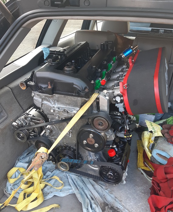

                    #534
                    Finally
                    245 bhp and 175 lb ft of torque on the Dyno so should be good when I've got it back in Dvy

                      #535
                      get in! Looks a beast, That’s a dream engine for me!
