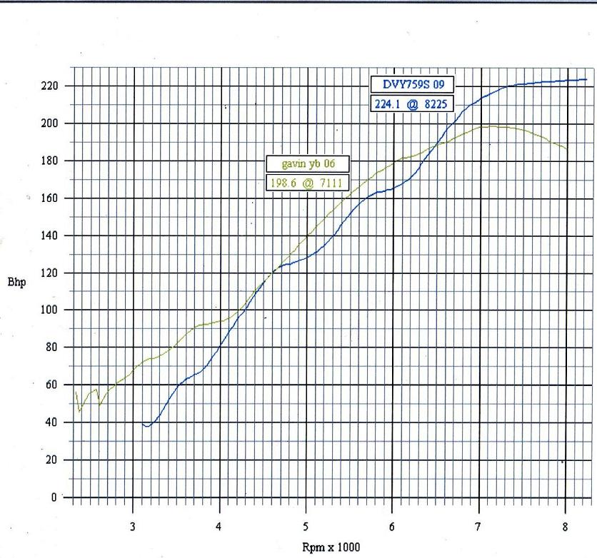

      Over the last few weeks I installed the throttle bodies on DVY, refitted the injection pumps and filters, connected the fuel pipes in the engine bay and spent hours sorting out a twin cable linkage that I was happy with, and yesterday I took DVY back to HT
      Ron sorted out the injectors, water temp sensor, TPS, AFR sensor, air filter and neatly installed all the wiring in the engine bay while I mounted the fuel regulator and coil pack on the bulkhead, then the ECU and ignition amp in the passenger foot well
      Then today the ECU was connected to the ignition, the fuel pumps turned on for the first time (no leaks from my plumbing ) and after a few attempts and some head scratching over the Vipec ECU software, she fired up on injection for the first time around 11:30am
      Many hours and 5 gallons of Shell's finest V-Power later, this was the result (the "yb 06" curve was on the carbs last summer)
      A slightly different shape to the curve, but with the rev limit set to 8600, shift light at 8000, some calculations show that if I change gear at 8300, the revs will never drop below 6500 where the curves cross
      The power figures may seem low, but if the Cossie's only had 198.6bhp all these years, then all the people with 250bhp engines that I used to beat don't have as much power as they think, or I'm a really quick driver
      More interesting for me is the power gain of 25.5bhp (or 12.5%) and 2 lb ft of torque (up from 158 to 160)
      Should be fun in Ireland in a few weeks
      Many thanks to Ron for all his hard work and to Steve for helping on the rollers and making the coffee in between working on his own engines

        nice one your certainbly notice the top end improvement especially the way it now hangs on to the power

          has the engine spec been changed in any other way ? if not i dont see why you should be losing power everywhere below 6k5 by switching to management ? i would have expected the opposite ? (the to end looks a good improvement tho )
            #320
            Originally posted by alladdin
            has the engine spec been changed in any other way ? if not i dont see why you should be losing power everywhere below 6k5 by switching to management ? i would have expected the opposite ? (the top end looks a good improvement tho )
            Hi,
            Yes - new cams designed to work with the injection and a 4-1 exhaust instead of the 4-2-1 system so the curve is pretty much as I expected, you should have seen the first one which had a big dip at 5k and max power of 207bhp
            Ron spent a couple of hours sorting out the fuelling every 500rpm before starting the power runs which took another 3-4 hours - the final curve was the 10th power run
            I'll take her up the road next week to see how she feels and make sure everything is working perfectly

              Wow, what a difference fuel injection makes.
