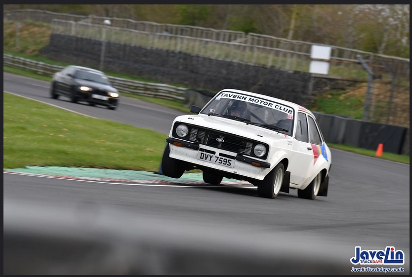

    As a test, I did a track day at Castle Combe this week.
    Passed the MOT after some welding to the boot floor / panhard rod mount, and I swapped the CWP from a 5.1 to a 4.6 which will give a top speed of 125mph instead of about 108mph (which is not enough for some of the events I'm hoping to do). The 4.6 was one I had taken out a few years ago and kept so a cheap swap.
    I'd done 25 miles on the road and then 60 miles at Combe - everything went well although the oil temp was a bit high (over 120) so a bigger oil cooler is on order!
    Water temp was 80-85 and I was getting up to 116mph into Avon Rise.
    Lap times (taken afterwards from the in car video) were around 1m 25s, very similar to the Cossie 2 years ago, but I was running the 5.1 then and getting flat out in 2 places so not a direct comparison. It was a lot better not worrying about hitting the limiter in 5th!
    The suspension is set up for Closed Road events, so a bit soft for a circuit

      Nice write up. At least you're reducing tyre wear by going round corners on 3 wheels.
      What's that revving to to give you that top speed with the 4.6 then Gav?
      It is still on 13" wheels, isn't it?

          The outside edge of the outside front tyre was showing a bit of canvas by the end of the day!
          Yes, always on 132 wheels - the rev limit is 8k and I've now got a Tracsport semi-helical gearbox (instead of the Quaife Pro) which has a higher 0.82 ratio 5th gear to help the top speed.
          The Tracsport gearbox with a 5.1 would give 113mph at 8k, but I'll stick to the 4.6 for the moment.
          The ideal ratio might be a 4.9 to give 120mph top speed but the CWP sets are not cheap!
