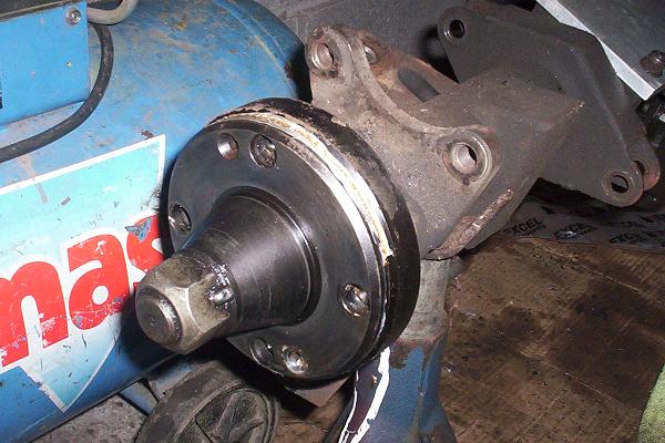

                    Having done Ireland without any problems, just a slight clonk from the diff, so I removed the axle a month ago and extracted the diff
                    It wasn't too bad but the friction plates were getting loose on the splines so I ordered some new ones from Gartrac
                    While I had the axle off the car, I thought I'd better check the studs, having sheared some on Fly recently, and all 8 of them were slightly bent
                    Looking at the axle, it was built for Fly when I was hillclimbing and is 1" narrower than a baby atlas, so on Dvy I run 1" spacers either side and this probably contributes to the studs bending
                    I looked online at hubcentric spacers, but would need to have some specially made as the Quaife flange is cone shaped, and they would be about £35 each, so I thought it would be better to make my own...
                    This is the shaft and flange

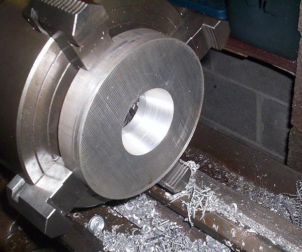

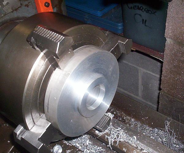

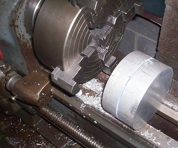

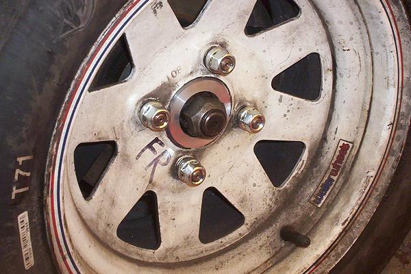

                    Take one large block of ally, 5.75" dia x 75mm, £26 delivered from Aluminium Warehouse and cut it in half
                    Machine the centre with an angle of 20 degrees to match the flange, taking into account the disc thickness which makes the cone smaller
                    Machine a 10 x 68mm spigot, turn the spacer down to 25.4mm and widen the end of the cone to clear the halfshaft nut

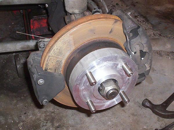

                    Drill 4 holes using a spare flange and disc as a jig and it all fits perfectly with new studs and nuts
                    Rear wheels are now properly supported
                    When I get time, I will do something similar for the front which runs 3/4" spacers but the studs aren't under as much load as the rears

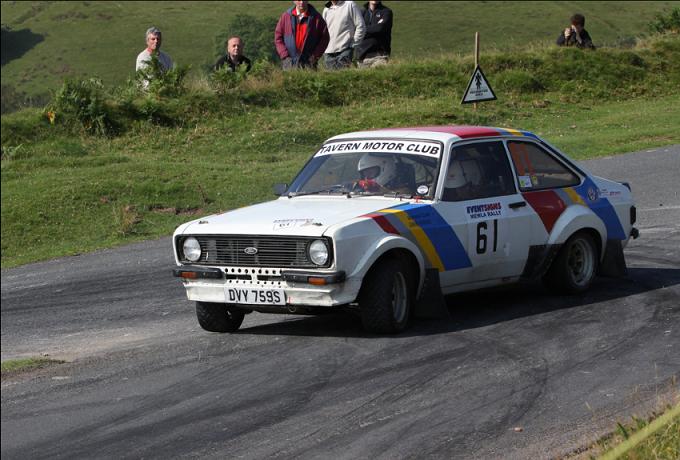

                            George and I were out on the Mewla in August - I'd last done this event in 2010 and it is always good to do some longer stages over Epynt
                            Weatherwise it was one of the best days I've ever seen over there, clear blue sky all day so no concerns over tyre choice
                            We did the recce the day before having bought Patterson Pacenotes, and Carrie and Guy arrived in the morning to service
                            Having done well on the Mini Epynt, we were slightly disappointed with our seeding (Car 61) and caught the car in front after 5 miles! After that it wasn't too bad, we didn't catch any for the rest of the morning. In service it was just a question of checking everything and topping up with petrol.
                            At lunch there was a nasty incident in the service area which resulted in the Air Ambulance being called - a Darrian had fallen off a jack and landed on one of their service crew resulting in a head injury, so he was airlifted to hospital (and later released with just a few scars). This resulted in a half hour delay on the 4 afternoon stages
                            The first afternoon stage was the longest on the event at 14.25 miles and we caught the car in front after 10 miles who pulled over quickly, then caught the car in front of that with quarter of a mile to go. As it was so close to the finish he didn't pull over so we followed him over the "Black Hut" jump at some speed, luckily he didn't back off and neither did I
                            The last lap went well although I wasn't much quicker than the previous ones despite not catching any cars
                            At the finish at Builth Showground we were pleased to finish 22nd Overall and 5th in Class, thanks to George for a great job on the notes and Carrie and Guy for looking after us for the day
