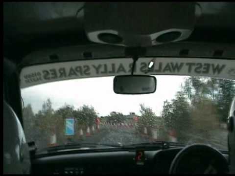

          It was drizzling again by now but I couldn't see the point in wearing out some wets so we left the slicks on and went out for a play. It made a nice change not worrying about the times, just seeing how sideways we could go
          In Car from Stage 8 - the clattering is a link bar dragging on the ground

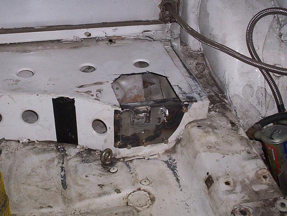

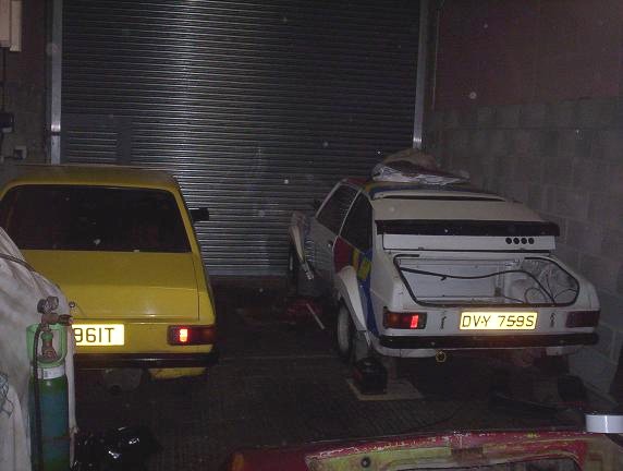

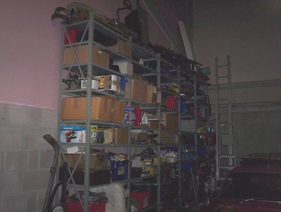

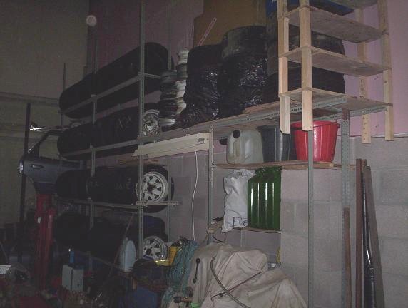

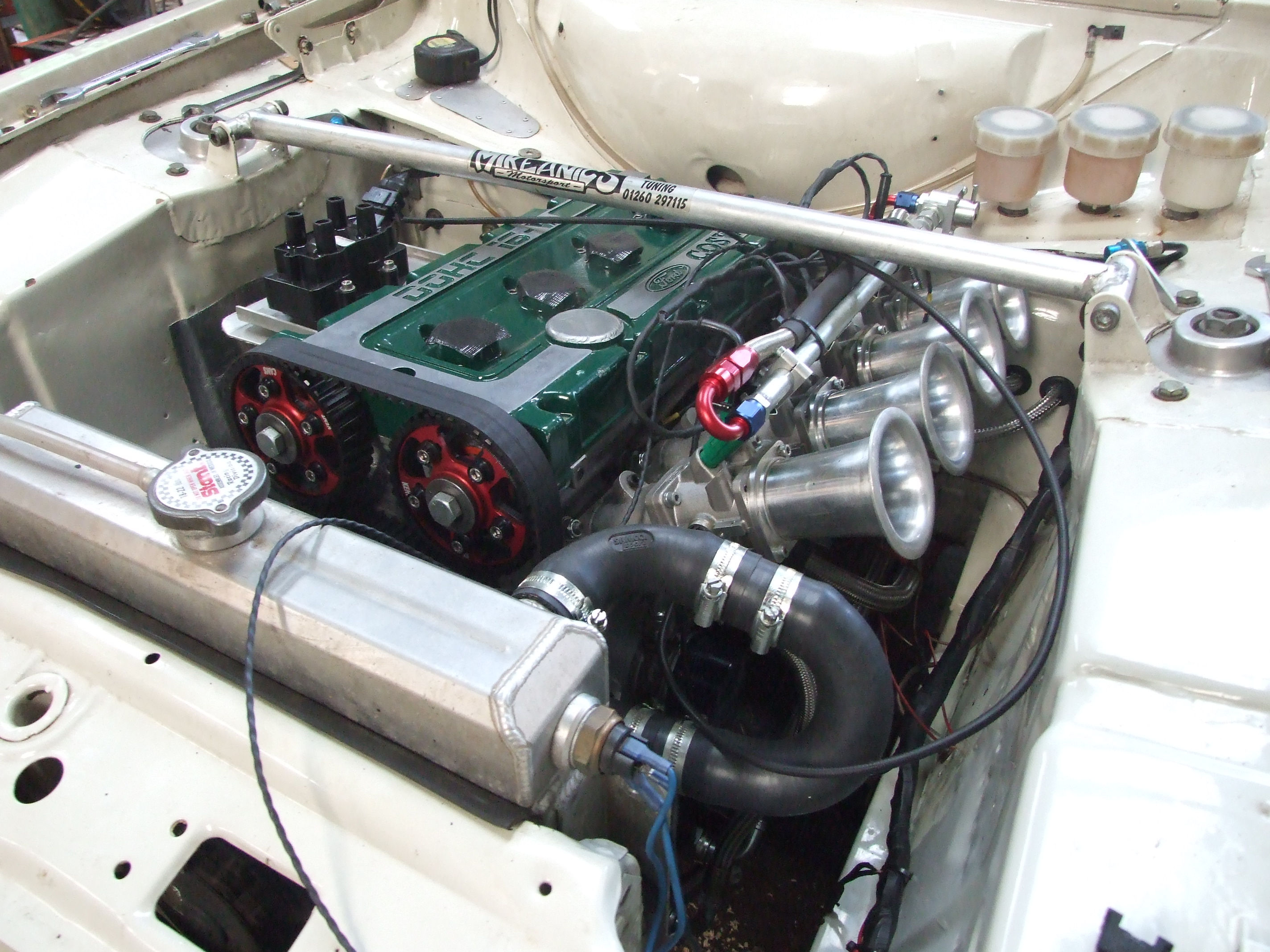

                          After spending about a month rearranging the workshop, building the shelves upwards, so I can fit 3 cars in there, including my winter project
                          Today I made a start on DVY's winter mods...
                          Cut a small hole in the tank platform and made up a plate to cover it

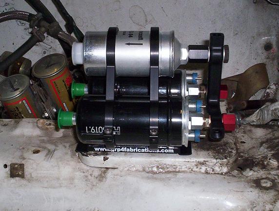

                          Fitted the pumps and filter into a rather nice mount from GRP4 Fabrications

                            #298
                            Looks like you are going to fuel injection and the mystical black box then....Damn - Ithought that was my one advantage!
                              #299
                              Hi Steve,
                              That's the plan - it's something I had planned for the end of last year but gearbox problems got in the way
                              Is yours back together now?

                                #300
                                No, it's still in bits. I am hoping for some progress soon but can't say too much at the moment. Which throttle bodies/management are you going for? Brilliant thread by the way. Cheers, Steve.
