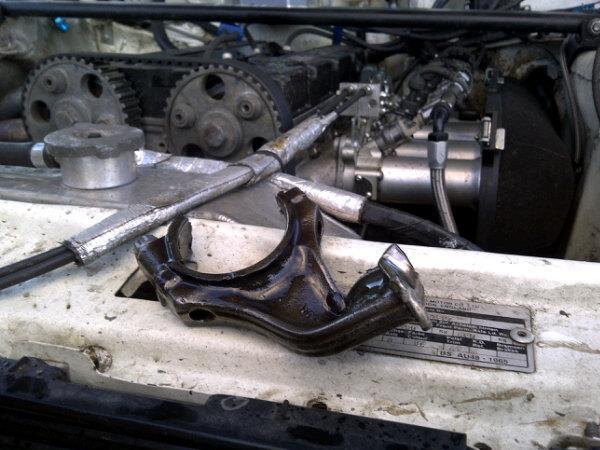

          We were now 62nd and headed off to Stage 7 for a second run through Ardfield hoping to make up a few places, but a couple of miles in a vibration started - difficult to tell if it was the engine or box - so we carried on but on an uphill section it suddenly got a lot worse, very loud clattering and soon the oil light started to flicker so we pulled up in a convenient junction. The marshal came running over to say we'd left a trail of oil behind us and I opened the bonnet fearing the worst, oil covering the sump guard by the starter and I could just about see a hole in the block behind the engine mount. A call to Carrie and Guy and they were soon on their way to rescue us with the Sierra. When they arrived Guy had a good look round and found this on the sumpguard

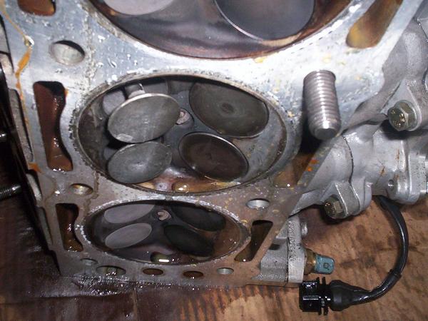

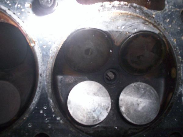

                  I had some spare time over the long weekend, so decided to take the head off to see how much damage there was...
                  Difficult to see in the pics, but all 4 valves on No 3 Cyl are bent, but at least they're not snapped and there's no noticeable damage to the head

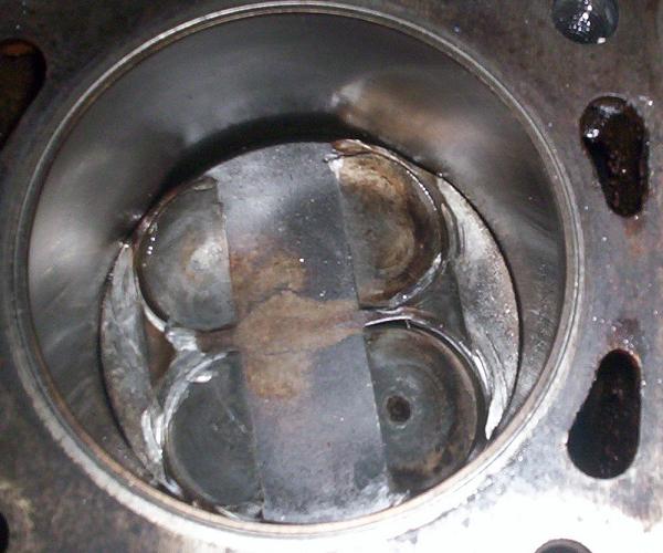

                  Piston twisted in the bore - I've seen a lot worse and it still moves freely

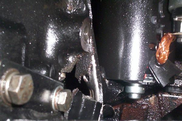

                  When the rod exited it took a little bit of the block, and even split the starter motor casing on the way past

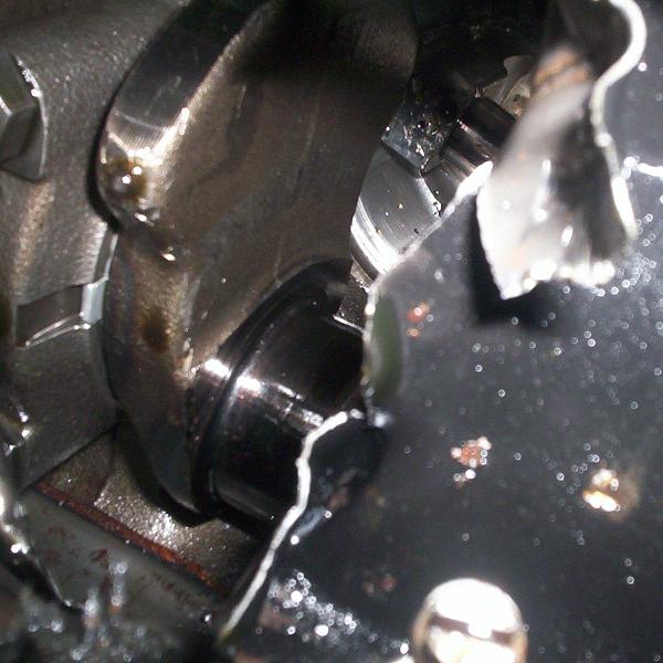

                  Not much left of the sump either
                  But the engine still turns by hand so maybe some of the bottom end is salvageable

                    What a nightmare Gavin - do you know what would have caused the failure? Will you be rebuilding it yourself or taking it back to HT's?
                      #400
                      We think a rod bolt let go first and everything followed from there
                      It'll be going back to HT - in January Ron suggested it might be an idea to change the rods as we couldn't remember the last time they were renewed, they definitely need doing now

                            Any idea what caused the failure. Did you loose oil pressure or anything obvious
                              #404
                              crank journal looks fine so i'd say either a rod or rod bolt failed through fatigue
                                #405
                                My theory was a rod bolt snapped as the threads of one was left in the big end cap. Ron had a look and said sometimes the bolts stretch which may have been the vibration which I felt just before it let go. But the head is undamaged, just some bent valves, so that's a bonus
