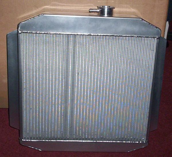

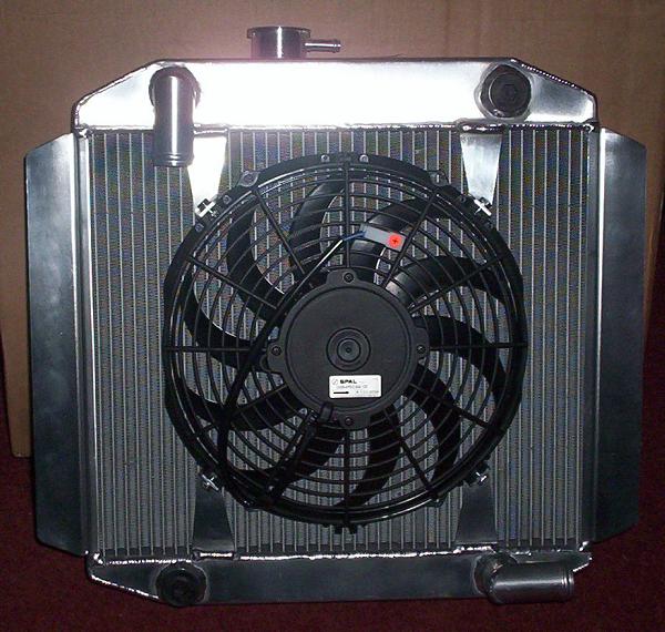

            I arrived home tonight to find something rather large and shiny waiting for me
            Shouldn't have any trouble with overheating now, I just hope I can squeeze it in as it's a 60mm core...

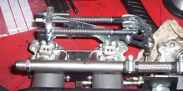

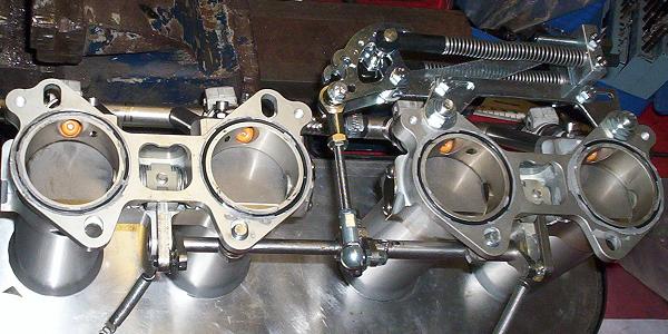

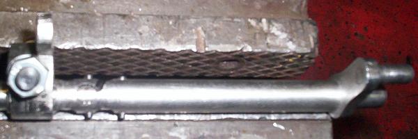

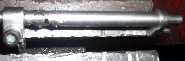

                    Since I've had these throttle bodies, I've had a few problems with the linkage and the balance bar slipping. AT Power are going to send me their new design of a slotted tube instead of the current holed tube, but as the balance was fine at the end of the last event, I've drilled and pinned the current bar. I was only going to use one pin but found a couple of cracks (highlighted in black) so added another one
                    I've also bought a Jenvey Throttle linkage with their DCOE mount (from Balance Motorsport who were a lot cheaper than anyone else) and it fits perfectly with a longer rod between the ball joints

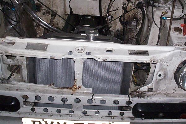

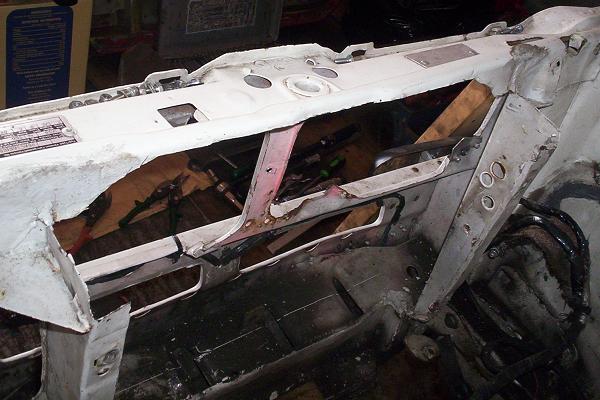

                    Today I had a look at fitting the rad, without the engine I had to take measurements from Fly and decided there's no way it would fit on the normal mounts without fouling the water pump, so it needed to sit further forward. Trimmed the slam panel first

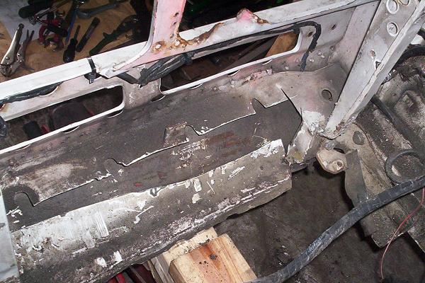

                    Then removed the rad cut out and folded the rest flush with the front panel

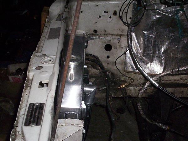

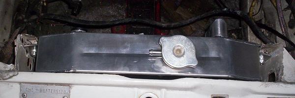

                    After a bit of trimming to the radiator sides, it fits perfectly about 20mm in front of the rad mounts and this should give plenty of room for the fan

                      what size fan did you go for gav?

                        It's just what Radtec supplied with the radiator, I decided it was easier and would be properly mounted, it's a 12" SPAL fan

                          Good choice on the setup Gav
                          That's pretty much the same setup as mine, 60mm core rad and a 12" Spal fan, both Midsummer Caerwent and Richard Burns were very hot, especially Caerwent and it was good as gold.

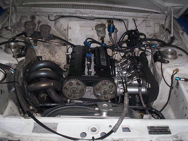

                            Engine back in and running, started first time
