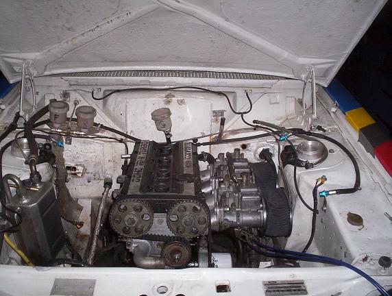

          10 days to go until I catch the ferry for West Cork and Ron had finally finished rebuilding the Cossie
          When I'd picked up Fly's Pinto, it was all stripped and the head had been sent off for some new valve guides to be fitted (I don't remember this being done since I've had DVY) which delayed everything slightly, then Burton's had the piston rings on back order (my 90.93 pistons which make the engine 1999.7cc are quite rare now as it's so hard to find a block good enough to build a proper 2 litre engine) but Ron had sourced some in Germany and had them shipped over this week
          This morning I collected it and this is how far I got this evening
          It went in quite easily despite the gearbox being left in, hopefully she'll be running tomorrow night

              Sunday I finished the engine bay off then Monday night swapped the fuel tank back from Fly and left the dry sump tank draining the old oil
              Tonight filled with fresh oil, fitted the battery, checked the fuel system, got some oil pressure with the electric drill and an old dry sump pump belt, and after a bit of cranking she was running
              Let her warm up for a bit and checked for leaks (couldn't see any) so switched her off and called it a night

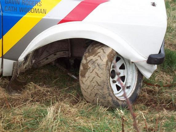

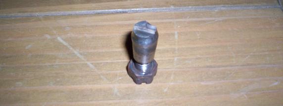

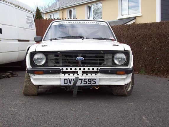

                        I looked under the front panel and the TCA and compression strut were on the ground – the bottom ball joint had sheared off
                        I signalled to Cath that we weren’t going any further so she got out the OK board and showed it to the next few cars until I stuck it on a handy fence post. The gateway led onto a track where a farmer and his son were spectating and they said that the track went through their farm and down to a public road and that we could bring the trailer up there. So I phoned Carrie to explain what had happened and where we were and about an hour later Carrie and Guy turned up with the trailer. Before this we had all the course cars through for SS3 including the Motorsport Ireland Steward who decided DVY was in a slightly dangerous position so the organisers had to put some bunting round her before they were happy
                        We dragged DVY through the gateway, strapped the front strut straight and winched her onto the trailer, then watched the top 40 cars go past before heading back to the B&B.
                        When we got there, Cath headed off to the Rally HQ to put our entry in for the Sunday Run while Guy and I repaired DVY. I was a bit worried how to extract the remains of the ball joint, but Guy hit it with the large hammer a few times and it popped out, and everything was fixed by 2:30pm

                              How old was the bottom ball joint?
                              Maybe you should consider 'lifing' them, and replace them every year?
                                #240
                                We had the same conversation after it broke and I realised it was on DVY when I bought her in '97, so was probably a new part from Gartrac when she was built in '93
                                I've never had a ball joint shear before in 20 years of rallying, on Fly the ball joints get worn and fail the MOT every 4 or 5 years depending on how many events I do
                                But as the other side is of the same vintage, a large package arrived from Gartrac yesterday with a new pair of genuine Ford adjustable TCA's - I'll change them in 10 years
                                I don't think there is anything else on DVY that hasn't been replaced over the years, or rebuilt recently
