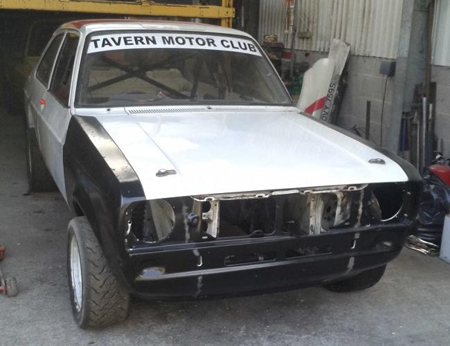

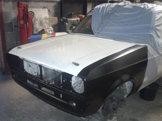

        Made some progress over Christmas, bolted the front wings on to line up with the bonnet, then bolted the front panel to the wings and welded the front panel to the inner wings

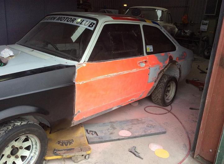

        I've repaired the passenger door pillar and tidied the door up, just got to do the same on the drivers side (which will take longer as it's got a lot more rust)
        Just over 2 months to Ireland so it's got to be finished by then

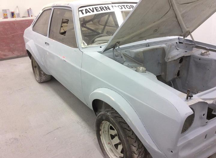

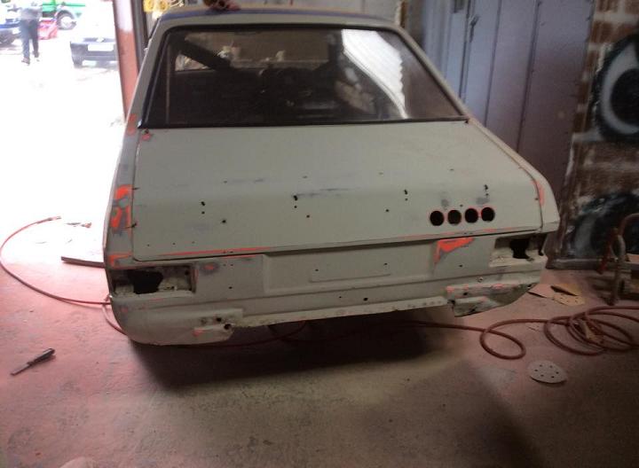

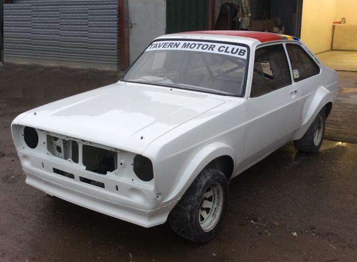

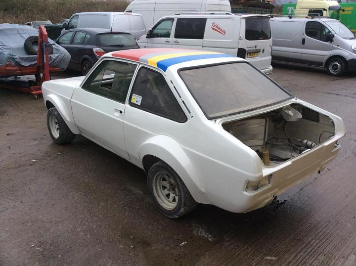

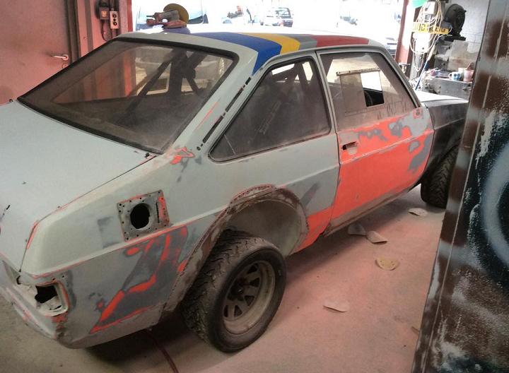

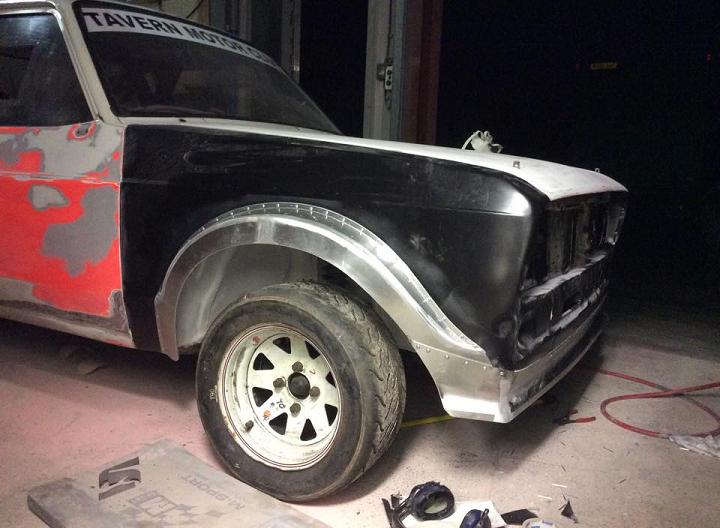

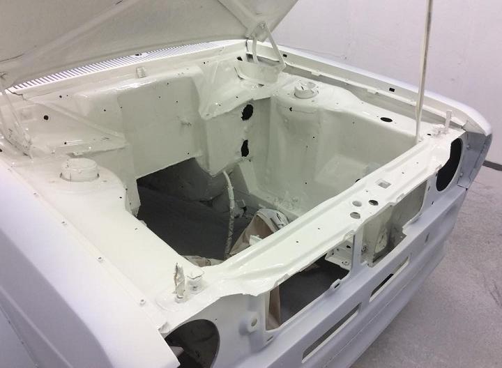

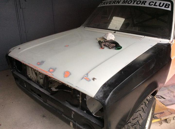

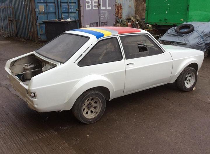

                Two weeks ago I'd finished everything I wanted to do before she went off to paint
                In progress
                New Ralloy arches and spoiler
                1st cost of primer

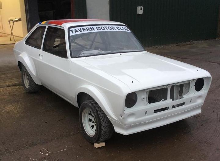

                Got the engine bay done as well
                Lovely and shiny
                Many thanks to James (Oddy) for his hard work and getting it done in two weeks
                The spray booth is a great addition to the business
                Just over 5 weeks to get everything refitted and catch the ferry

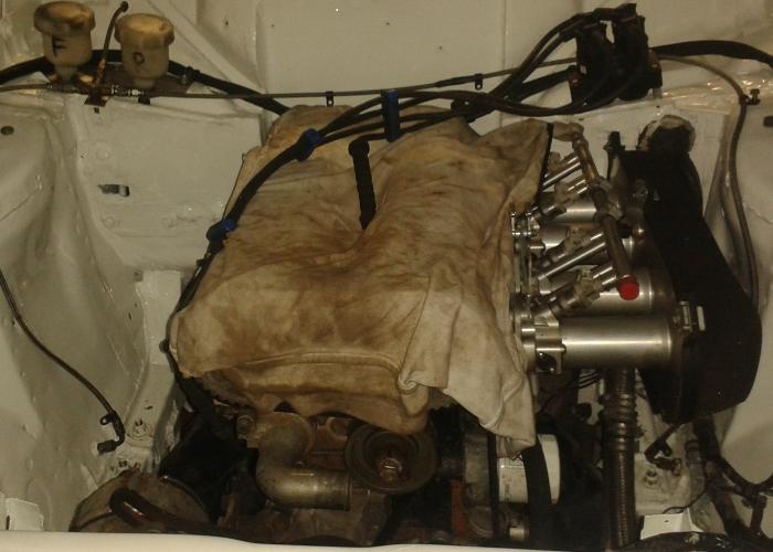

                    My friend David came over today and we fitted new TCA's, track rod ends, compression struts and started putting the engine bay back together - brake reservoirs and pipes, wiring, extinguisher nozzles, oil pipes and dropped the engine on it's mounts...

                      David came over again today and we got the engine bay finished and had the engine running for the first time since last year's event

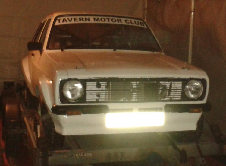

                          All loaded up ready for West Cork - working the next 2 days then leaving Wednesday morning
                          I took a trip to Melvyn Evans on Friday to get all the wheels pointing in the right directions - after changing the axle (swapped the F/F from Fly as I did last year) and fitting new TCA's and comp struts both sides I didn't know where to start. I went for a quick drive yesterday and she feels good.
                          Just a couple of jobs left for the service crew (Richard, David and Carrie) to do on the Thursday - add the stripes/names and mud flaps and finish bleeding the brakes
                          We're seeded at 98 in a full entry of 151 cars including 55 Escorts in the main field
