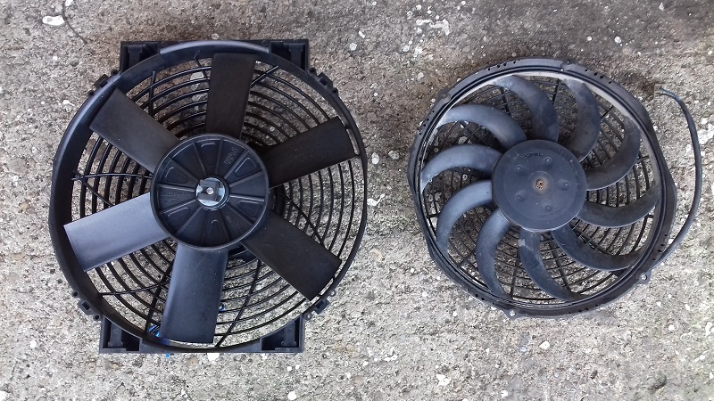

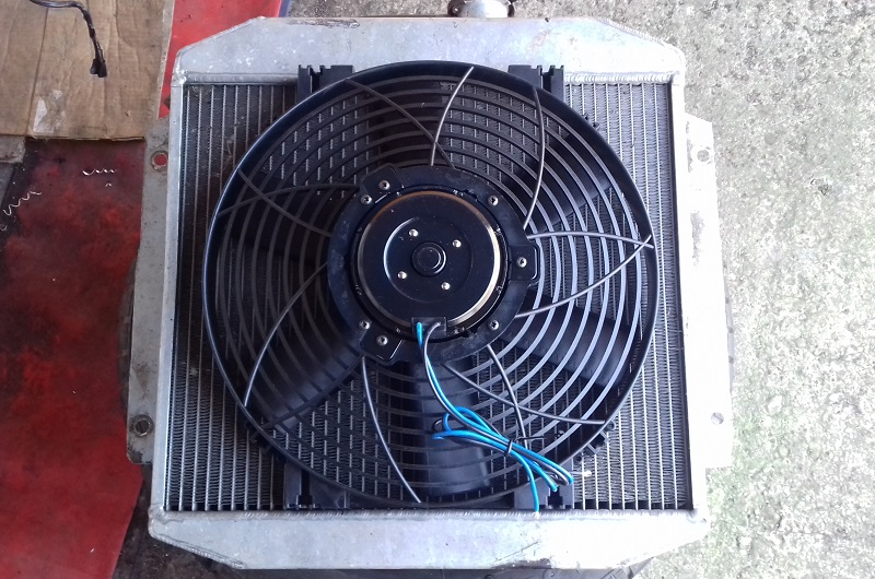

                Back in March I got round to having a look at improving the cooling on DVY, as recommended by John at JPR Tuning when I went to his rolling road last summer
                When I had bought the alloy radiator a few years ago, it came with a fan and I assumed it would be the right size, but maybe it was the one they could fit with the pipe orientation I had requested
                Anyway, when sat idling the temperature would steadily increase and overheat, which is not ideal on a rally car!

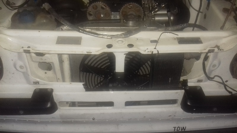

                After removing the rad and fan I took a few measurements and decided I could fit a 14" high power Davies Craig fan, which actually measures 13.8" and is rating at double the CFM of the old one
                To make it fit, I had to mount it in front of the rad (which was where DVY's original fan was) and cut some of the front panel away, and move the oil cooler to the outside a bit more
                I used 2 lengths of 25mm ally angle to mount the fan, bolted across the radiator supports and everything fitted nicely

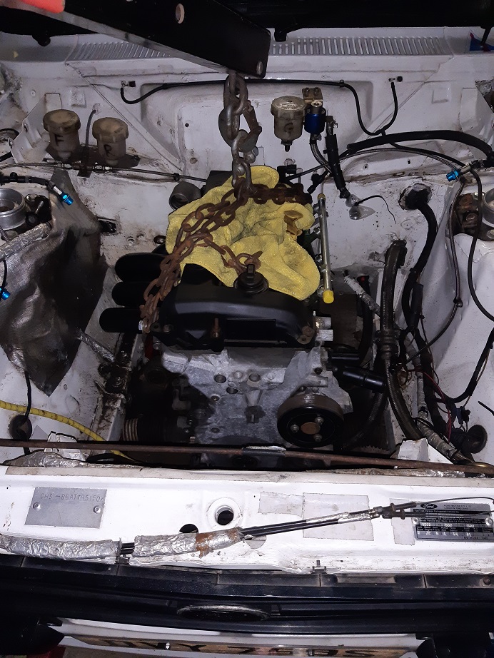

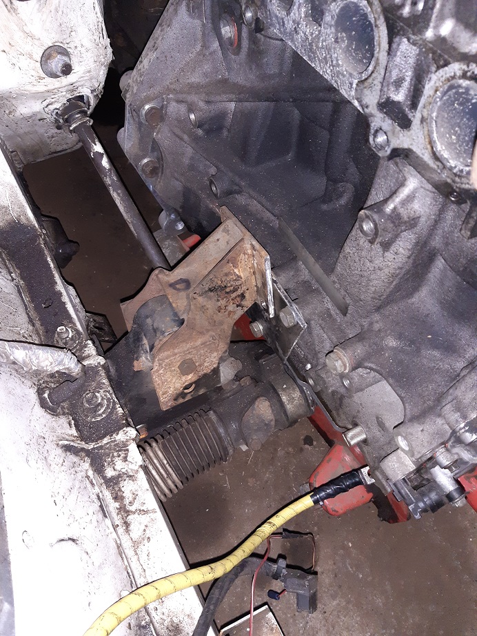

                                First trial fit with engine position being determined by the gearbox mount and getting the engine as low as possible above the steering rack / cross member

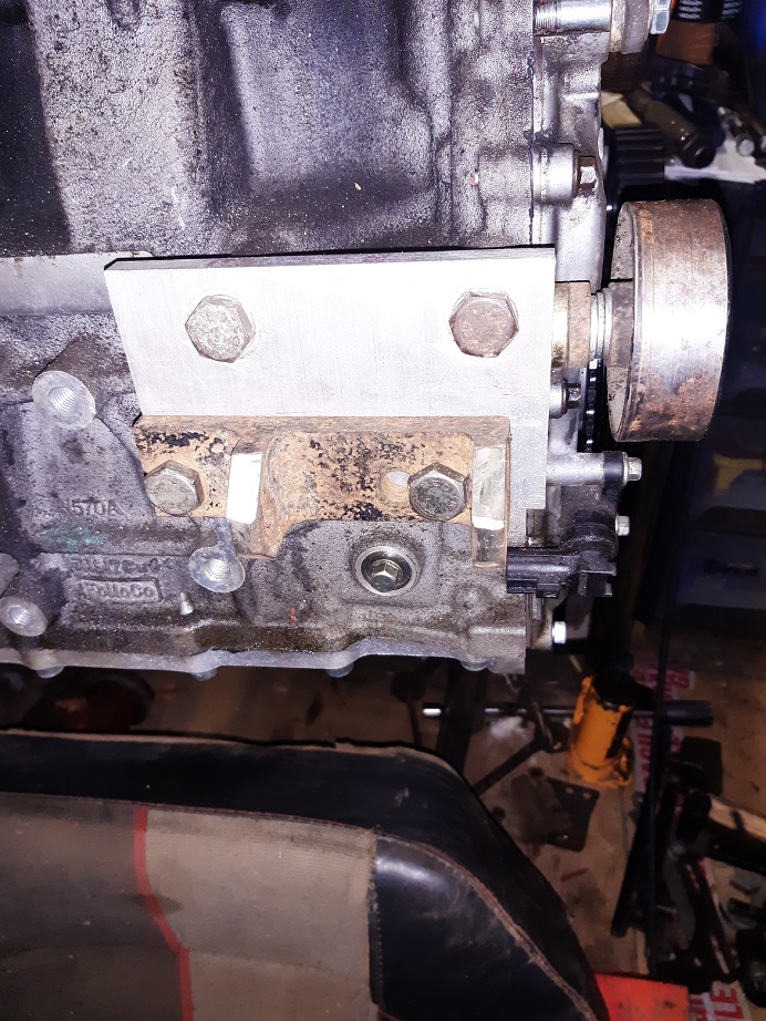

                                Engine mount plates were made from a scrap piece of 8mm plate

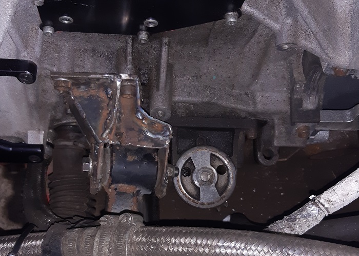

                                I started with an old set of WCXM engine mounts that had previously been modified
                                Drivers side looked simple, the passenger side needed about 1" cut off the end

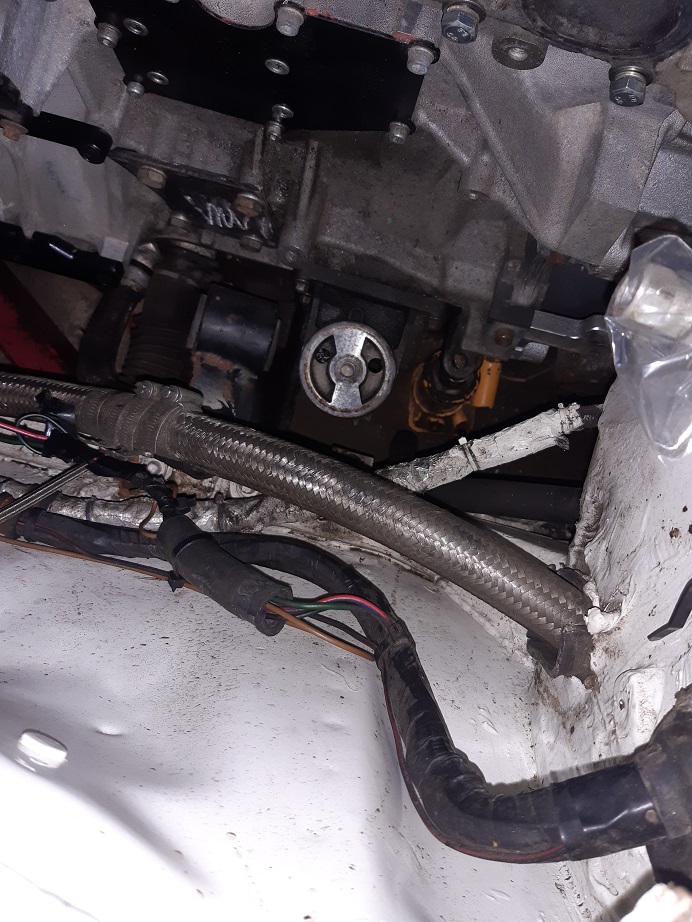

                                I also wanted to try and use the standard Fiesta ST oil filter plate, rather than the "oil in" plate which came with the dry sump and would have needed a remote oil filter
                                The plan of making my own mounts was so I could work around these bits - passenger side completed
                                The long bolt cannot be removed without removing the dry sump pump, but I'm not planning on taking the engine out regularly!

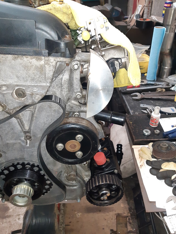

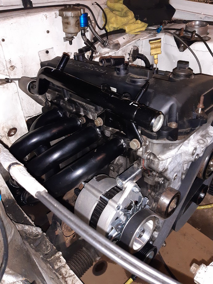

                                Alternator set up from the kit with the Ranger water rail fitted
                                I didn't like the height of the water rail compared to the radiator, so I removed the bend and straightened it out which also removed the 5/8" outlet near the back

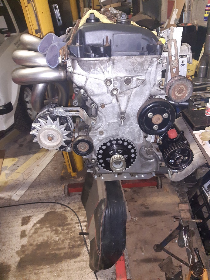

                                New alternator set up, after looking at various pics of how other people had done it
                                Looking through the scrap box I found a std xflow alternator bracket and some 10mm ally plate so put the alternator where I wanted it to go, low down on the drivers side under the exhaust
                                A few brackets to work out where the second idler pulley needed to go, and an old alternator mocked up with a transit diesel adjustment bracket which had the right offset
