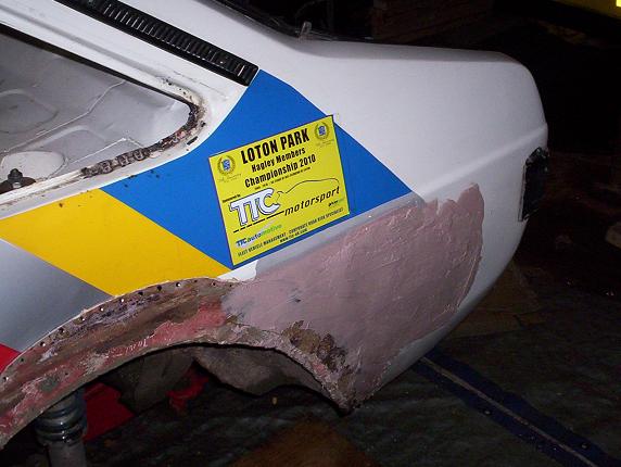

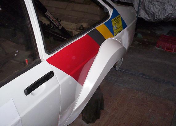

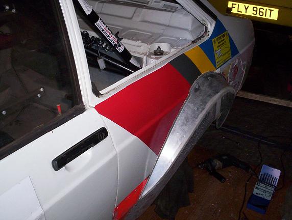

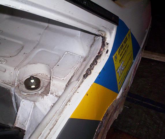

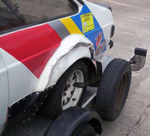

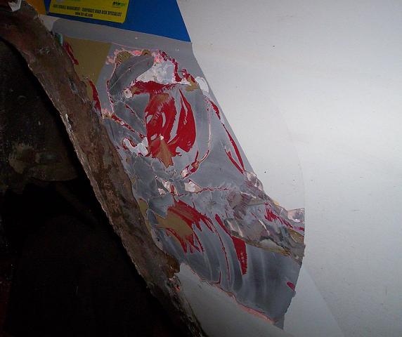

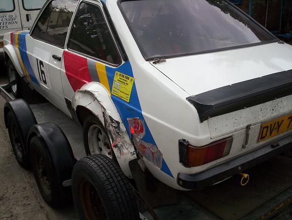

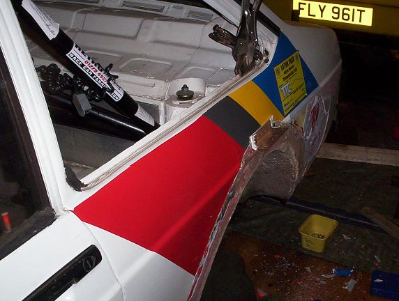

        A few pics taken when I got home - the black mark is from the Impreza's front tyre

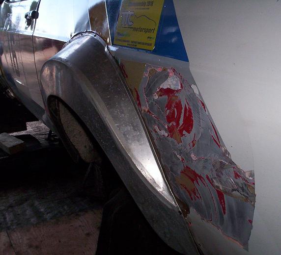

        Back in the workshop, removed the old arch and side window, hammered it as straight as I could and pulled the quarter panel out
        With the window out I could that the seam had split so this had a few spots of weld

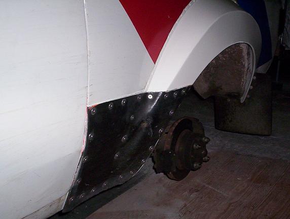

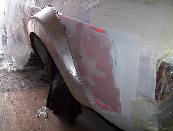

        Trial fitted the new arch - luckily I had a spare one for this corner
        Loads of filler

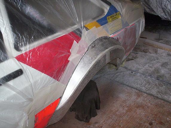

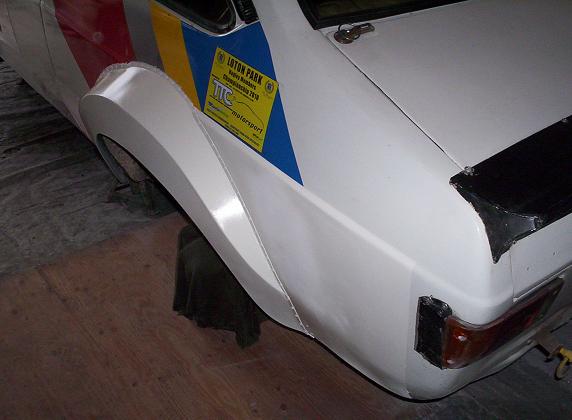

        After a lot of sanding and about 50 rivets the new arch was on today

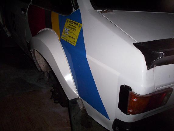

        Some more sanding and 3 coats of primer, top coats will go on tomorrow

                All finished and ready for tomorrow...
                Paint
                More paint
                Arch guard
                Stickers and mudflap and repainted the light guard
