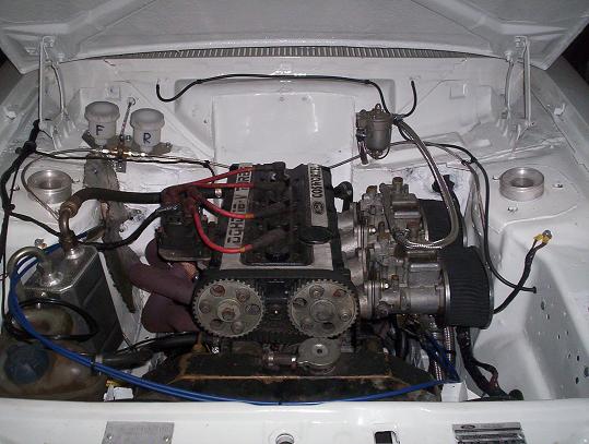

    Got some more done over the New Year...

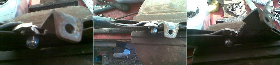

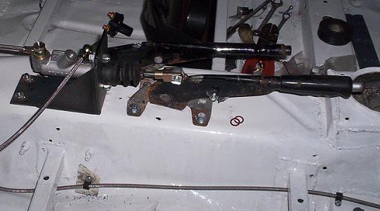

    Made another Fly Off Handbrake out of a standard one and a small bit of 4mm plate for the locking mechanism (the standard part is too hard to drill through)
    Bolted it inside with the hydraulic cylinder and the other handbrake

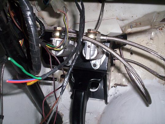

    And the pedal box (thanks Clint ) now fits perfectly after jacking out the dent in the bulkhead, so the brakes are all plumbed in now

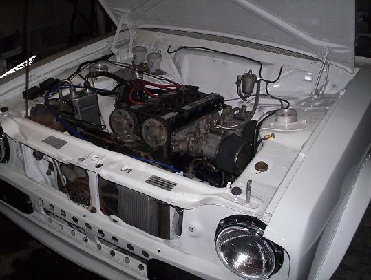

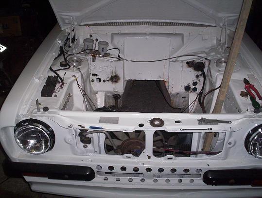

    And I spent a few hours drilling holes in the engine bay so everything fits in the same place and I fitted the air horns & electric fan - wired them up and they work , bolted the reservoirs in place, cut a large hole for the throttle cables, fitted the ignition modules that trigger the coils and the headlights are in as well

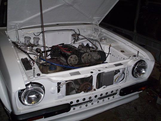

          Sunday I decided I would start at the front and work through to the back of Dvy, finishing everything as I went
          So now the engine bay is 99% finished, just needing to seal the bulkhead where the oil pipes pass through and run the large cable to the starter, fill and bleed the brakes, but everything else is done, even the rad is full of antifreeze
          The interior still needs some work - pedals, gearstick, gauges, cut out switch, seats, harnesses, etc
          And the boot needs a bracket for the dry sump tank, the battery and the fuel tank from Fly

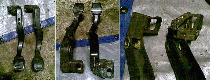

                I was going to put Fly's clutch pedal in Dvy but I'd been worried for a few events about it twisting as I press it, and the new pedal box had come with a brand new clutch pedal, so I started with that and fabricated an identical one - they're offset so the clutch cable runs inside the manifold and doesn't melt
                I also filled the brake system with fluid and pumped the pedal until fluid came out of the bleed nipples and left it like that, just need to do it properly when everything else is done

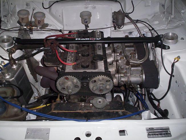

                    The plan for this weekend was to get DVY running, and at 8pm tonight she was running
                    Still got a long list of jobs to do before Goodwood and a few evenings work this week before the MOT next Saturday
                    Finishing touch to the engine bay - a nice Ralloy strut brace

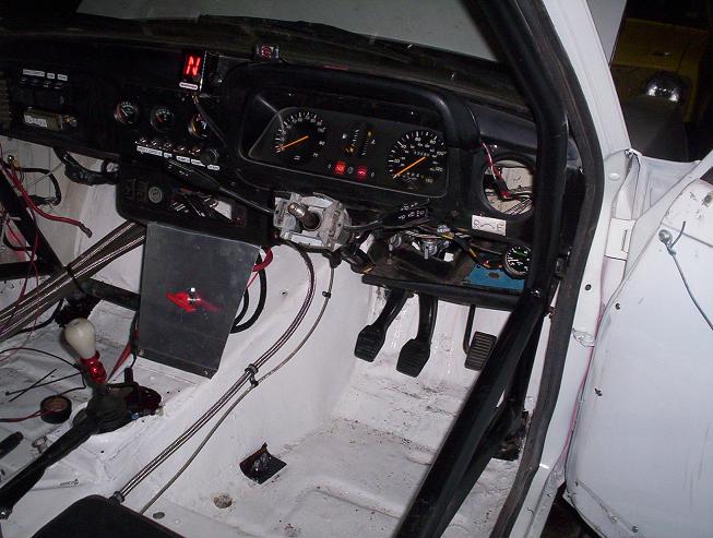

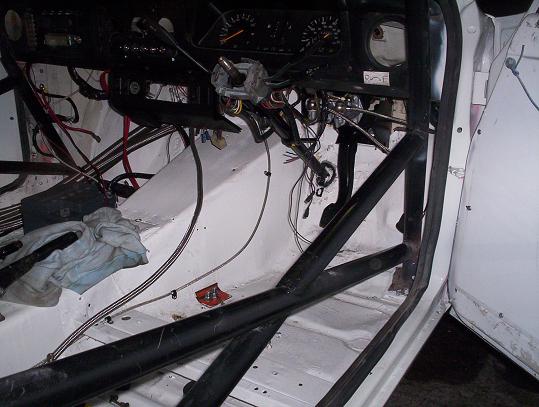

                    A lot of progress inside - fitted the extra gauges, made a panel for the cut out switch, clipped the fuel pipe and battery cable to the tunnel and fitted the gearstick and display. The seating position needs a bit of work though

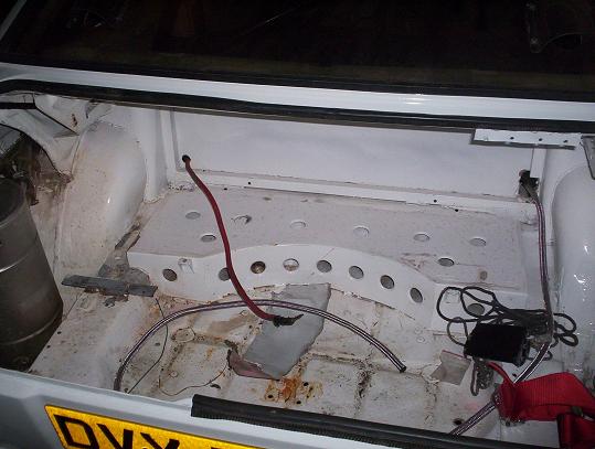

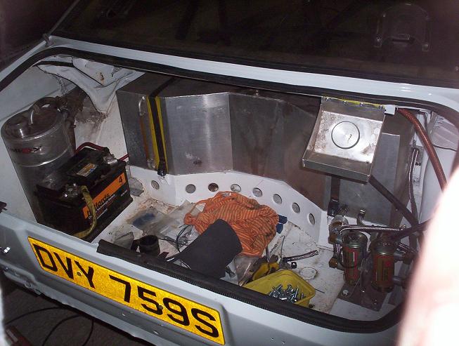

                    And the boot with Fly's fuel tank and pumps, mounted on the tank base that Rupert had fitted. Battery needs bolting down and a bracket making for the dry sump tank

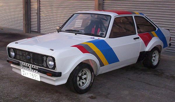

                        After a busy week, DVY was finally ready for the MOT so I trailered her over to Melvyn's and she passed without any trouble
                        Then I went to see Carrie and Guy who spent the rest of the day helping apply the stripes and we got both sides done
                        Back home today I did the roof and took some pics and DVY now looks like DVY again, not just a plain white Escort
                        Still a few jobs to do before the rally, including lowering the rear by about 3" and the front by 1", and David might appreciate a seat as well
