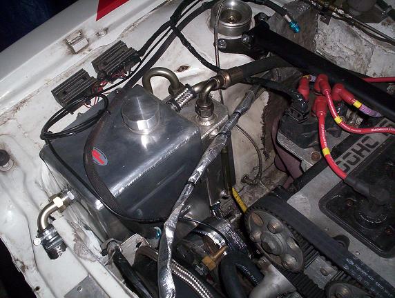

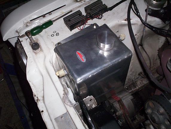

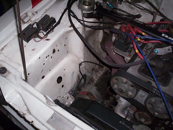

          1. Empty engine bay of everything not that important (expansion tank, catch tank, air horn compressor) and reroute wiring out of the way

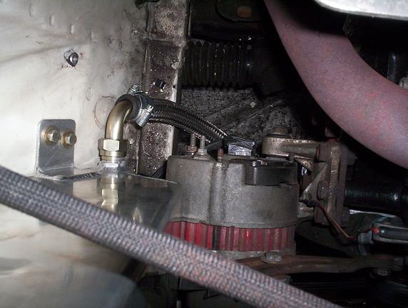

          2. Fit dry sump tank, bought from HT 18 months ago
          3. A bit tight to the alternator but I can get my fingers in between

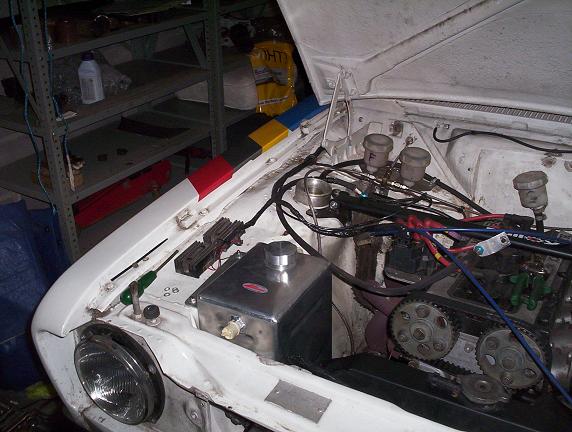

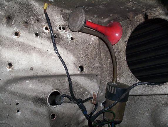

            A bit more progress today - air horn compressor mounted in wheel arch

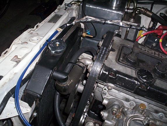

            As the tank has 5/8" BSP connections and my current system is 3/4" BSP, I removed the rad to access the oil cooler and swapped this for one the same size but with 5/8" connections
            Cut the slot in the slam panel and routed the first pipe
            More to follow this week - I want to be out testing next weekend so I can make sure it all works before Loton Park the week after

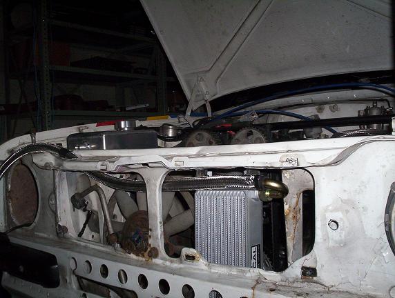

                More progress today

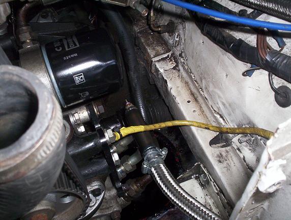

                Feed pipe installed

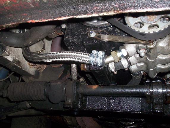

                Twin scavenge into a single pipe to the oil cooler. Bit of a tight fit so I moved the pressure pipe and sandwich plate round. As there's no fitting for temperature in the tank, the sender is mounted at the back of this union. Hopefully it'll be immersed in oil all the time
                Catch tank squeezed in next to the oil tank, I could do with a smaller one but it'll do for now. And some heat shield round the alternator and throttle cables
                Radiator back in, no expansion tank anymore so I've connected the water pump back to the cylinder head
                Just got to fill with oil and see if everything works

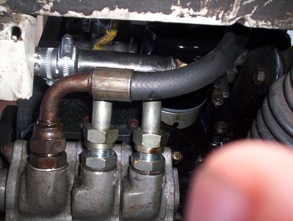

                        Got down to the workshop today, filled her up with oil, no leaks, started her up, dripping from the oil temp sender
                        Took the union off, covered the nut I'd welded on with even more weld, squirted some 3-in-1 oil into the union, covered the holes and blew into it - no leaks this time
                        So all back together and running sweetly. Oil warms up after a few minutes (used to take 10) so I went for a drive, did about 20 miles, some fast some slow, no problems though except for some water coming out of the radiator overflow so I'll get a higher pressure cap
