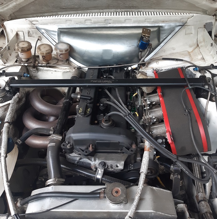

        While I am waiting the official guidance from MSUK, I thought I would look into what I can do to put the bulkhead back to a more standard profile.
        Although the Duratec fits with the current bulkhead recess, the exhaust is very tight between the chassis gusset and the steering column, the water elbow is almost touching the bulkhead at one point, and the air filter is tight against the bulkhead. In front of the engine, there's plenty of room to move the whole engine forwards by at least 1", so that's a start and will mean any bulkhead recess would be a lot smaller if one is required.

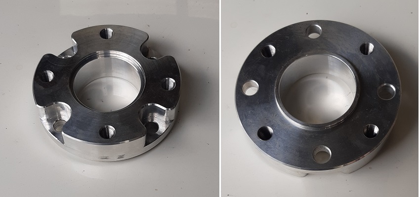

        The engine and gearbox mounts shouldn't be too bad, and the gear stick hole is already enlarged forwards from when I had a sequential gearbox, the engine plumbing and wiring will all work, which just left the propshaft. After a bit of googling, I found this 1" propshaft spacer from Grp4 Fabrications.
