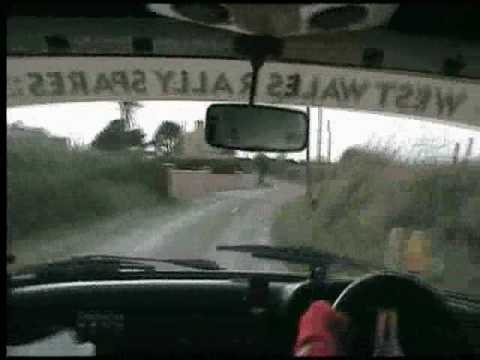

      In car from West Cork, first one starts off a bit slow, but the other's look good - I think the camera movement makes it look quicker
      SS11 - Rossmore
      SS12 - Sams Cross
      SS13 - Ardfield
      SS14 - Hayes Cross

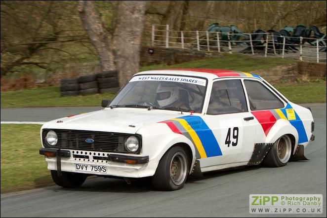

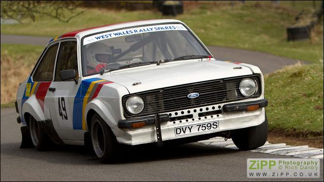

            A couple of pics from the Monday
            Coming out of Triangle - maybe 20psi in the rears is a bit too low
            Keepers Corner

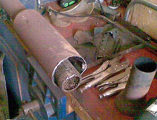

                  Not much to do on DVY except for sorting out a quieter exhaust (last year's is on Fly) and try and work out why it rattles a lot on the overrun

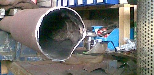

                  So yesterday I took the rear box off and welded a bigger silencer in, but the old one didn't rattle so I checked the centre pipe by pushing an old broom handle up it, and felt some resistance, so I took it off and it was rattling badly from the Cherry Bomb
                  A few minutes with the angle grinder and I could see the problem
                  Not a lot of wadding left in here

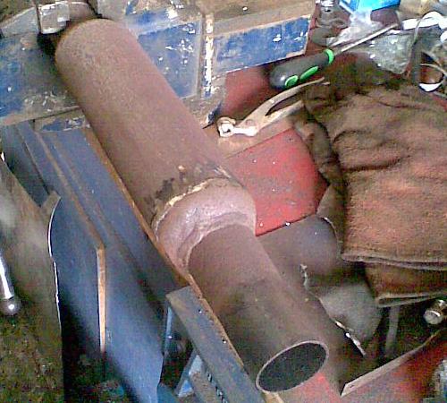

                  20m later I'd cleared the inside and welded the end back on
                  I'll try and get one next week but if I don't this one can go back on, she's quiet enough with the rear silencer so I don't think it'll make much difference
