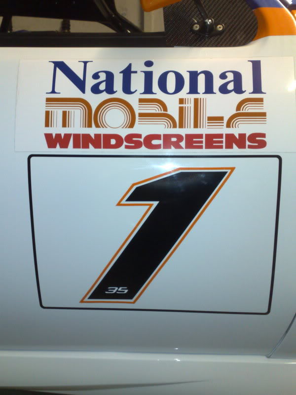

    As I'm number 1 this year I thought I should push the boat out and have a fancy number too!

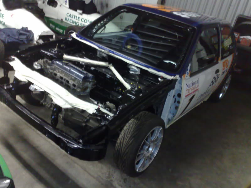

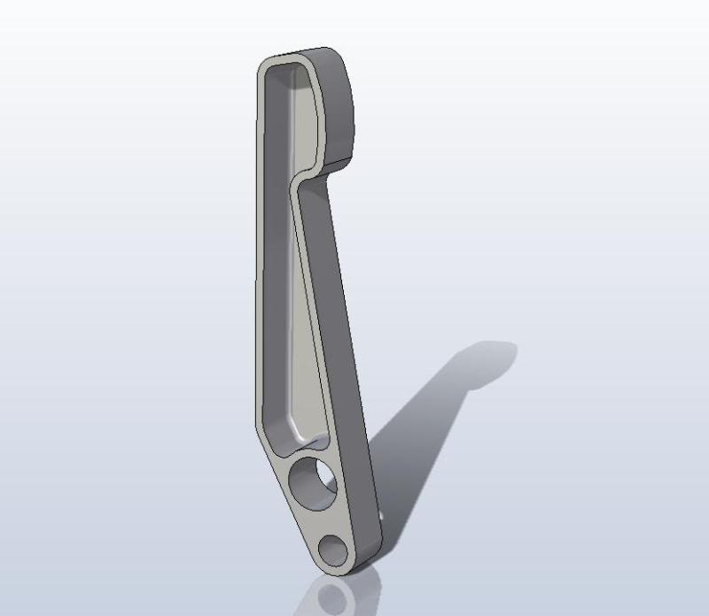

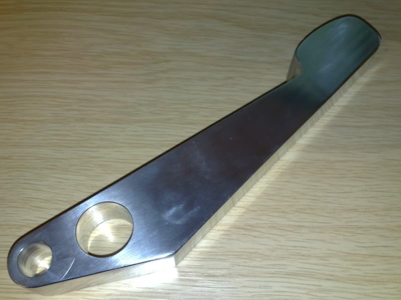

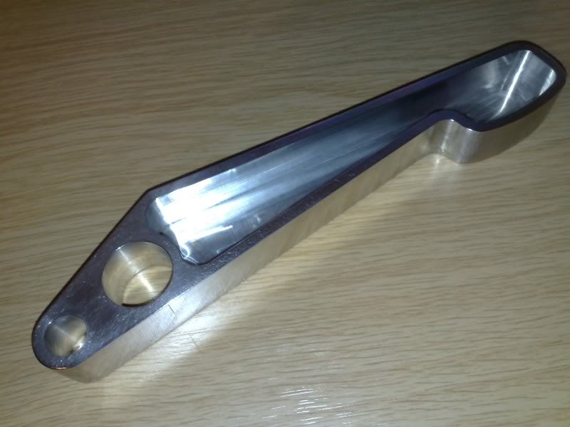

                Few pics of the new brake pedal.
                Car has had all the graphics done now. All windows and seals fitted. Stripped off most of the body panels so they dont get scratched during the rest of the build!
                Also hooked up an empty engine and gearbox casing and shipped it off to have a custom exhaust manifold made. Pick the car up later in the week.

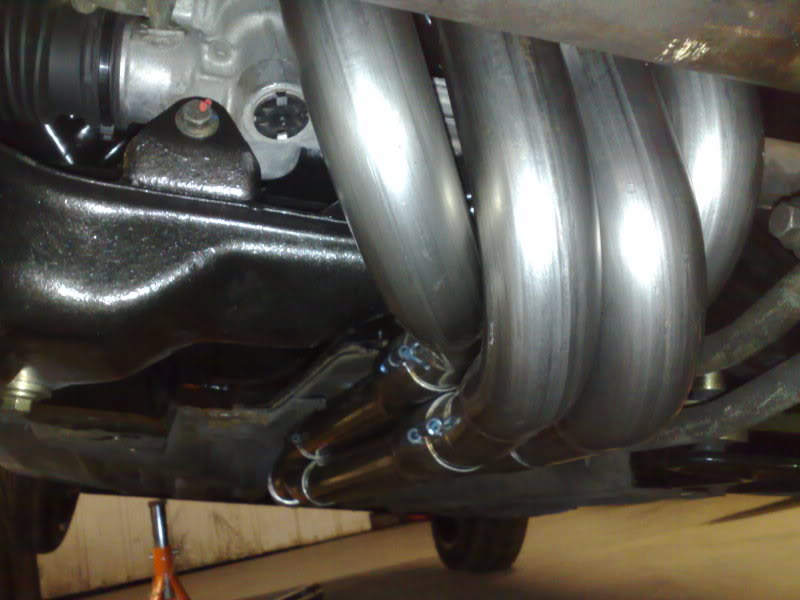

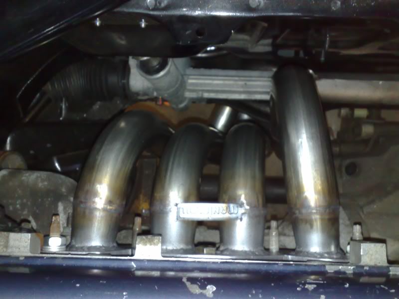

                            #148

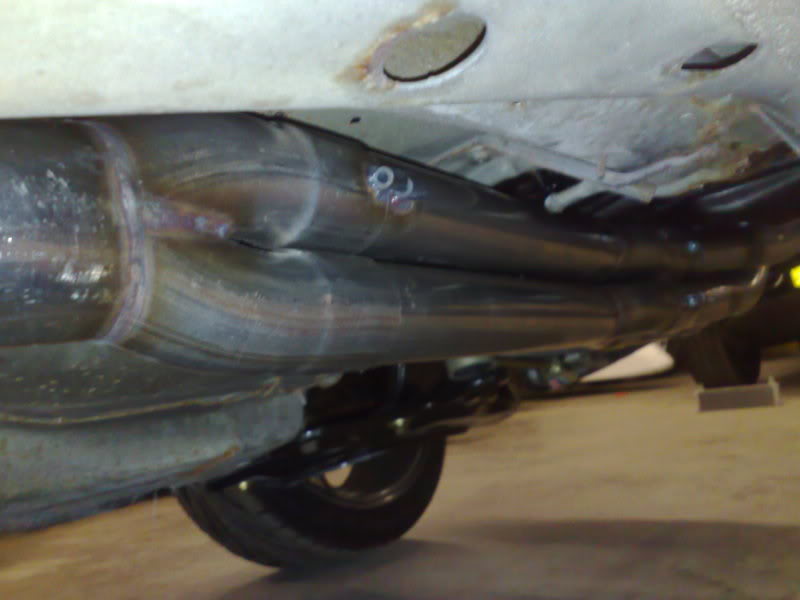

                            Picked up the car from maniflow yesterday. Done an awsome job on the manifold, very impressed. Will get some better pics when I remove it from the car.

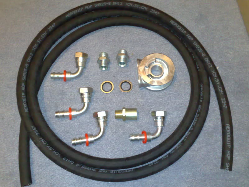

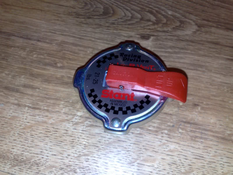

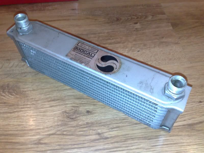

                              #149

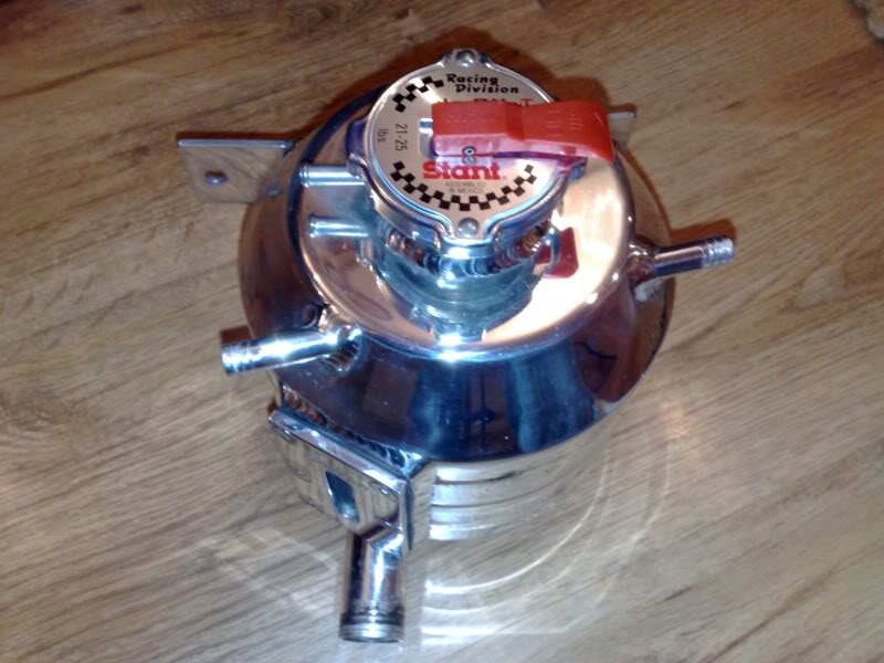

                              New higher pressure header tank cap, with lever pressure release.
                              On newly polished header tank.

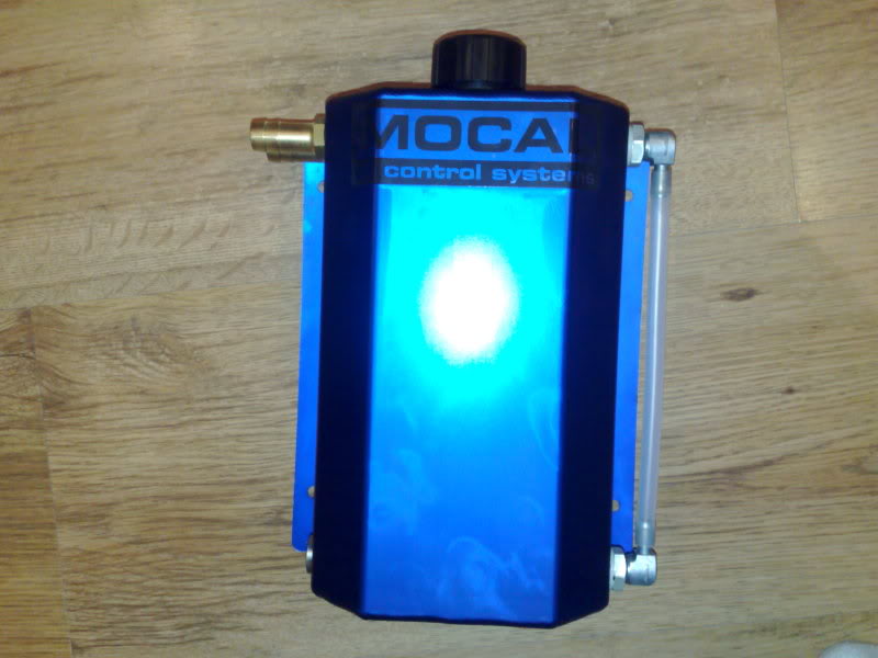

                              Mocal oil cooler
                              Take off, fittings and hose.
                              2 litre Mocal oil catch tank.
                                #150
                                It all looks very very nice! Especially that manifold! How long did it take to be made? Is it mild steelor stainless?
