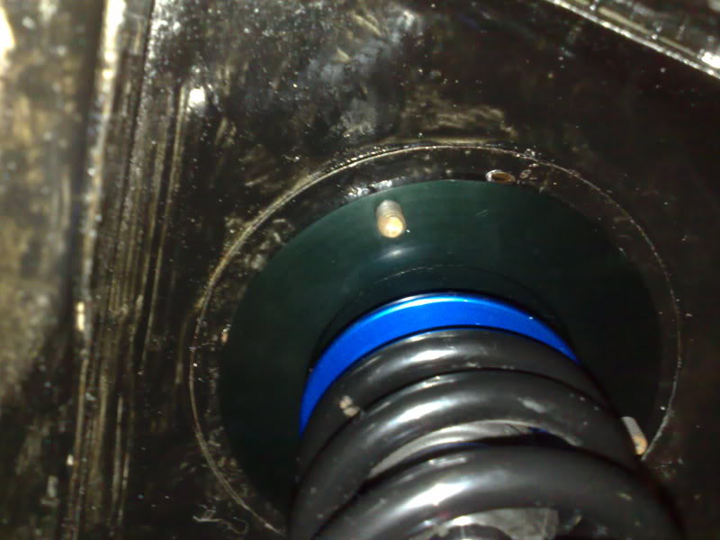

      Originally posted by Adam B

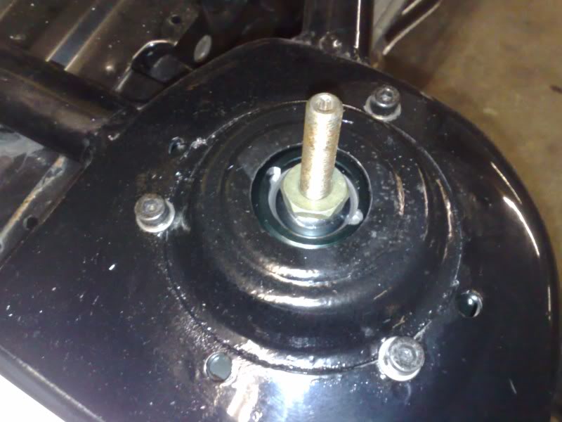

      hey mate, whats the score on the rear top mounts?
      I'm fitting mine tonight or tomorrow, if they fit ok I can get some more made. I will pm you for details.

        #123

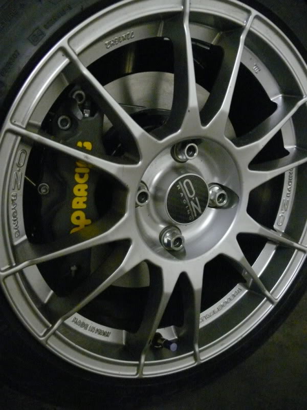

        I will let the pictures do the talking . . .

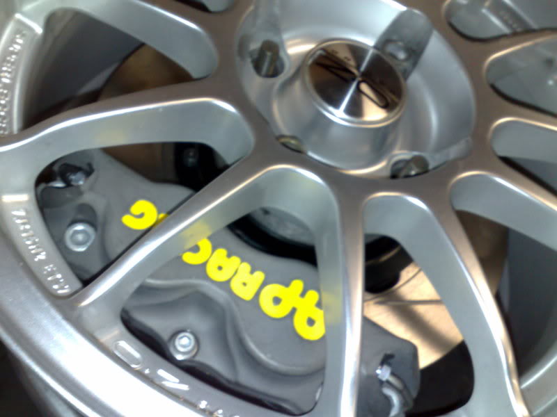

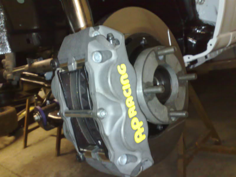

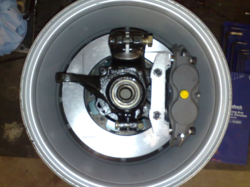

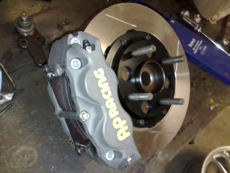

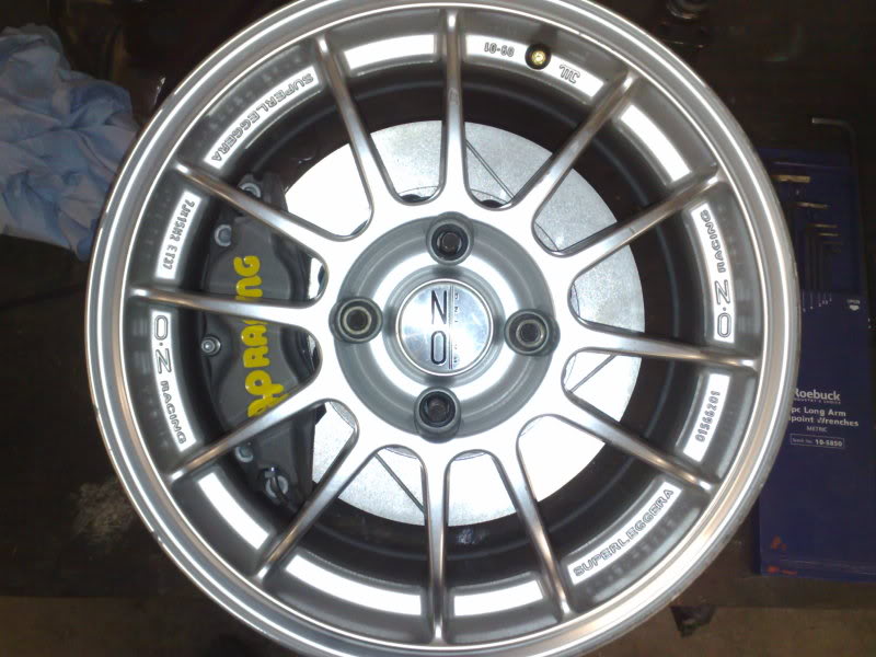

          Should be able to do a stoppie now with those brakes on the front. Mahoosive.
          How much weight have you added, through the larger disks and bells and all the other stuff?
          • jason33
            • Jul 2009
            • 174
            #125
            The rotor and bell combo is 1kg lighter per side than the single piece disc I had last year, even though I have increaced the disc diameter by 10mm and is 4mm wider. The calipers are slightly heavier, about 300g, but should be a massive improvement over the hi-specs.
                great stuff, its all looking really good by the way, a little jealous of the AP's

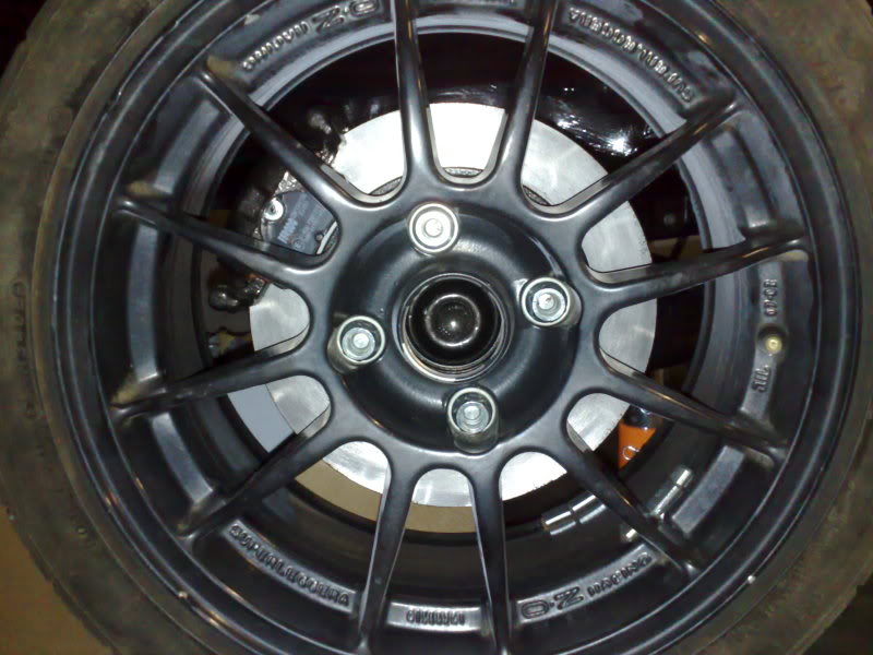

                  and i'd really recommend some proper hub-centric spacers
                  My Project...

                    #129
                    I've designed some to be made, just lacking a bit of money! lol
                    Certainly gets annoying after two years having to manually centre them every time you put a wheel on!

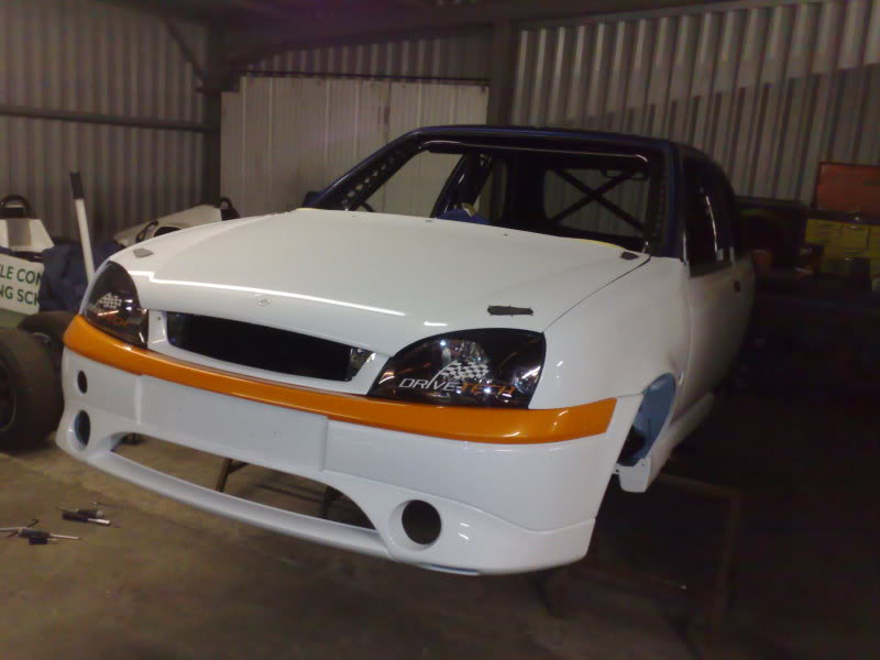

                      #130
                      Car is looking superb now. Very nice colours and stunning build quality. I had a modified blue zetecS on the road a while back and they are cracking cars. Ideal platform for a racer.
                      Bet you cant wait to drive it again now

                        #131
                        tbh i bought some off of ebay and they werent all that heavy, cost me about £15
                        dont need em now though, the compomotives clear my brakes

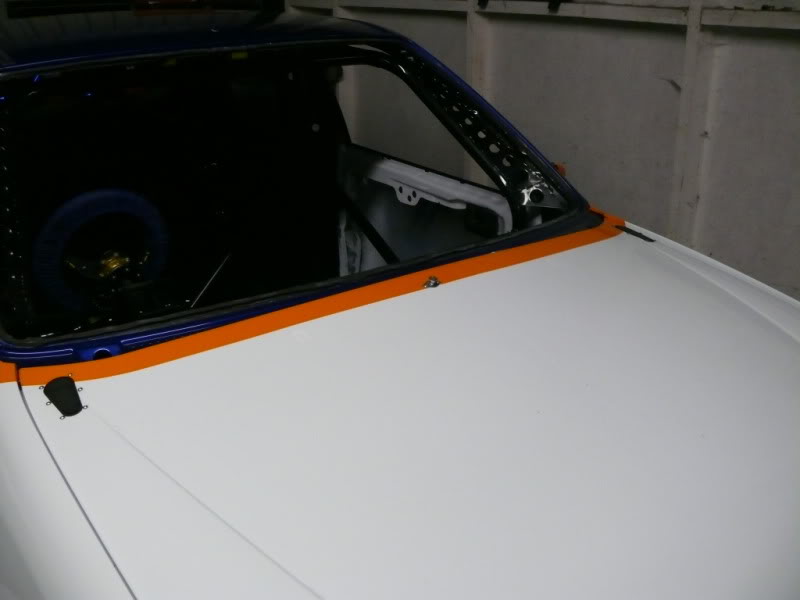

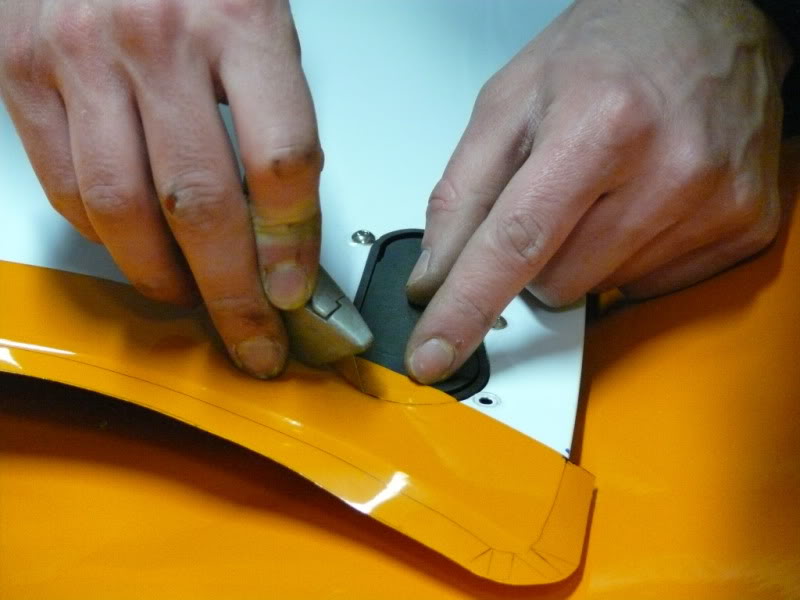

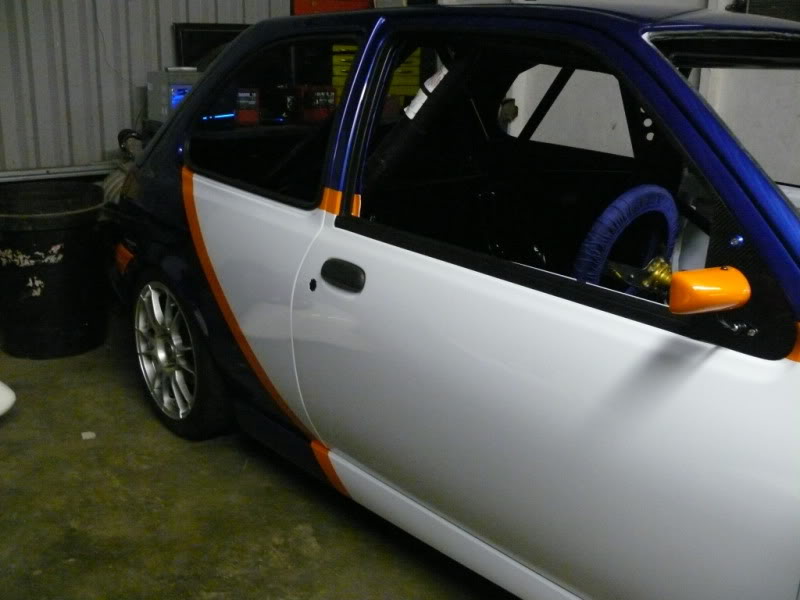

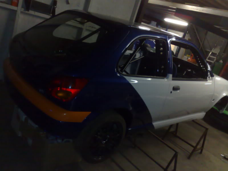

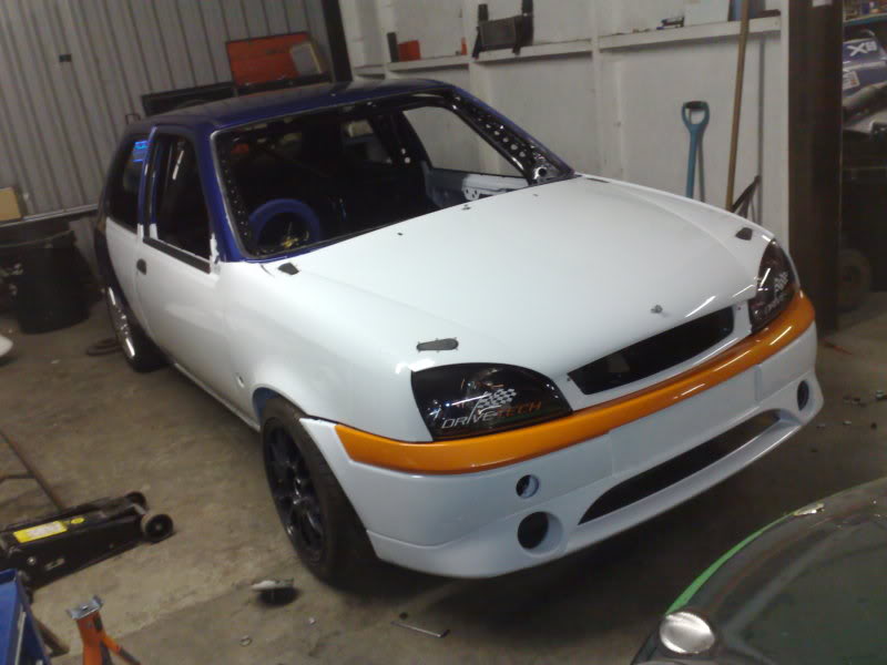

                          As of 15/02/10
                          Skirts fitted, mirrors fitted, front arches flaired to fit the 16's (if gearing requires them), rear topmounts fitted.

                            #133
                            Nice, very nice.
