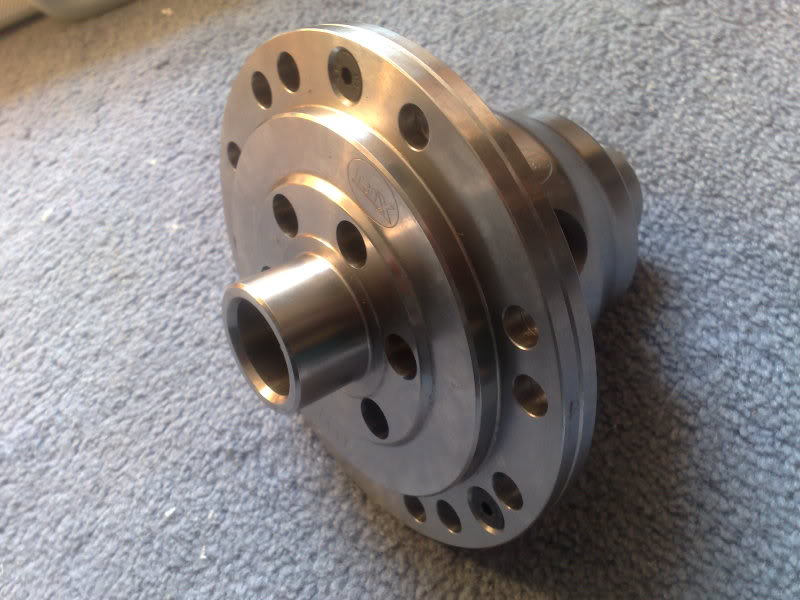

      Also I took delivery of my new TranX plate LSD. Me and Andy stripped the FRP box to double check the ratios and fit the new LSD. Required a bit of modification to the gearbox casing to fit it in!

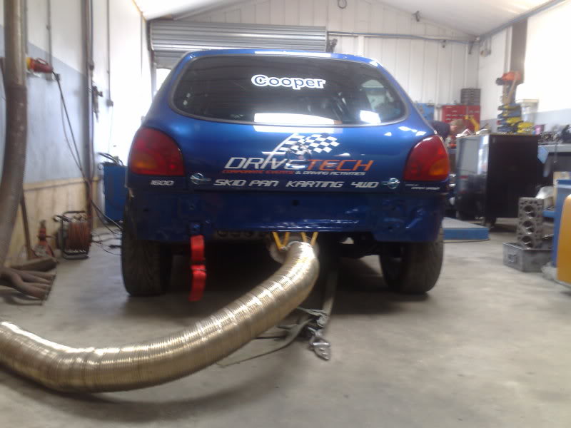

      Engine and box were refitted last weekend, and it was taken back to the rollers to be mapped on monday. Had a much better mapping session this time round, it was clear the engine was working much better with the head tweeks. Its now making around 215bhp. I got sandy to spend some time trimming the map aswell and it now runs silky smooth.
      Nice exhaust ducting on the rollers!

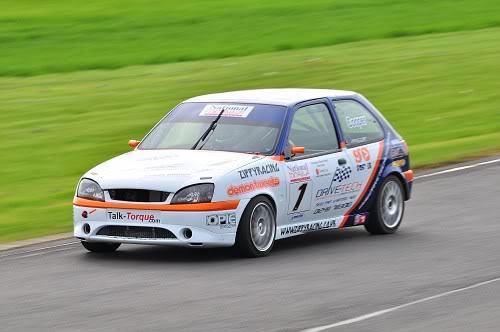

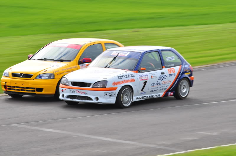

              Round 2 went slightly better than round 1.
              Qualifying: 1st in class by 0.135, top 3 in class covered by 0.137 so mega close! 5th overall on 31 car grid.
              Race: 1st in class, 3rd overall. Ran P2 for 4 laps, hassling the lone Evo for the lead for the first 2 laps! Missed out on class lap record in the race by 2 tenths, which has stood for 8 years IIRC.
              Few pics from Monday.
