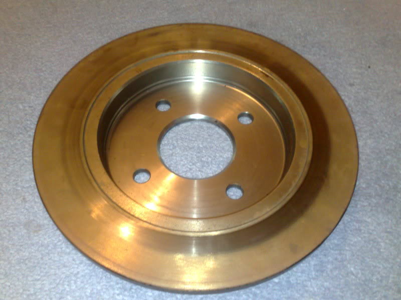

    Re: Ford Fiesta Race Car
    With the discs, might be worth putting 4 small grooves in with a 4mm ball-nose or something? I assume you have a rotary table at your disposal going by some of the machining you've done
    • jason33
      • Jul 2009
      • 174
      #212
      I did think about that, but its an extra machining operation with little benefit for me. On such a light FWD car the rear brakes really dont need to do much, certainly not enough work to glaze the pads/discs. The rear brakes are not even putting enough effort in to fully engage the pads on therear of the discs!
      For perspective, I did 3 years on the set of shoes in the drums I ran with still lift left in them, in contrast to 5 sets of front pads in the same period.
        #213
        Does it tend to lock the front brakes?
          #214
          i've known fwd racers grease the rear brake shoes to stop rear end lock up, one very quick championship winning and always front running fwd car i know has no rear brakes at all, so i dont see rear brakes doing next to nothing being an issue any more than when i ride my motorbike where you do 98% of all your braking on the front only

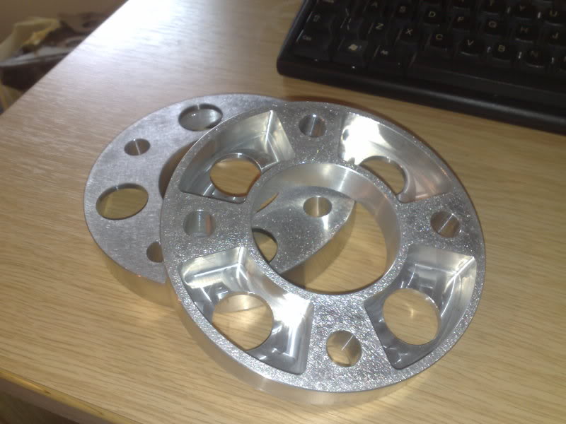

              #216
              Not a big update but I got the lightened wheel spacers back today:

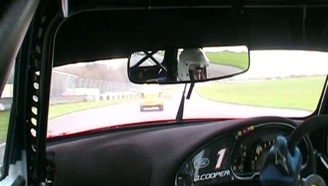

                      #220
                      This is the first lap of round 1 quali before the camera cutout on the curbs
                      Remember I had had no meaningful testing prior to this and was only running 200bhp at the time.

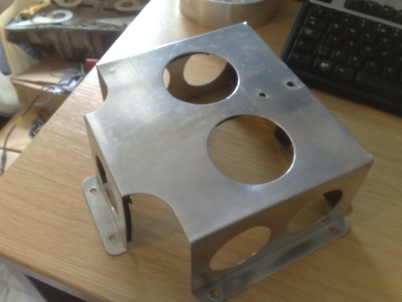

                        #221

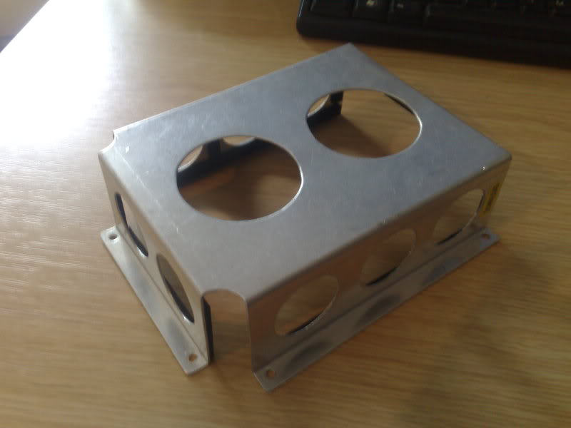

                        To match the footplate I'm getting the data logging cover powdercoated orange
                        I'm also getting a new battery cover made, which I will draw up later and have a sponsor logo cut out the top too.

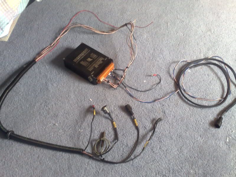

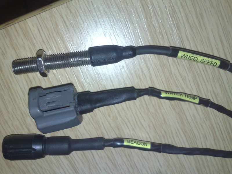

                        I have never been happy with my PI data logging loom that I originally made in quite a rush, and I have been getting some dodgy readings from one of the sensors recently.
                        So I'm going to remake the loom properly this time with some sheided cable etc.

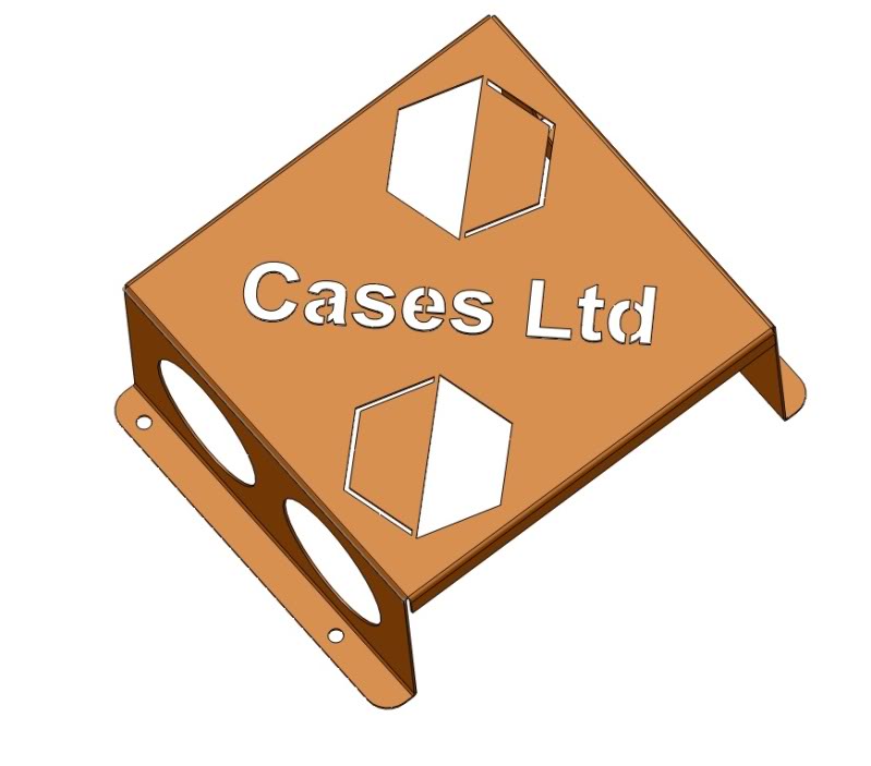

                              #224
                              Just designed the new battery cover to be made next week, courtesy of Cases Ltd, sheet metal specialists in Weston Super Mare. www.cases-eng.com

                                Also started on the new PI data logger loom tonight. 3 parts down, 3 to go.
