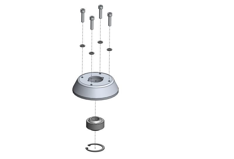

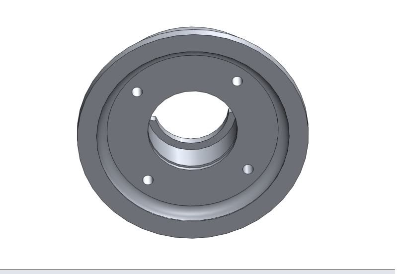

      Pressed out the polybushes from the rear beam today, so all the metal work is now ready for shotblasting.

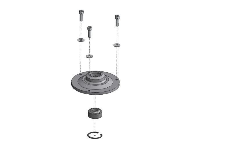

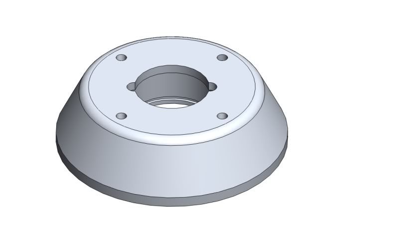

      I also managed to measure up and design a rear top mount today, which I modelled:
      I havent done many assembly drawings so far, so for a bit of practice I modelled up the bearing and circlip etc and did the two top mounts:

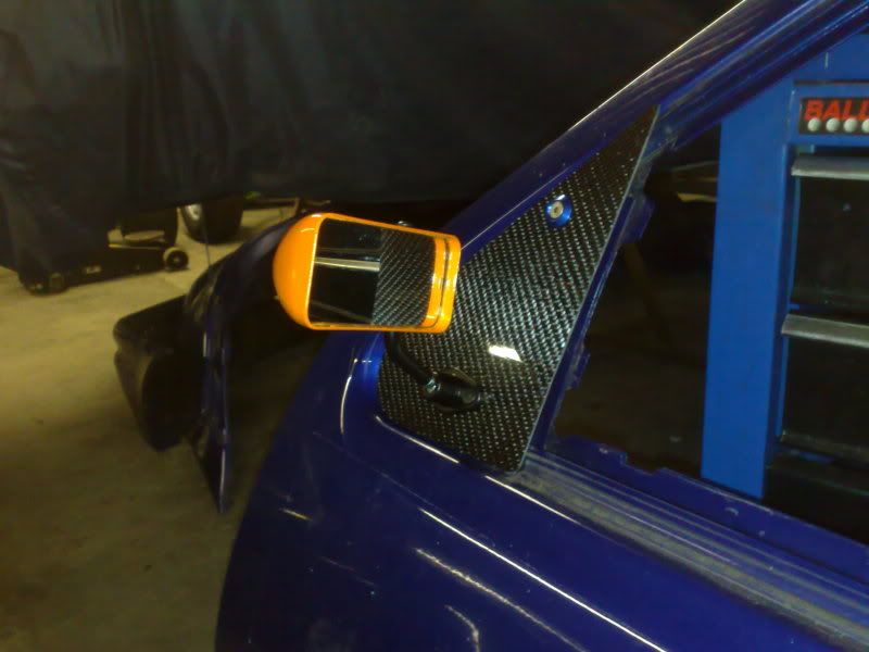

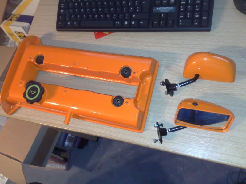

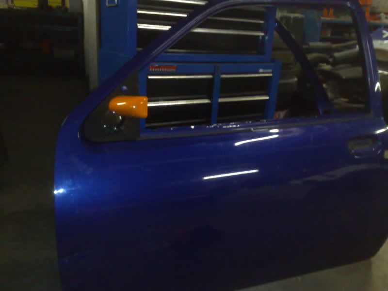

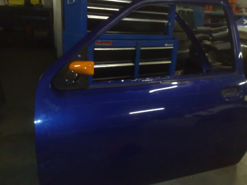

          Some more pictures of Neils lovely paintwork

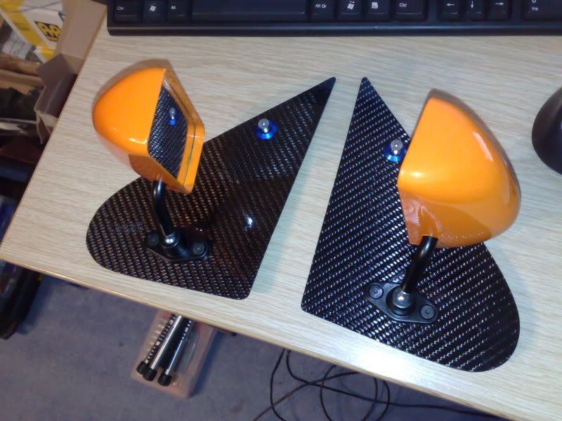

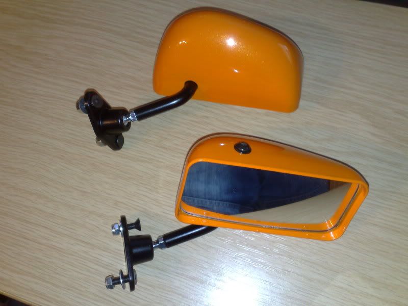

          Mirrors built back up

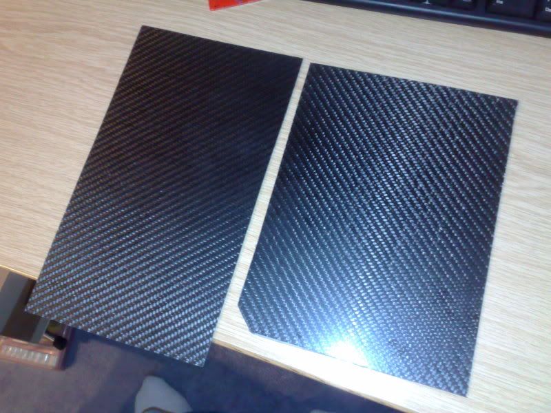

          Bought some sheet Carbon Fibre for the baseplates
          Which I made this evening

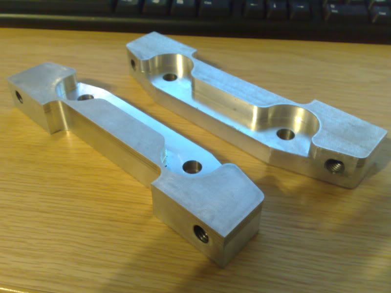

          Caliper mounts have been made, pick them up tomorrow.

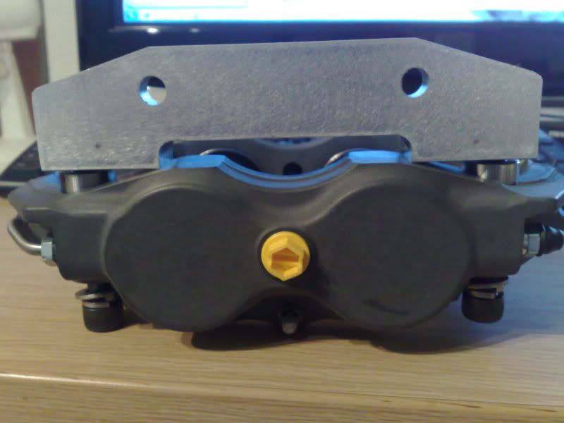

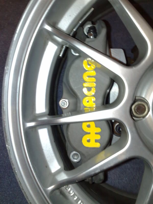

            Got my brake brackets this morning, which I was dead chuffed with until I checked them to drawing and they have been made wrong! lol
            As you can see they foul the caliper body, but at least they can be reworked easily.

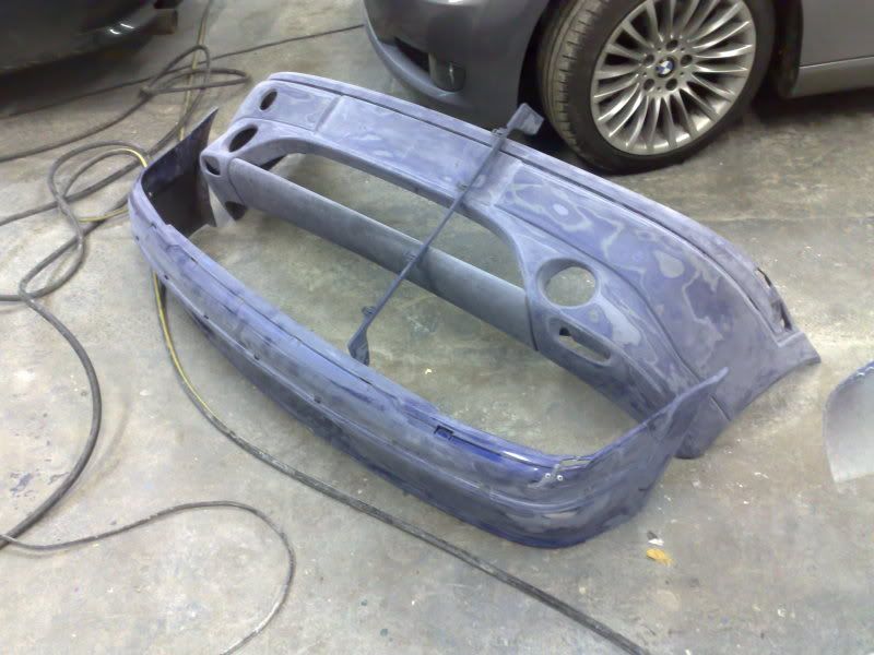

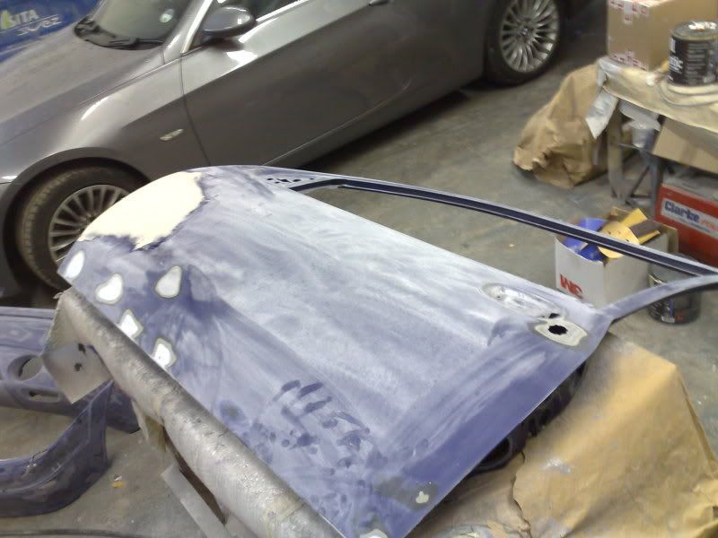

            Also on the bodywork front, bonnet has been sprayed, and I have prepped both bumpers, grill and front wings ready for paint, just the doors to go tomorrow.

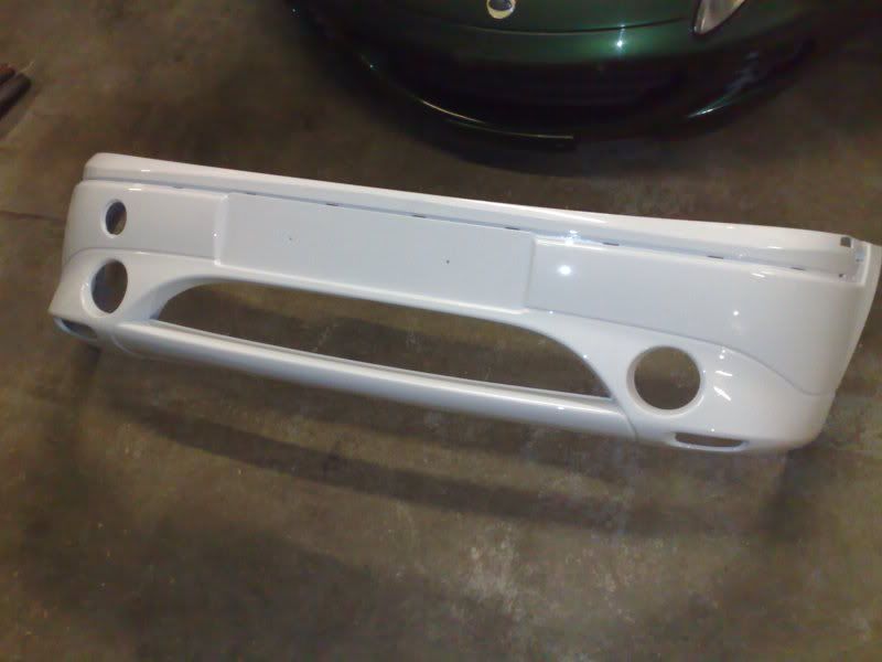

                  Bumpers and grill rubbed down ready for paint:
                  One door almost prepped:

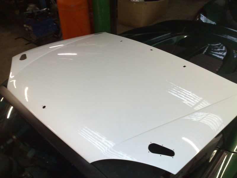

                  Bonnet sprayed:

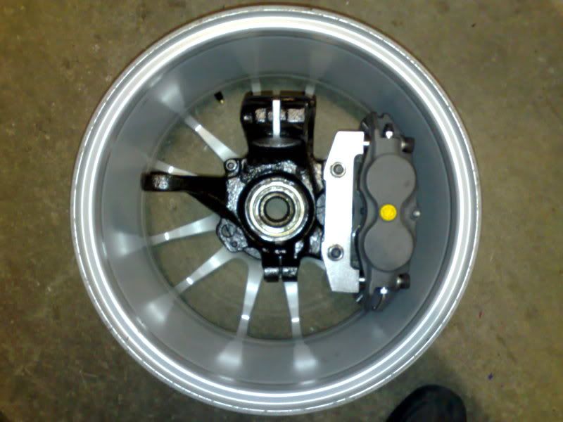

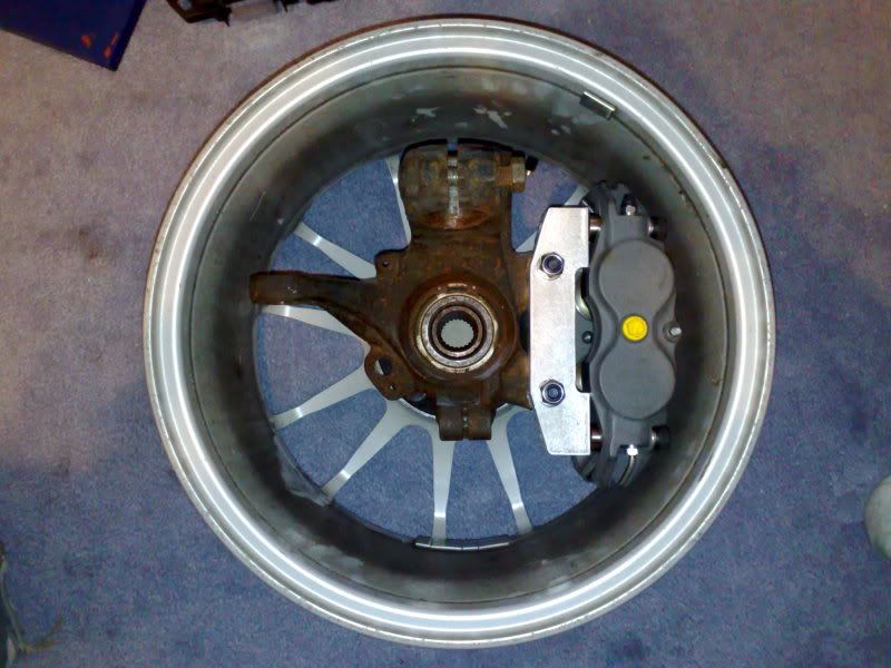

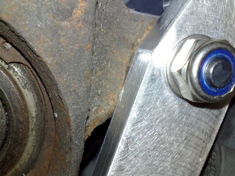

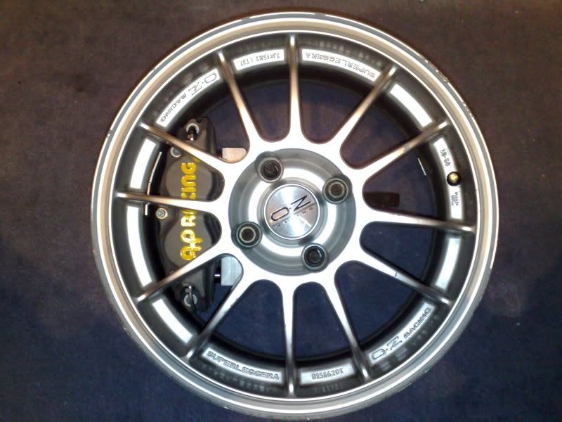

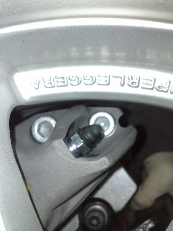

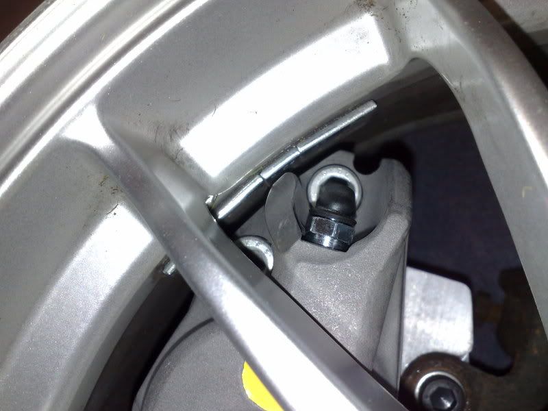

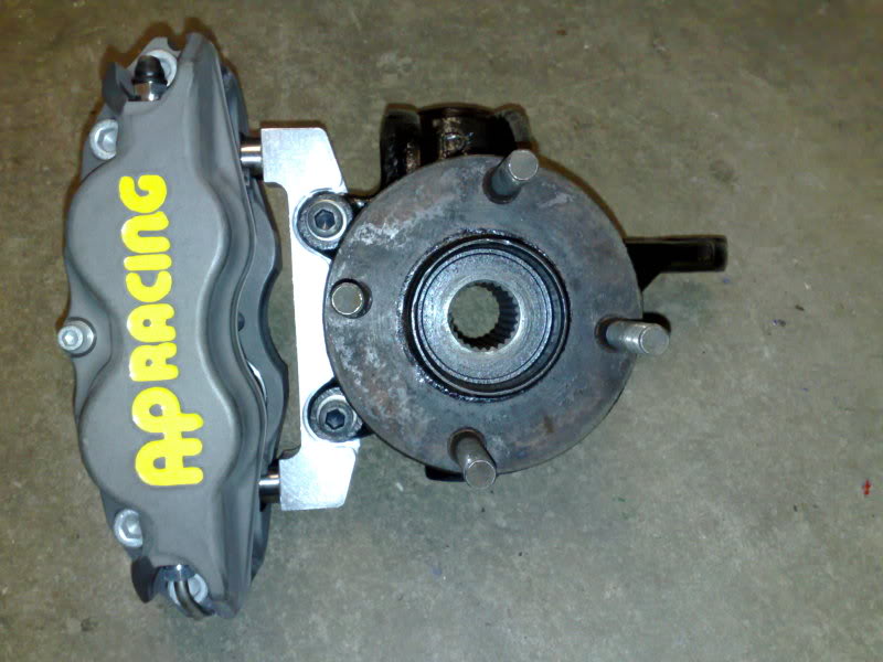

                    I just tested fitted them on the hubs to double check the calipers fit, and they just catch on one part of the hub so I'm going to get him to take 1mm off the back face at the same timeas the other rework.
                    Where it catches on the hub:
                    Under the wheel
                    Just enough room for the balancing weights!

                      i have to have the balancing weights done on the inside edge of the wheel, on my last set of wheels they actually caught the caliper, the new set of wheels clear, but heats the glue on the weights enough for them to fall off.

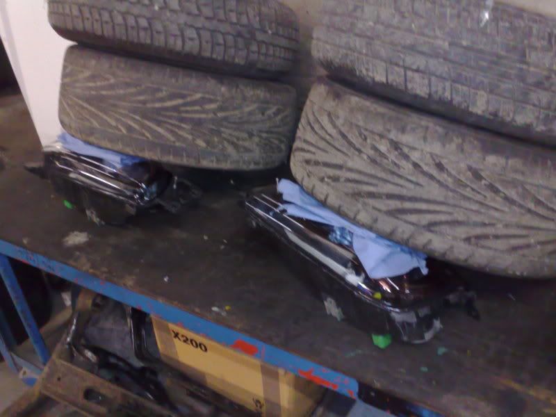

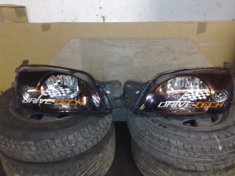

                        Headlights are finished now, done the sponsor stickers, stuck them to the inside of the plastic lenses, and then bonded the lenses onto the case.

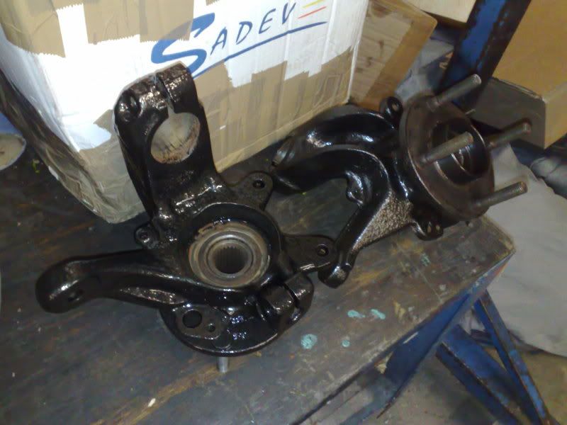

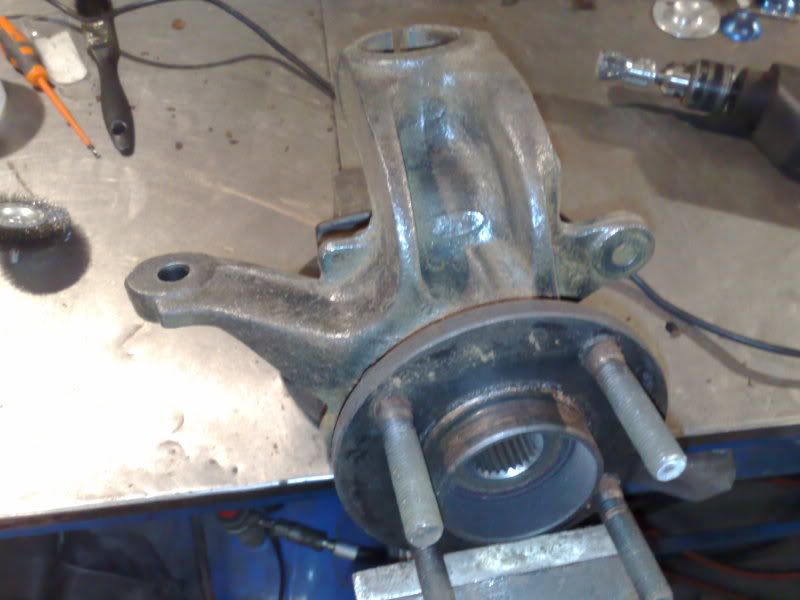

                        Then I did something ive been meaning to do for ages, I got the wire wheel on the front hubs to get rid off all the surface rust, and then gave them a coat of paint.

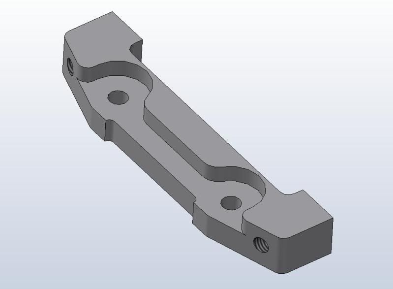

                        Ive just done a revision to the drawing of the caliper mounts, which are going back to be reworked. Shows the small cutout to clear the hub casting:

                          Hubs during prep:
                          After a lick of paint:
                          Plastic lenses being bonded in place:
                          Finished article, note logos stuck to inside of lenses so they dont get peeled off all the time!

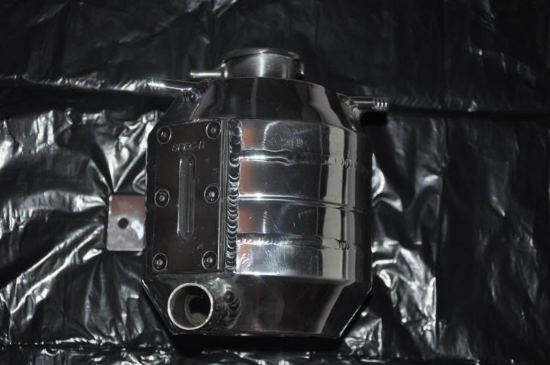

                          Header tank polished up
                            #103
                            Very Nice!!

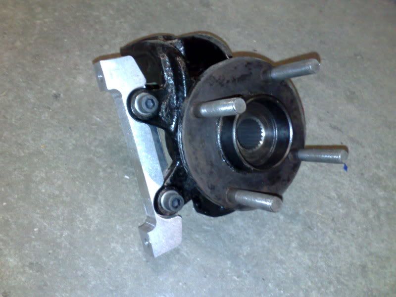

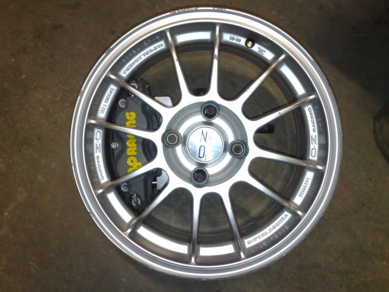

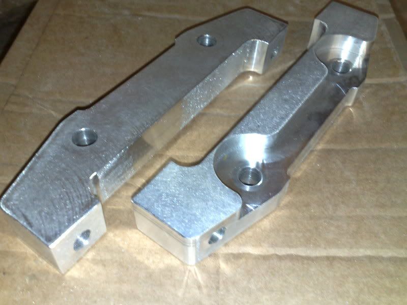

                              I got the brake caliper mounts back.
                              Which fit lovely now
                              Glad I stuck with the 285mm disc now, 290 would definately not fitted with these calipers!

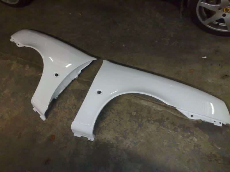

                              Wings and front bumper are now painted up:
                              Doors, grill and rear bumper should hopefully be painted this week

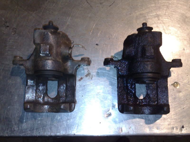

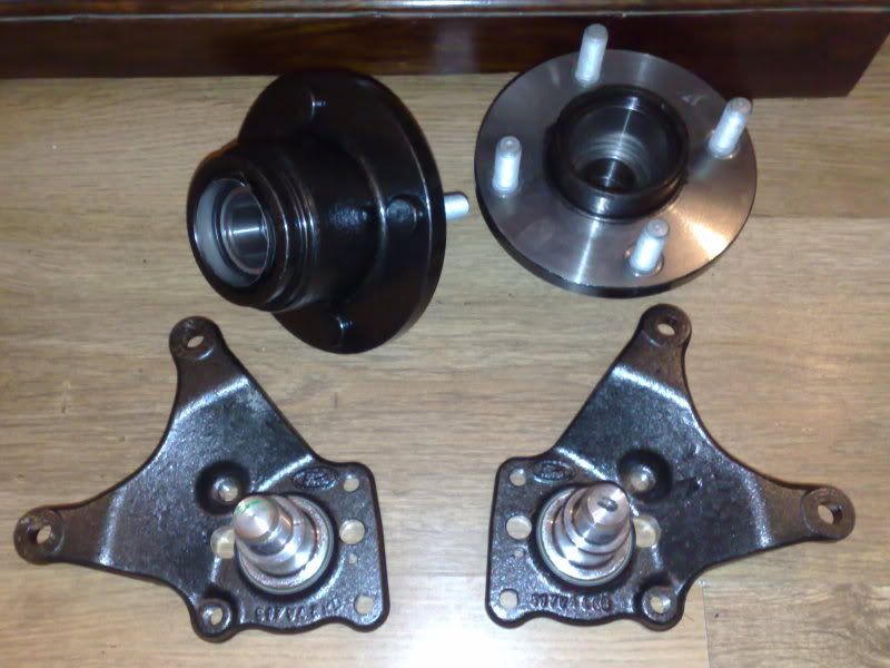

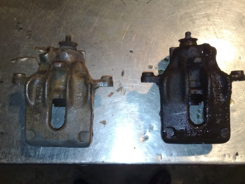

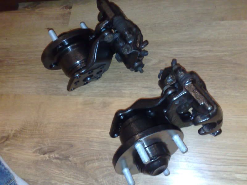

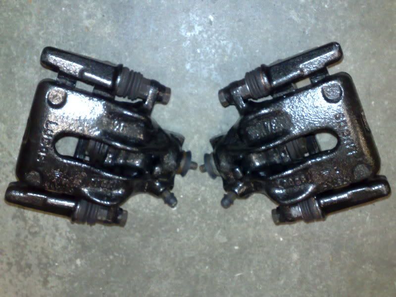

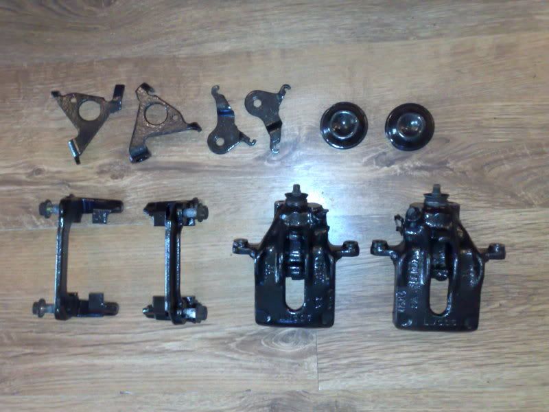

                              Due to bugetry constraints I have had to ditch the rear AP 2 pot setup, but managed to get a focus setup

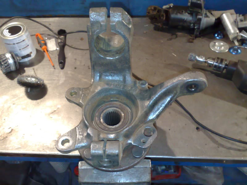

                              So these were cleaned up, as recieved right, cleaned up with wire wheel etc on the left
                              These were painted up
                              along with the new hubs and stubs
                              Going to get some new standard discs and pads to finish them off

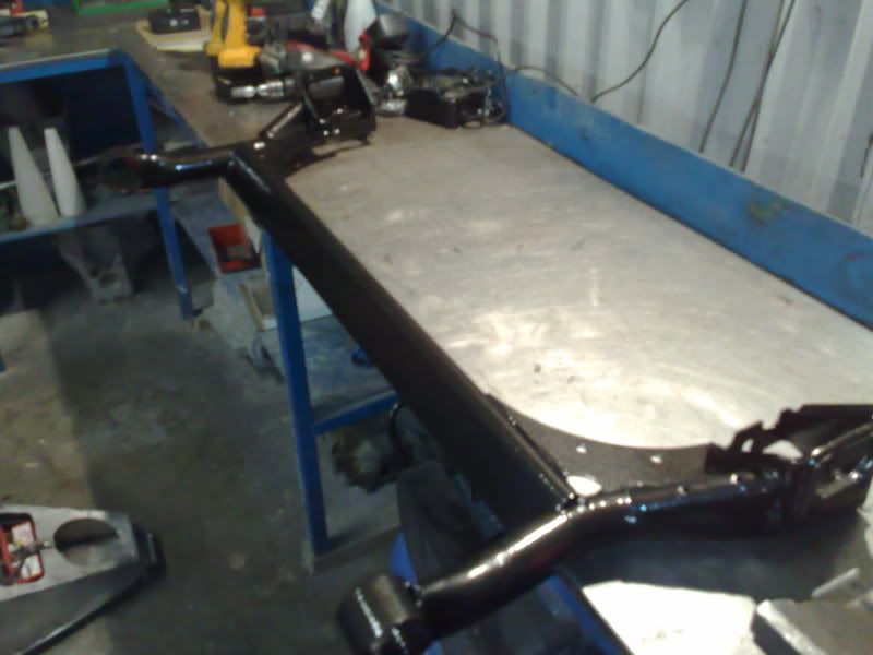

                              Again due to bugetry constraints I cant afford the shot blasting and powdercoating, so spent a while cleaning up the rear beam with the wire wheel. Painted it up today and it came out really well.
                              Got subframe and a load of other brackets to go now, not to mention the bottom of the car

                                Lovely attention to details!
                                Have you tried dipping these bits and bobs to citric acid? Saves a lot of elbowgrease and does far better job on de-rusting than wire brush ever can.
