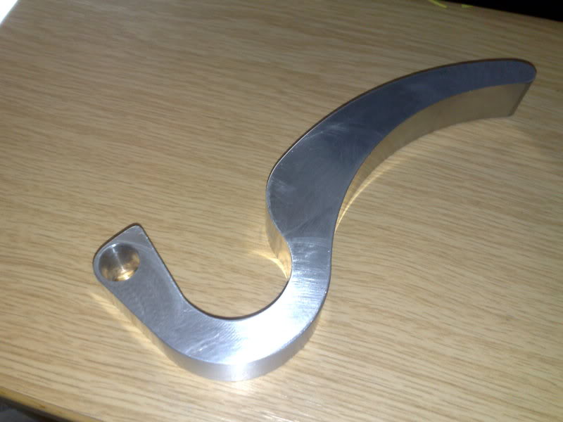

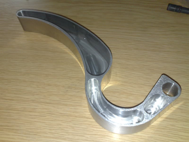

    The new footplate:
    The new throttle pedal:

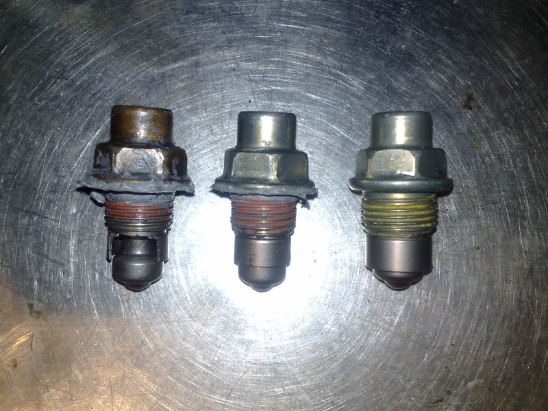

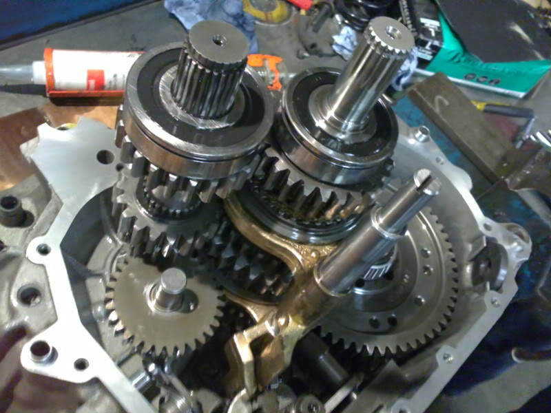

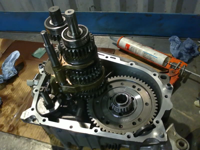

    Last night me and andy took the gearbox out and stripped it to check all was ok after fitting the new diff. Alot of plate wear evident from the initial runs so needed a good clean out.
    Selector detent was broken again. Looked through the other second hand boxes I have and they are broken on them too so obveously a weak point, might need to invest in a few new ones!
    Hopefully gearbox will be rebuilt and back in the car tonight.

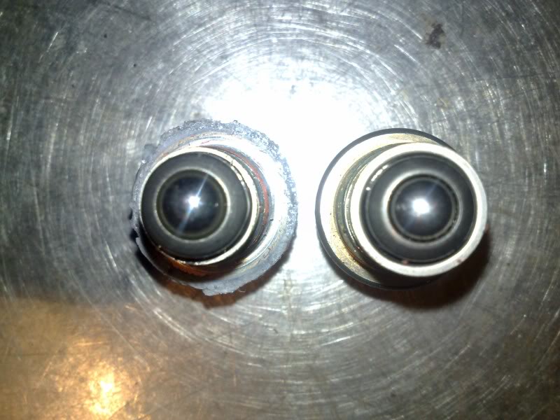

      Few pictures of the gearbox selector detent
      Left: Previous broken standard detent
      Middle: Cracked standard detent
      Right: Larger stronger Mk6 ST detent
      We can see from above the casing difference of the detent, see how much thicker it is on the ST item on the right. As such I will drill and tap the casing to take the later detent.

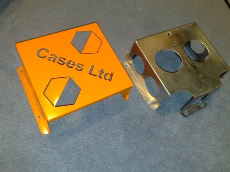

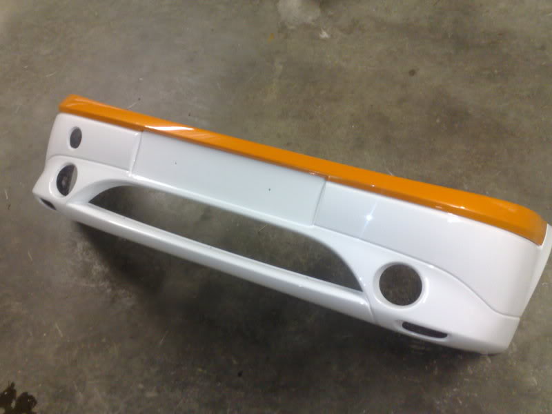

      Got my freshly resprayed front bumper back today

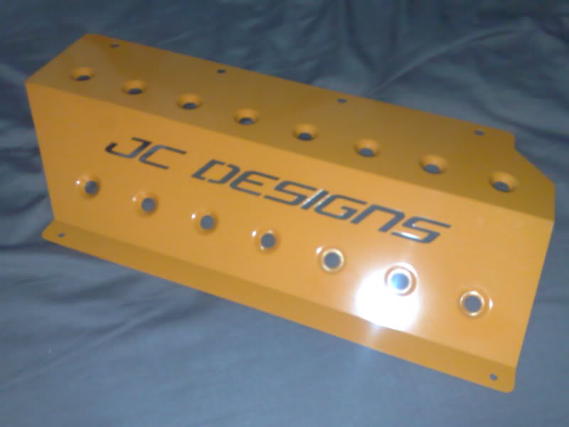

      Also got my new battery cover, seen here next to the old one.

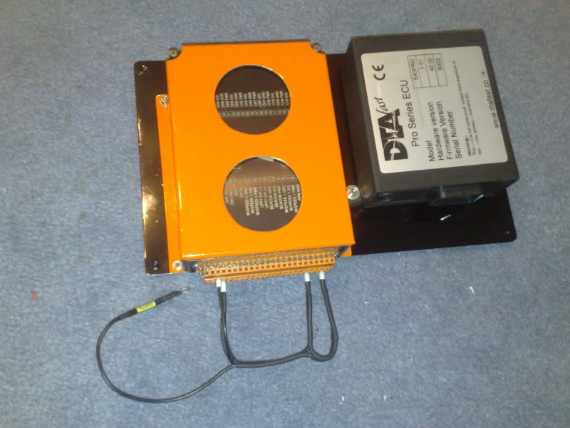

      Data logger cover was wrapped in orange vynil rather than sprayed to match the other covers

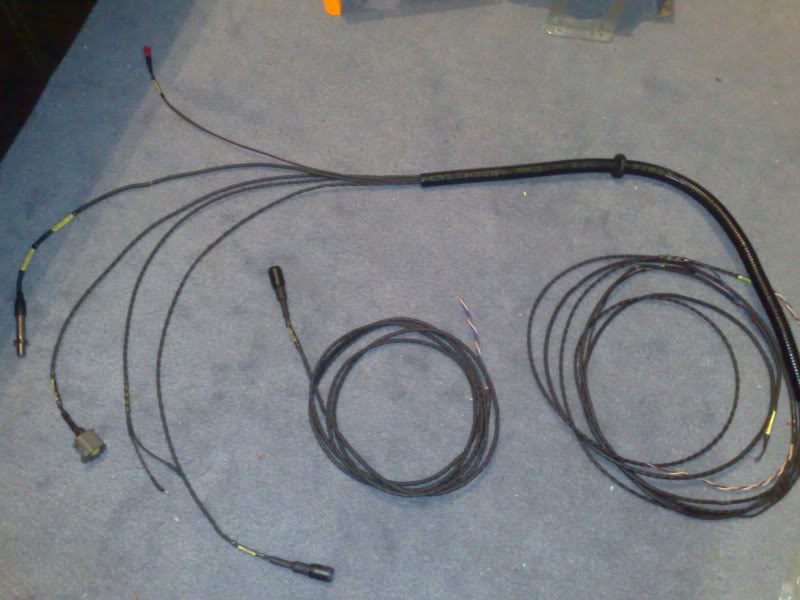

      New logger sensor loom ready to go back into car for terminating and tidying.

        very professionalwhat screened cable have you used for the loom

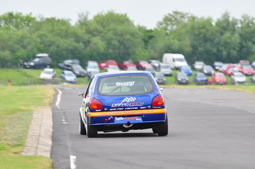

                            Few pictures of her in action this year

                              Few pictures of the Quaife kit I put in mid season:
