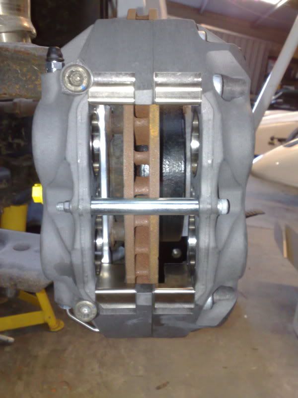

      Had a mock up of the brakes on the Hi-Spec mounts with the Hi-Spec 276 disc, measured the clearance and looks like a 290 disc is going to fit.

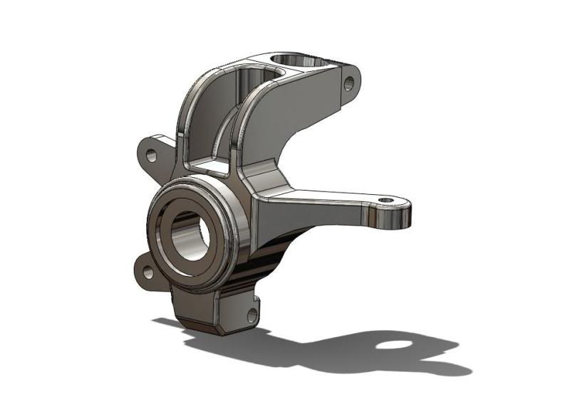

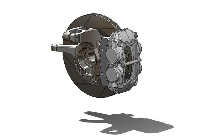

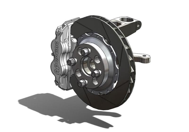

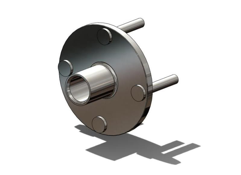

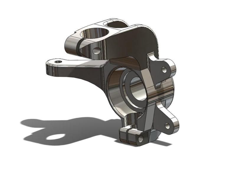

        Well after LOTS of measuring today, double and triple checking all the measurments and a bit of modeling a 290mm disc will fit under the Superleggera with the AP calipers.
        So the front disc bell and caliper mount designs are all done, subject to me checking out the discs and pads when I get them

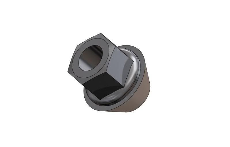

        Anyway, some more of the modeling
        Wheel nut:
        Front hub:
        Front upright, this was pretty hard to do, took a few hours!
        Complete front setup:

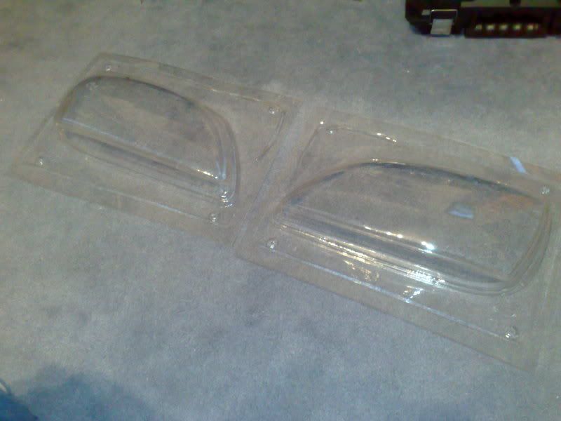

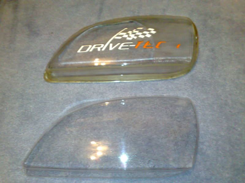

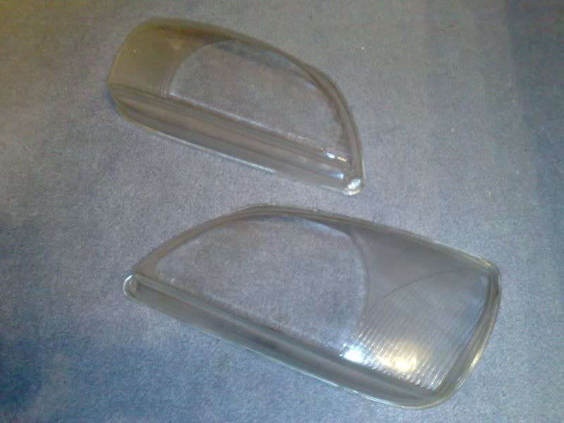

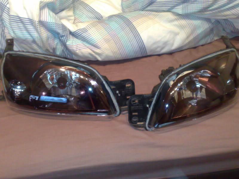

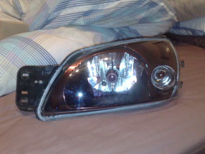

                        Well I sent off the standard headlight lenses to sarik-vacform to make some plastic copies for me.
                        Roly has basically made a mould from the glass ones and vacuum formed some plastic ones.
                        I had to cut them out from the rest of the plastic, here is one against the glass one I removed.
                        The glass one weighed 1.5kgs, the new plastic ones are just under 200g's, so a total weight saving over the two lenses of 2.6kgs, easy weight loss.
                        I still need to put the sponsor stickers on them (going to make them back to front and stick them to the inside this time so they dont keep getting peeled off)and I need seal them up.
                        You get the idea anyway:

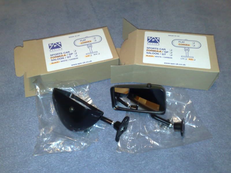

                        I also went to Merlin Motorsports today and bought my new wing mirrors.
                        These are single seater SPA mirrors, Ive bought them to loose weight over the standard items, plus they are alot smaller so keeping obstructing airflow to a minimum.
                        Probably useless for using as mirrors, but tbh once I had got used to using the interior longacre swept mirror, where you can see out the back and both sides in one, I never used the wing mirrors, especially useful when the wing mirrors got knocked off!

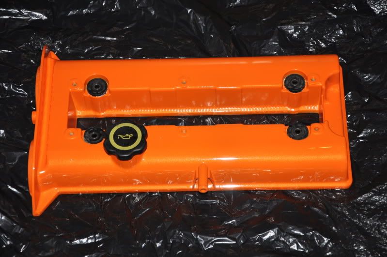

                        Neil has painted my rocker cover electric orange, looks damn sexy too, he's going to paint the new mirrors too, hopefully he has enough paint left over!

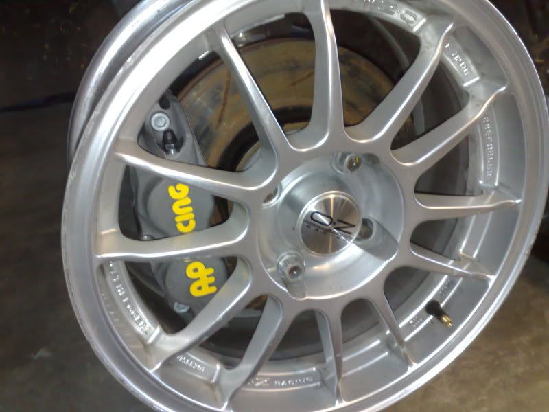

                          Not much to report on the car front really, havent had the motivation to work on it in this weather! I am also building a gearbox for another fiesta racer at the moment too.
                          I have ordered my AP discs, went with the 285x25.4mm 48 vane vented disc, with 4 forward facing grooves. Was forced to go with this disc as it was the only 285mm disc with a mounting PCD small enough to clear the pad. Dissapointingly though they are not in stock so have to be made, expect 4 weeks aparently.
                          Pads have also been ordered, limited to a few AP compound pads with these calipers though, I have gone with the APF403's. If the pads are anything like the rest of the AP range of stuff though, they will be the mutts nuts, I hope anyway!

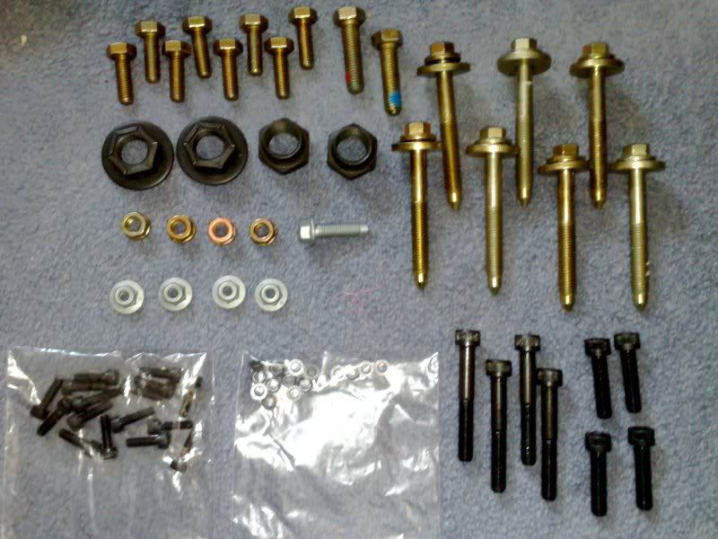

                            Went upto Merlin Motorsport today and picked up all the nuts and bolts I needed for securing the rotors to the bells and the caliper to the hub.
                            Before xmas I also got half my order of nuts and bolts I wanted to replace, still waiting on some on backorder.

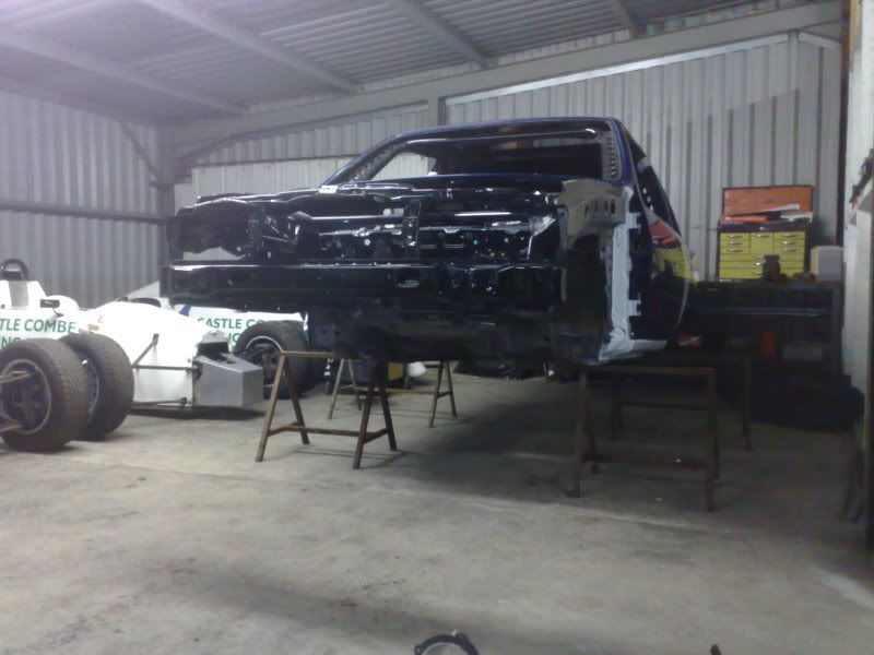

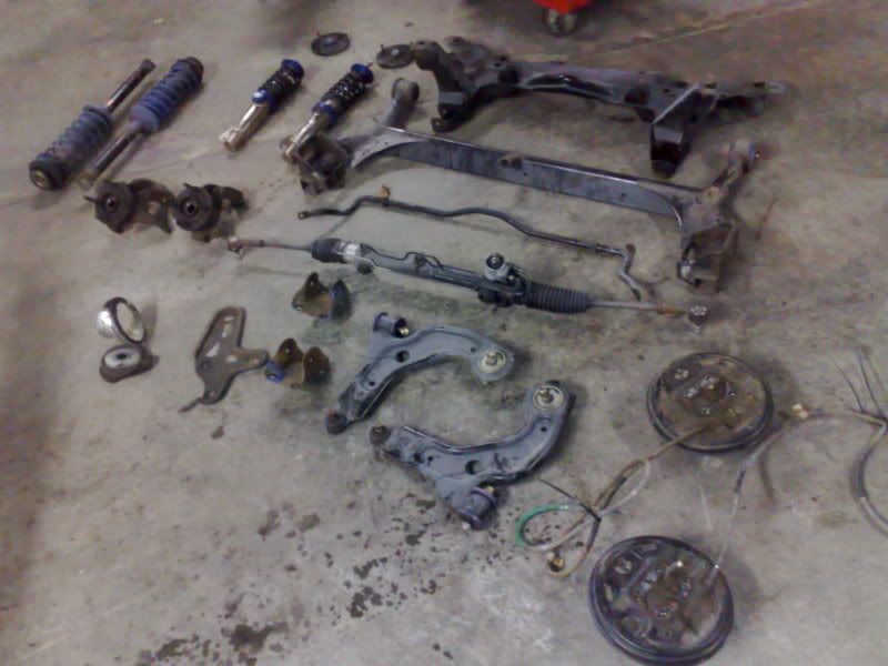

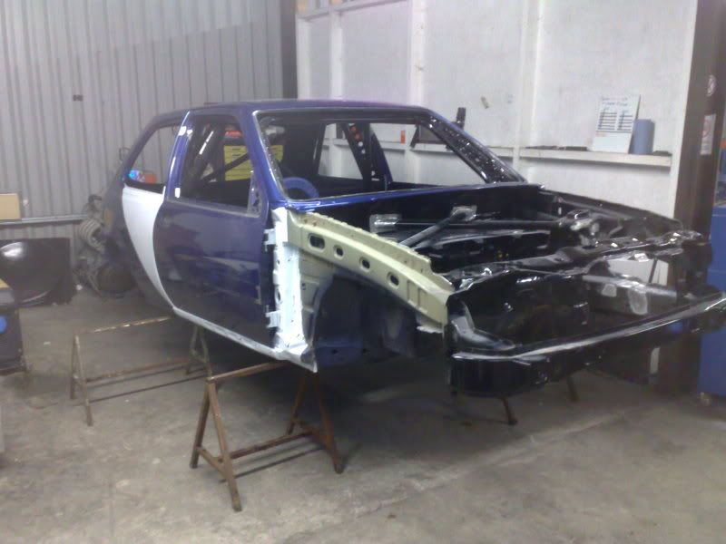

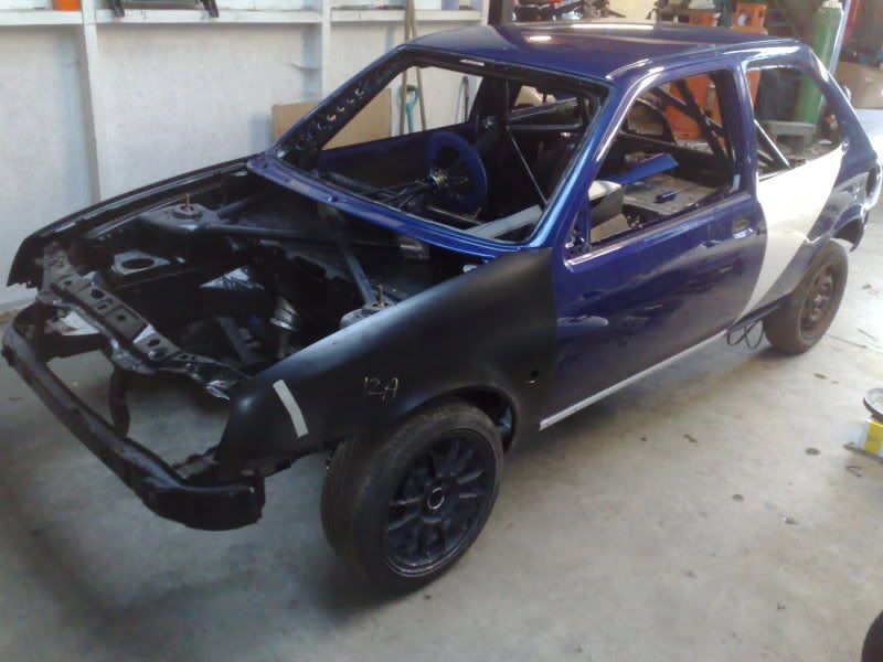

                                Finally braved the cold today, Callum came over, we got it turned around in the workshop and up on stands, then removed this lot:
                                How it looks atm:
                                Also met up with Neil and gave him my mirrors or a coat of electric orange.
