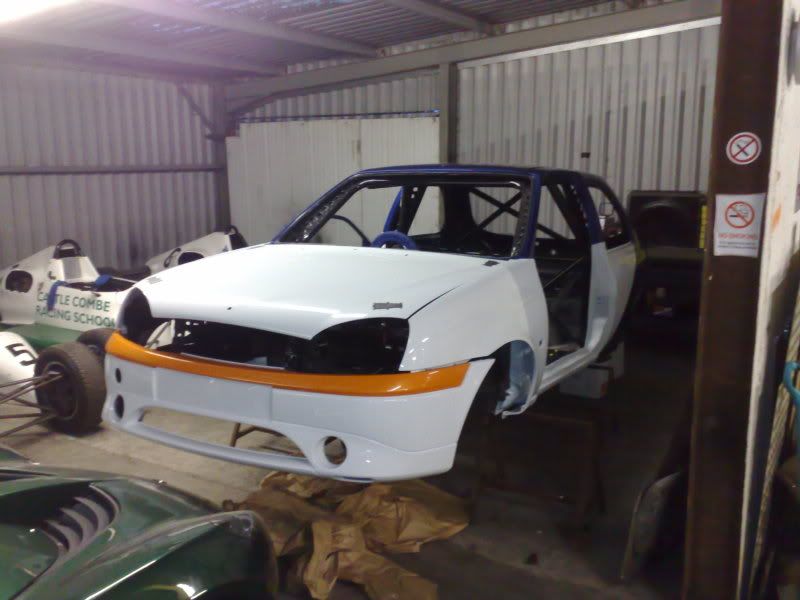

            #110
            All panels are now sprayed, picked up my rear bumper, front grill and the two doors earlier.
            Got some bits from Ford, some new wheel nuts, front wheel bearing, set of gearbox to engine bolts, set of leads, plugs and a new coilpack.
            Also got some new focus rear discs
            and pads
            Refitted polybushes into rear beam
            Assembled hubs onto beam
            Painted some more brackets
            Also fitted all the aero catches, refitted the rear screen and hung the doors to check paint lines between the panels match.
