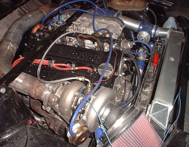

                  After fitting the 750cc min injectors, we have just finished mapping the engine today, and if i say so myself it does exactly what it said on the tin,
                  the goal was 100bhp more than last year, with low lag and hopefully reliability so i was looking to keep the boost pressure low, which is why i built a big cc 16valver and fitted an rs500 race intercooler, turbo technics built the t38 turbo to give low lag and getting on for T4 power saying it would run out of steam at around 450bhp
                  the final result
                  15psi boost, 409lbft 460bhp,
                  it looks like TT were spot on with the claims for the turbo as cranking the boost up further doesn't actually make more power, suggesting that 460bhp really is its limit in terms of airflow.
                  one thing that we never actaully did was to play with the cam timing, but then again, i've got more than enough power for now, just need the driver skill to go with it.

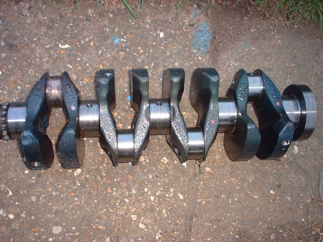

                      Sorry if this is a dumb question.
                      I looked at the pic of your crank, and thought "why do they have such big counterweights"
                      What would happen if they weren't there? I am guessing it is something to do with balancing, but why doesn't the flywheel do that. And why do you have to have a flywheel at all if those weights are swinging round in there. Surely not just for the clutch. Though I am aware of seriously lightened flywheels used in racing.
                      And I should have said "sorry if these are dumb questions."
                        • 25258
                        #26
                        the counter weights are more important than the flywheel, that just stores energy the engine doesnt actually need the flywheel at all, mine basically weighs next to nothing, the counterweights on the other hand are there to offset the weight of the crankpins and rod/piston assemblies, a fully counterweighted crank suffers much less from tortional vibrations and whipping
                        that crank has quite a long stroke so i guess that means bigger weights are needed although strangely this crank which is from a 2.5 with 87mm stroke is 4 kgs lighter than the 84mm stroke 2.3 version

                          Thank you Graham, you are a gent.

                            just in case you guys missed it elsewhere, i had a cracking first race at brands, won my class came 3rd overal and set the second fastest lap, blinding result and all from this homebrewed beauty which is currently cranking out 460bhp 409lbft on 15psi boost
