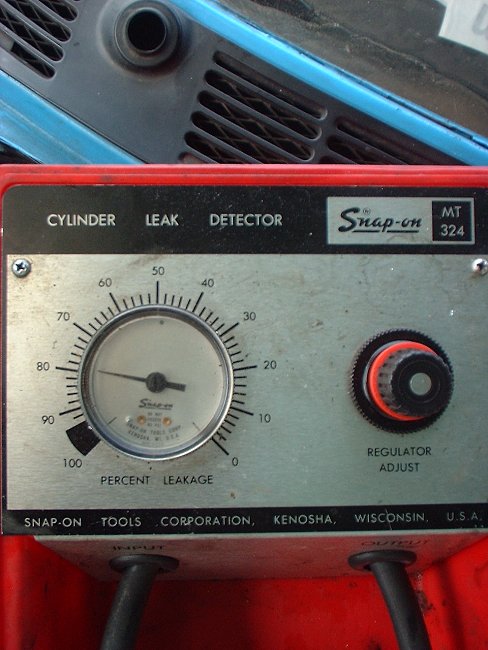

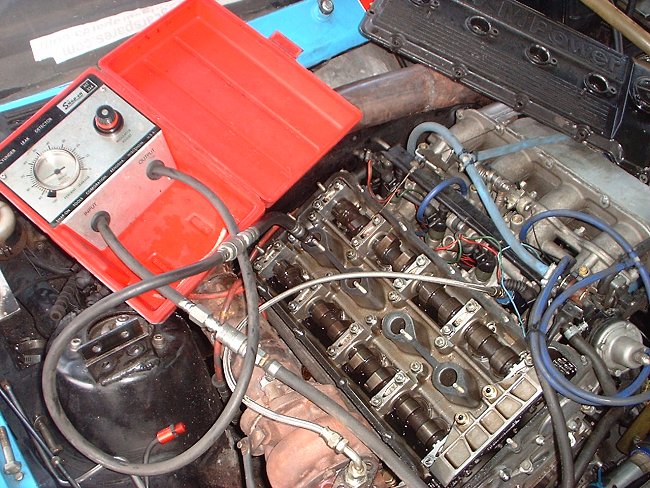

        done a cylinder leakage test this morning, bad news, the best cylinder has 80% leakage, the others 95%, a compression test backed it up, i know the gasket is dead as air from the leakage test is going straight in the cooling system, but i'm struggling to believe that it can loss so much compression through the gasket without any other problems, time to take the head off

            i lifted the head, the gasket was definatly blowing, in an effort to see just how much compression was being lost through the gasket, i dug out an old gasket, covered it in sealant, and bolted the head back on minus cams etc, and repeated the leakage test, better but still not good, i could hear the valves leaking the air through the manifolds, so i definatly know i also need to recut the valves seats and get the head refaced, think im going to have to pull the pistons out

                i made up an adapter plate, and did a cylinder leakage test on the bottom end with the head off, 70% of the compression loss was through the valves and gasket itself, the valves are easy fixed by re cutting the seats, the rings arent sealing as well as i'd like, which means pistons out to check/re-ring, the block could also do with decking to make the o rings sit a bit prouder and bite harder into the head gasket, which means a total engine strip, i may well just take the rest of the season off, as i want to make a few other changes, such as exhaust manifolding which isn't going to be straight forward, i want to change one of the cams, and the whole lot is going to have to go back to the rollers to be set up again,
