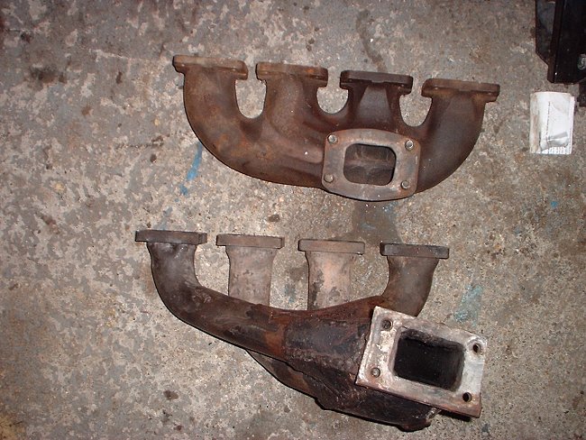

                      i now has a 4wd cossie manifold in my possession with will be the basis of my turbo mounting for 2007, my fabricated manifold worked really well from a power point of view but not so good in the reliability stakes, hense my decision to adapt a ready made manifold, initally i tried a 2wd cossie manifold, but without a total re engineer of the car no way was it ever going to fit,
                      i realise the 4wd manifold isnt as good, but im at the stage i would rather drop 60bhp over the current one and finish the race with the same power i started it with rather than start out with 460bhp and finish with 160bhp.
                      the manifold wont bolt straight to the head and even if it did there would be enough room for the turbo so i wil have to get very busy making adapter plates, as usual for me, theres no real up front plan i shall just fabricate and engineer as i go.

                        #71
                        Its a shame your one isn't strong enough Graham, it looks so much better than the cossie one. I guess flow isn't quite so critical on turbo'd cars compared with N/A though
