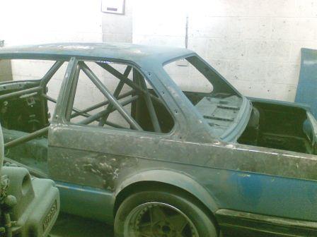

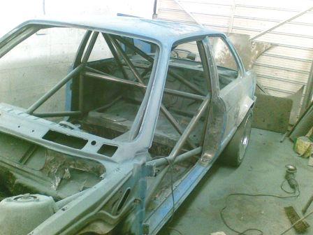

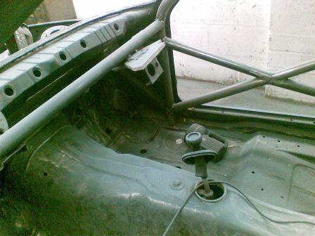

      steering colume out

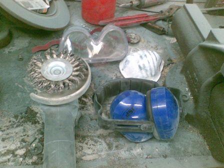

      spent most of the evening using these removing the last of the loose/really yukky paint etc from inside of the car
      then went onto the outside, where i've taken off about 3rd of the paint which is pretty thick as its been resprayed twice ontop of the factory paint
      forunatly i havnt found any rot, ther are just a few spots that could do with some worm poison

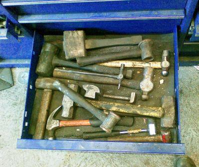

      finally just for dave roberts a pic of my hammer draw

        One day I will get round to gathering all my hammers for a pic.
        How come you have stripped the paint on the outside, it isn't for weight saving is it?
        I suppose 2 extra layers of paint on top of the factory paint must add something to the weight.
          #319
          err yes! was going to get repainted again adding yet more weight so i thought i'd loose the paint already on it, think how much a gallon of paint weighs, with several repaints primers etc thats quite a lot of weight in paint on the car, and some of it was looking pretty ropey in terms of finish, runs, orange peel etc so it would of taken more work in sanding and DA discs to give a nice surface to apply paint to so i fugured it would be better to remove it all
