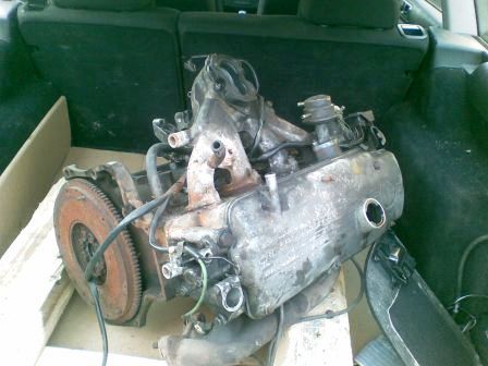

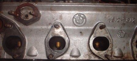

                    it could be this is the base for my new engine, a very manky looking carb'd 90bhp 1800 lump from a e28 518, that i scraped 10+ years ago and put in the stores where i used to work, much to my suprise it was still there and they gave it to me just to get rid of it.
                    i only really wanted the head, this version has small ports so i can try to some new port shapes out on the flowbench, you never know, the rods are interchangable with the 2.0 unit so they might come in handy as i've almost run out of good 2.0 rods and the bottom end or crank might come in handy as an exchange unit, if you by a new crank from bmw they dont seem to care what you give them back, i once gave them a knackered peugoet 205 crank as an exchange for a new m3 crank!!!!!!!!!!!

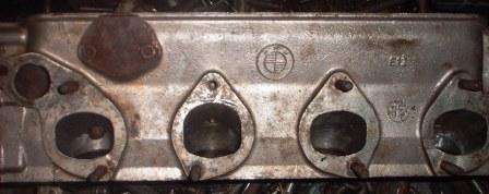

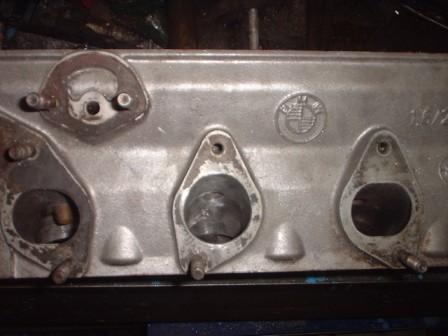

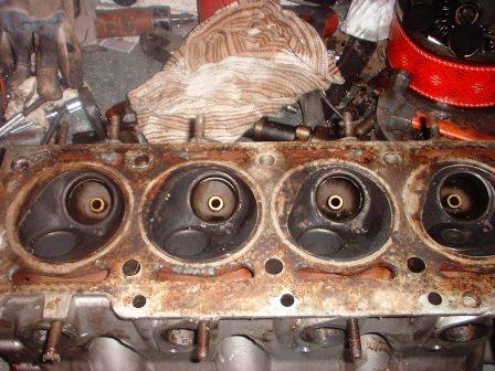

                              ive made a little progress, i've stripped the new small port 1.8 head, ready to open the throats up for big valves. you may remember the plan is to get a couple of heads and prepare several different port shapes and flow test them.
                              below is a normal 2.0 type, which i've been busy reworking, one port is std, one has the "normal" mods, one has had the port floor lowered, lowering the port just encourages the air to do what it naturally does but more so and thats just flow straight across the back of the valve ignoring the short turn.
                              and as you can see one port has had the roof considerably lifted up like 8mm up which was a lot of grinding.
                              by comparison the 1.8 head has very small ports, but still as big as a pinto so they are not really small, where im hoping to gain with the 1.8 head is the port floor is a lot higher, its rather like compairing injection and non injection pinto heads

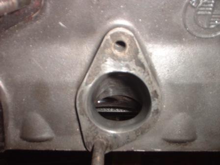

                                #525

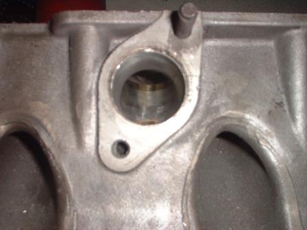

                                ive done a bit more, after a lot of work with the die grinder i've consideraly opened up and downdrafed a port in the 1.8 head, it has a much shallower turn to both the long and short side of the ports, it looks like it should flow really well, but only time on the flow bench will tell

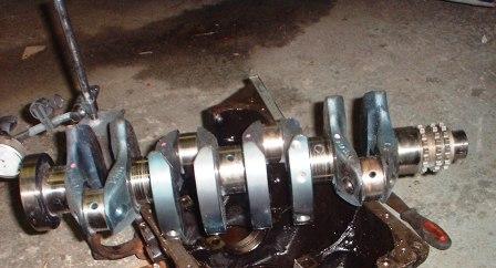

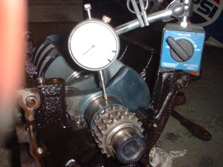

                                i also dug out the crank i damaged early 2006, it was a new crank so i was pretty p@@@@ off at the time, but now having trashed theother new one its time to see if it can be salvaged, when i took t out the engine the crank was bent, where no1 big en had goot very hot, sometimes if you leave them they straighten again, so it was time to see,
                                dropping the crank in a block with just a couple of upper mains, i suck a dti gauge on it and spun it over, it has 0.0045 run out, on no1 main, or in other words its bent by 0.0022, not a lot but bent anyway, now normally i would throw it away, but seeing as it bent only at no1 pin which has only the load from no1 cylinder going through it and it was a virgin new crank i'll take it to see if it can be reground and and given a new lease of life, otherwise its a £600 piece of scrap
