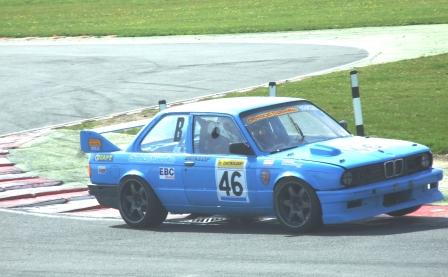

                  i think this picture must of been taken in practise, because im on track on my own.
                  as you can see, i was taking a pretty tight line and not a spot of understeer, if you look hard enough you can see im on three wheels only, which is added by having zero droop front suspension, this helps keep the back end flat and greatly aids traction out the bends without needing a really agressive diff

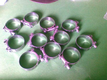

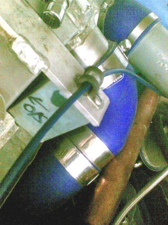

                                i bought some new bigger expensive hose clips so i dont have any more hoses come off such as in practise at the last meeting
