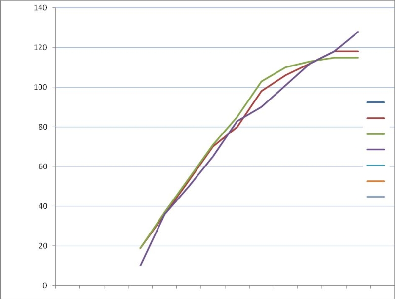

              anyone want to take a guess as to which head will make the most power?
              they are all very different port shapes but if you take an average of teh flow figs they are all very smilar, infact one with least peak flow has highest average flow

                    what lift does that graph finish at? Wouldn't it be awesome if you could replicate the oscillating motion of a valve , to really see how the flow stacks up..

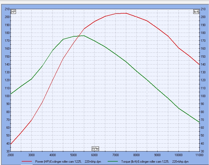

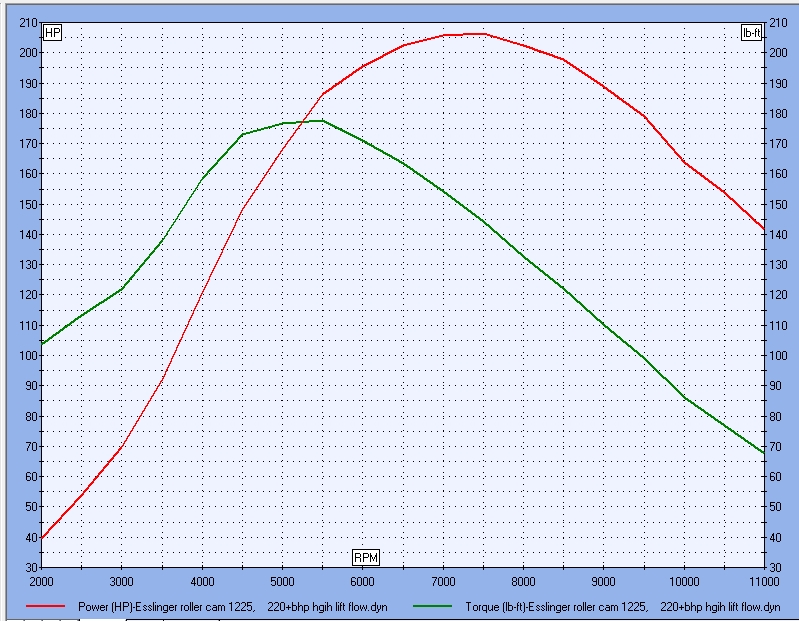

                      I have been reading a bit about high lift and low lift flow recently. It seems that high lift flow produces high peak power and torque figures but low lift flow produces a wide power band. It seems that as rpms go up a lot of the clinder filling happens later and later in the cycle and if the low lift flow is good then much more air can be crammed into the engine after BDC when the valve is nearly closed.
                      I put a few numbers into Dyno2003 to see what came out the other end.
                      HIgh Lift Flow Graph
                      High Lift Flow numbers
                      Low Lift Flow Graph
                      Low Lift flow nunbers
                      Looks like high lift flow wins with this setup
                      Regards
                      Tom
                        that makes a lot of sense, in particular if you take into account air has inertia, it takes a while to get it moving and once moving a while to stop, but then keeping air flowing into the cylinder after BDC is what ram tuning is all about and something these bmw engines really respond to
                          0.500"(12.5mm) because thats what my cam lifts too
