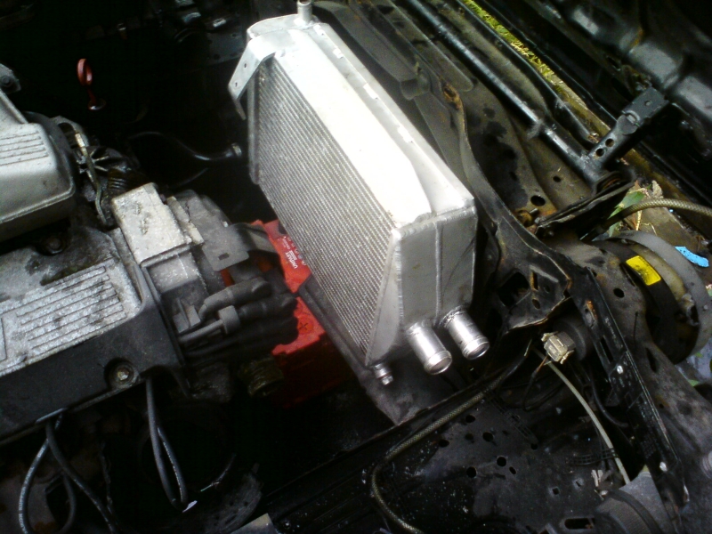

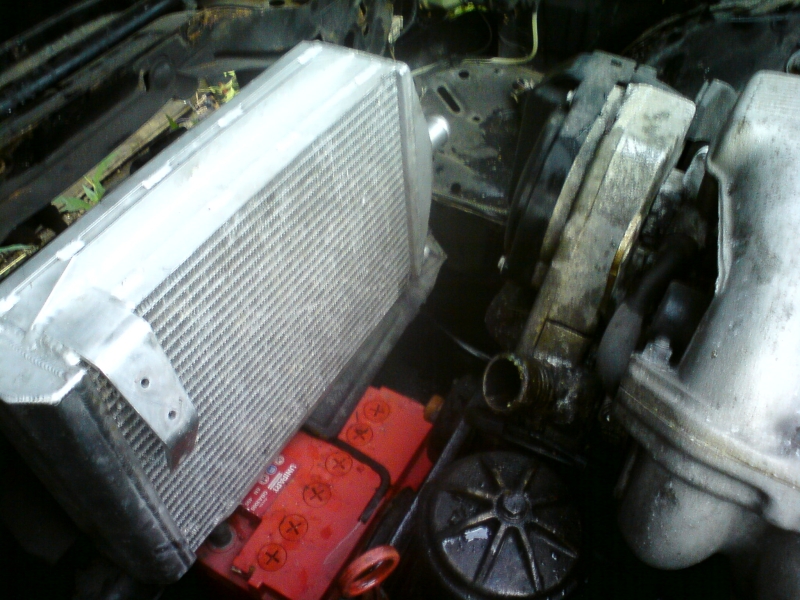

                        thanks to some nice TS members helping out by buying some of stuff i have kicking around doing nothing im a little over halfway to having the dosh to get a new steel crank from fardon, my minds made up im going for a longer stroke, cant yet decide whether to go for 91 or 91.6mm, theres only about 30cc difference in engine size between the two the bigger one giving me 2597cc, but the longer one means i will have to machine a bit off the top of my pistons, but 30cc is still 30cc @100 bhp per lire thats 3bhp
                        the only other thing i've done is to buy a radiator off yodi, its an areoplane one, quite small as its double cored, its for the new shell, im hoping as well as it cooling well enough, that i can mount it behind the slam panel and still have room for the dry sump tank, my current rad is further forward, meaning slightly better weight distribution plus will be less vulnerable to damage.
                        on the face of it it will fit nicely with some adaptations to the plumbing, although i cant be sure without the drysump tank to hand and also the engine in this car is an m40 not the m10 i use
