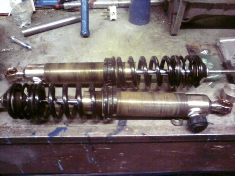

          i sent my rear shock off to gaz for them to be revalved to suit the much stiffer rear springs i now use
          we also added some helper springs, which will preload the shocks a bit and hopefullly aid traction out the tighter corners where body roll which although minimal removes all load from the inside wheel.

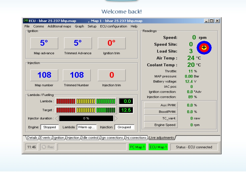

                plugging the laptop in this morning has given me the answer, the throttle pot is playing up,
                idle is site 0 full throttle is load site 15, if you hold the throttle full open the site number jumps up and down all over the place, this obviously directly relates to the amount of fuel injected, new throttle pot and a spare! are now on order
                when i took the screen shot the throttle was wide open as you can see its says site 3 its should of said 15!
